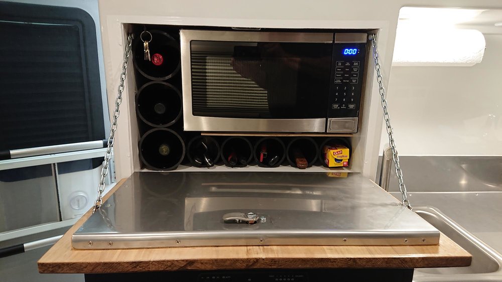

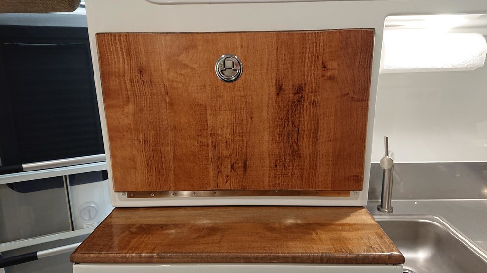

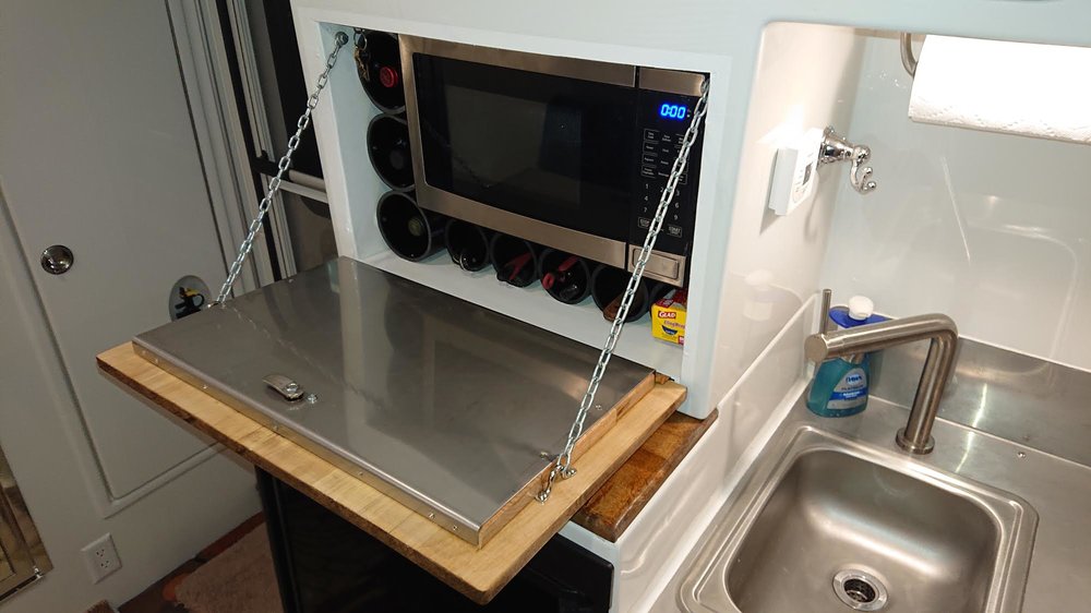

The latest modification is to the microwave cabinet.
Our microwave tried to "escape" twice from it's cabinet and broke itself in the process.  I decided I could do better and get more use from that area.  So I installed a smaller one, that will still accept a full dinner plate, and I was able to fit in a wine rack, utensil storage tubes for the kitchen knives and things, and a couple of key hooks.  We also gained a work surface which becomes extra counter space for preparing food or for a dish drainer.
The latch was modified from a pantry latch and will not open while traveling.   When closed we have a nice piece of furniture to look at that matches the rest of the tops we have, instead of looking at the old microwave.  Since the microwave is now in the cabinet, it's door cannot open,  so it is good for storing bread, towels, cereal boxes and things like that.
It's very easy to pop open the cabinet, grab the bread, and build a sandwich on the new work surface/door with stuff from the fridge below.   Or get things out of the fridge while someone is working at the sink and have a place to put them.

Raspy, that looks really nice. Love the drop down door, and your stainless door interior.
How did you fasten the new microwave? Are the storage tubes lengths of pvc pipe? How are thectubes fastened?
Congratulations on your solution. Looks awesome.
Sherry
John, that’s a great job.  We must have the same microwave you had.  I’m putting this on my to-do list.  I won’t have to carry wine bottles in the truck!  Mike
Sherry,
The microwave is screwed to the rear of the cabinet.  The rear of the microwave is a single layer of thin steel, so I just drilled three holes back there and ran three screws into the wood wall from inside the oven box.   The surround is a plywood box as built from Oliver, except it was rough cut and unfinished.  Side to side I shimmed the microwave up to press into place between the pipes and the right side wall. So, it is pressed in and screwed in place.
The (3) vertical stacked, wine rack tubes are 4" ABS and the (5) lower tubes are 3" ABS.  They fit perfectly with zero play.  A few #6 flathead stainless screws into the side wall and floor convinced them to stay there.  I slightly modified the rear cord minder on the micro and set it on a 1/4" piece of plywood so the tubes supported its feet.  It's set up high in the box so that it's door clears the drop down door with enough clearance to pass over a plate that is ready to go in.
The rough cabinet, as it came from Oliver, was not designed to be seen, or support a piano hinge and latch, so it took some work to clean it up, tie the fiberglass to the plywood edges and cosmetically fix the rough cuts.  The catch Oliver uses on the closet and pantry doors is a very nice piece and I was able to get them to send me one.  But I had to make the strike plate and the arm that swings up to catch it, as well as make a few other little adjustments to it.
Inside there is no extra room.  The catch clears the micro by 1/8" and the micro door clears the strike plate by about a 1/16".  The chains fall into spaces on each side of the drop down door that trap them to prevent swinging around underway. The latch mechanism is contained inside a hollow cavity in the door that allow it to be taken apart, but not seen.  The door is stiffened up with strips of 3/4" X 4" oak and everything is varnished to prevent warping from moisture.  Everything  went in and fit around everything else, but it is tight.  Also, the new microwave is a 700 watt model (vs about 1,000 for the original), to run easily on a small generator or small inverter.
It's great not having the kitchen knives, spatulas, tongs and barbeque lighter in the kitchen drawers.  Plus three wine bottles are handy and lying down, instead of trying to contain them in the closet, or something.  Since they are in close fitting ABS tubes, they can never break.  Even the extra keys have found a place where they can't escape.

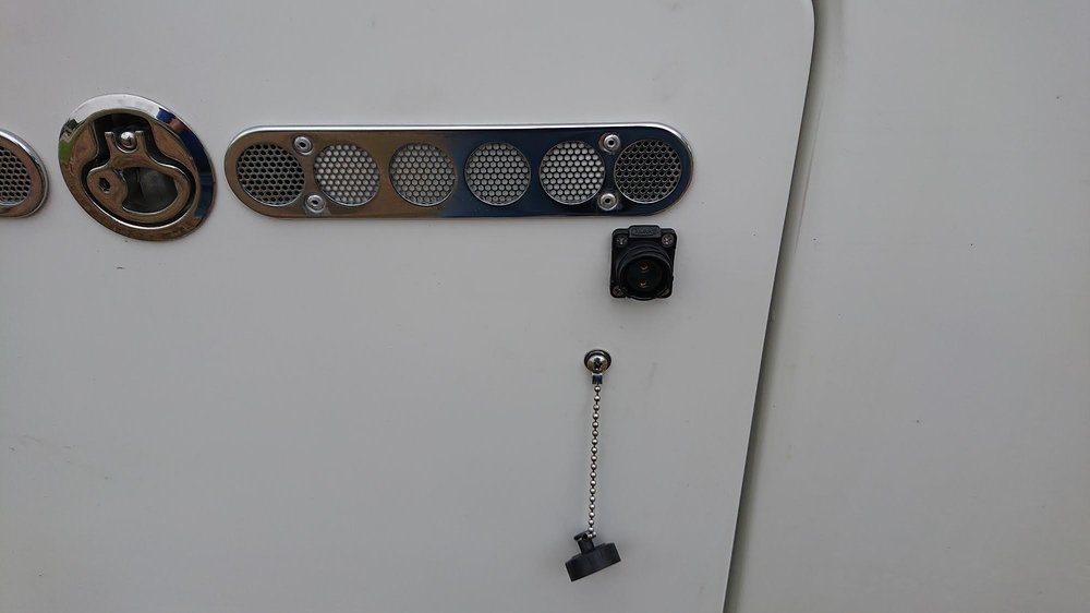

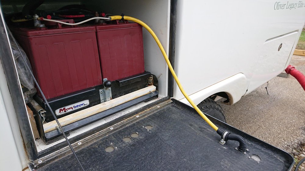

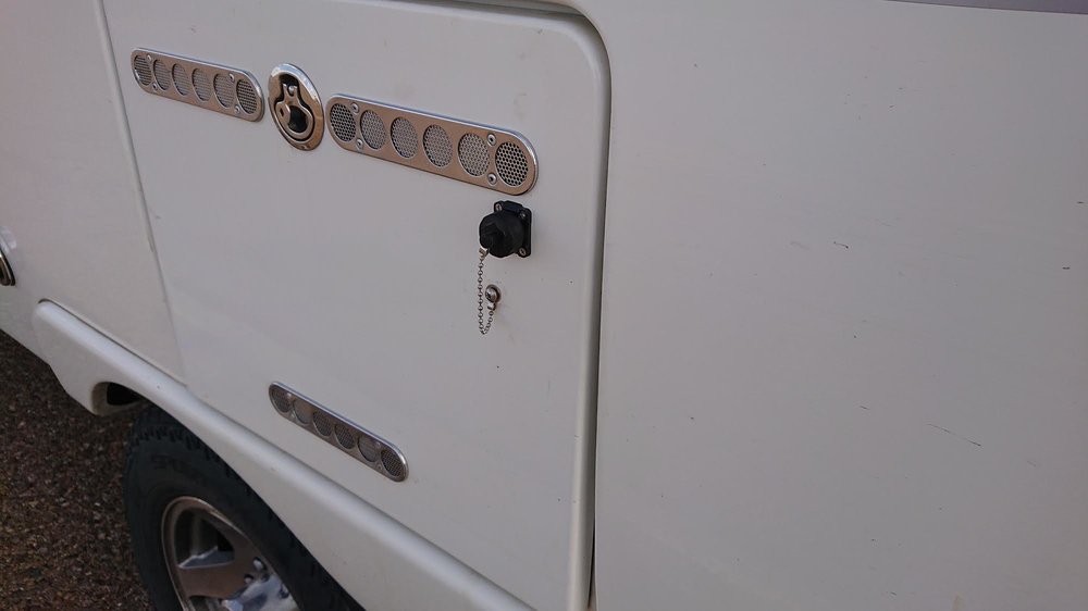

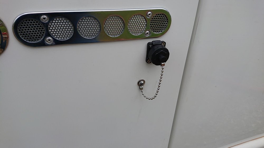

Here is the exterior plug installation for the suitcase solar.
A very nice little 12 volt/20 amp plug, with cover and twist-lock plug that will not fall out or allow the connections to get wet in the rain.
https://www.amazon.com/CNLINKO-Industrial-Connector-Receptacles-Waterproof/dp/B0795464LP/ref=pd_ybh_a_26?_encoding=UTF8&psc=1&refRID=9EBPJGFS22DYCSBDBBGV
I cut a #12 exterior cord to 20' to use for the solar cord.  This allows the collectors to be set facing wherever the sun is.   The interior cord is connected directly to the batteries.  This is a very simple setup that only requires a 7/8" hole. The cord folds away as the door closes.
John

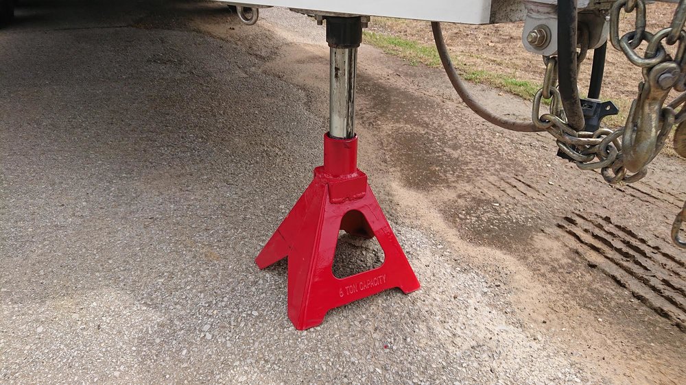

Next is the jack stand modification. I started with three jack stands. I threw away the adjustable center pieces and cut off the ratchets.  They are very strong and stable. Much better than stacking a pile of blocks.
This is an update to the jack stand modification.   I could not edit the earlier post, so I quoted it and added the pictures.
These modified stands have worked beautifully.  They are very stable, strong, easy to use and they stack for travel.  Each one is rated for 6 tons.
I modified them by welding on a piece of 3" channel and a piece of 2" pipe, after cutting off the original top ratchet part.
