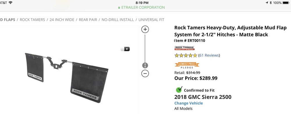

Herm, we do spend some time on gravel roads, so Paul got Rock Tamers from Costco (you don't have to be a member to order them online... best price we found... around $180 if I remember correctly). They are removeable, so you can take them off when you aren't towing, or aren't planning to be on gravel. Similar to the Road Wings on Mountainborn's jeep. We have smaller mudflaps permanently mounted on all four wheelwells of the truck, and little mudflaps on the Oliver too.

Thanks for the Rock Tamer recommendation, Sherry. I don't expect to travel on any gravel roads, but you never know where you find yourself sometimes...better safe than sorry, I guess. Also, I never even considered mudflaps for the Oliver..I bet that keeps the undercarriage a little cleaner.
The Rock Tamers seem to get very favorable reviews, and I see that Cabela's sells them for about $190 (if anyone else in interested). Assuming they're not too wide for my TV, I'll probably be ordering a set in the near future.

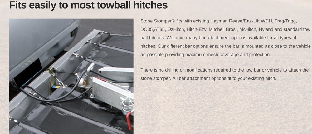

Isolate all the carnage underneath the trailer: add mudflaps and frame protection on the trailer and a Stone Stomper up front. Works great on the worst surfaces except sticky mud or freezing rain, which will overload the fabric.
I am Door Number Three, but I tow on gravel frequently and do not want to worry about a three hour trip on loose ranch roads.
How fancy do,you want to get, are you prepared to spend some cash, can you do the fabrication yourself, can you live with a constant minor PITA to stop almost all the damage? If you aren’t really anal like me, then the third option is probably overkill.
http://olivertraveltrailers.com/topic/how-to-stone-stomper-gravel-guard/
http://olivertraveltrailers.com/topic/how-to-rear-mud-flaps-for-the-ollie/
I was told by the Stone Stomper owner that other folks here in the USA have ordered them, but I sure haven’t seen a pic or mention of it anywhere. If you go this route you will be a member of a very small club.... After about 6000 miles of use I think the SS is the absolute best protection you can get. I won’t leave home without it.

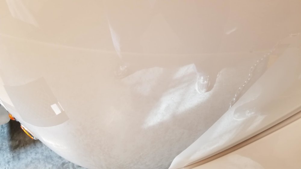

If your just worried about rock chips and road rash we added automotive paint protection film. We have traveled over 10,000 miles so far with it and have no chips and it has held up great. It applies like window film and I forget it's even on the trailer. We also added mud flaps to our 2500 HD.
