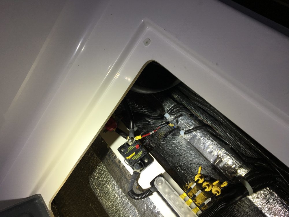

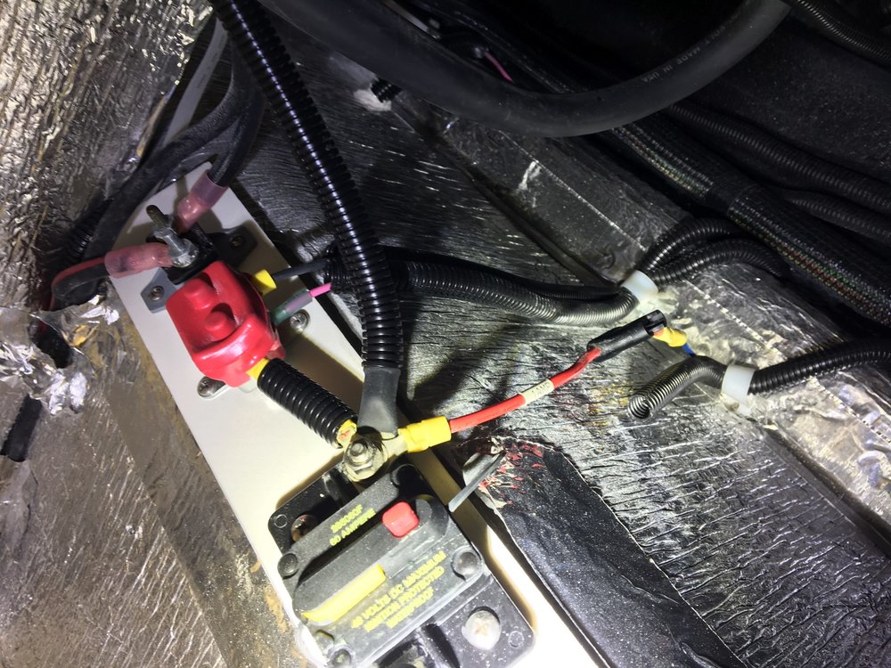

I can't find the inline fuse. I'd really appreciate it if someone would post some photos of the fuse and its location. I found the two 12v breakers under the bed on the driver's side. Jason said it's an inline fuse wired to the right of one of those breakers, but I can't find it. :(

I found mine in a different location after receiving this info from Jason a few minutes ago: "Hey Don,
Your model may have the inline fuse under the dinette access panel and be located near the LP alarm itself."

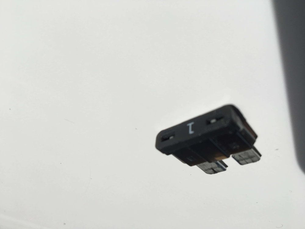

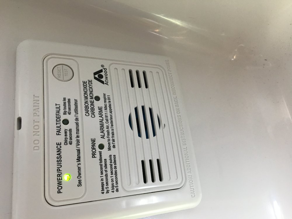

Hi everyone ~  Thanks so much for your feedback.  Sorry I haven't replied earlier.  I had checked the box that asked if I wanted to be notified of replies, but didn't receive any until Don's yesterday.  We determined that the problem was with the campground, not our detector.  We haven't had any trouble since. Happy to know about the fuses.  Which fuse would it be? (photo attached).  We bought our Oliver in 2016 – Hull #125.

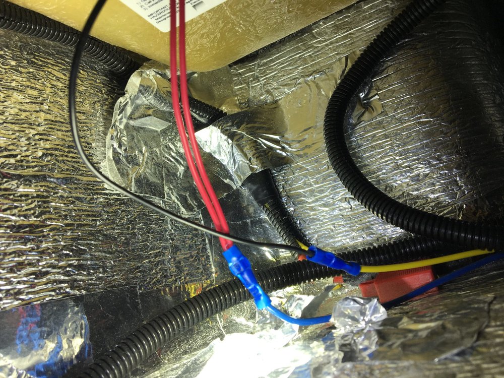

Mine a 2018 so it may be different. Wires from detector are 2 red and 1 back. Under the aft seat of the side dinette: The 2 red are butt spliced to Blue, The black is spliced to Yellow. All this is under the looming and not readily visible. These wires run into the “rats nest” ? I suspect the yellow runs to the nearby buss bar for grounds (1/2 dozen or so yellows attached). Under the aft port side dinette seat: the blue wire is spliced to the 1-amp blade fuse holder. This is just forward if the 3 jack fuses. - Randy
