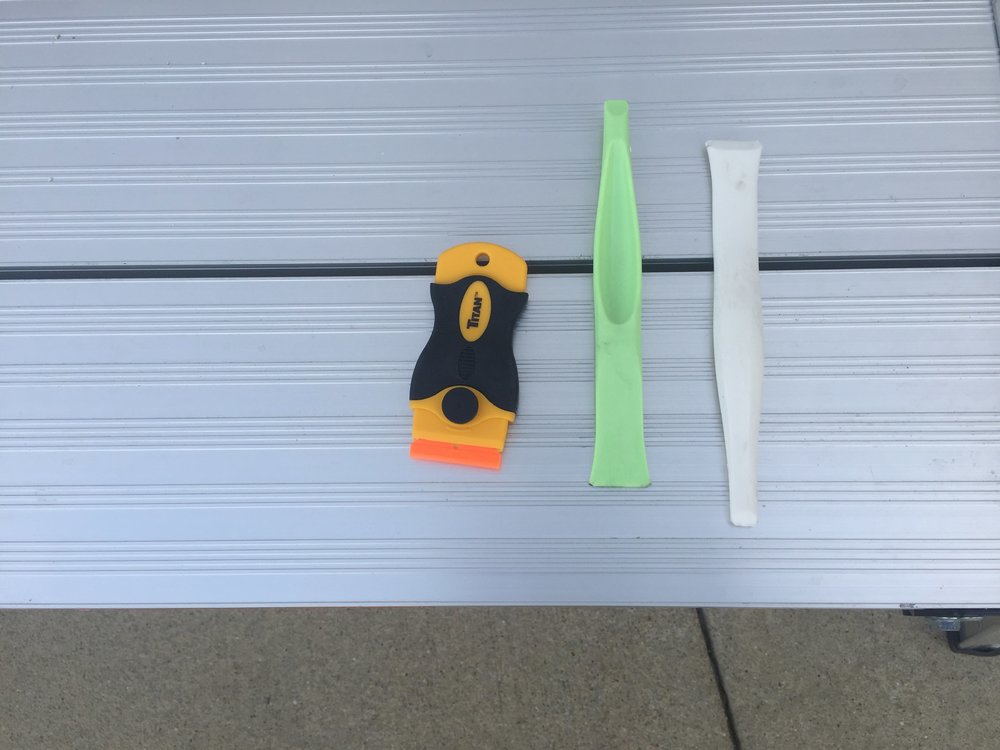

I've got everything now prepared for tomorrow. I thought I would prep first before caulking so the sealant does not dry up on me. Love those plastic scrapping tools my wife got me.

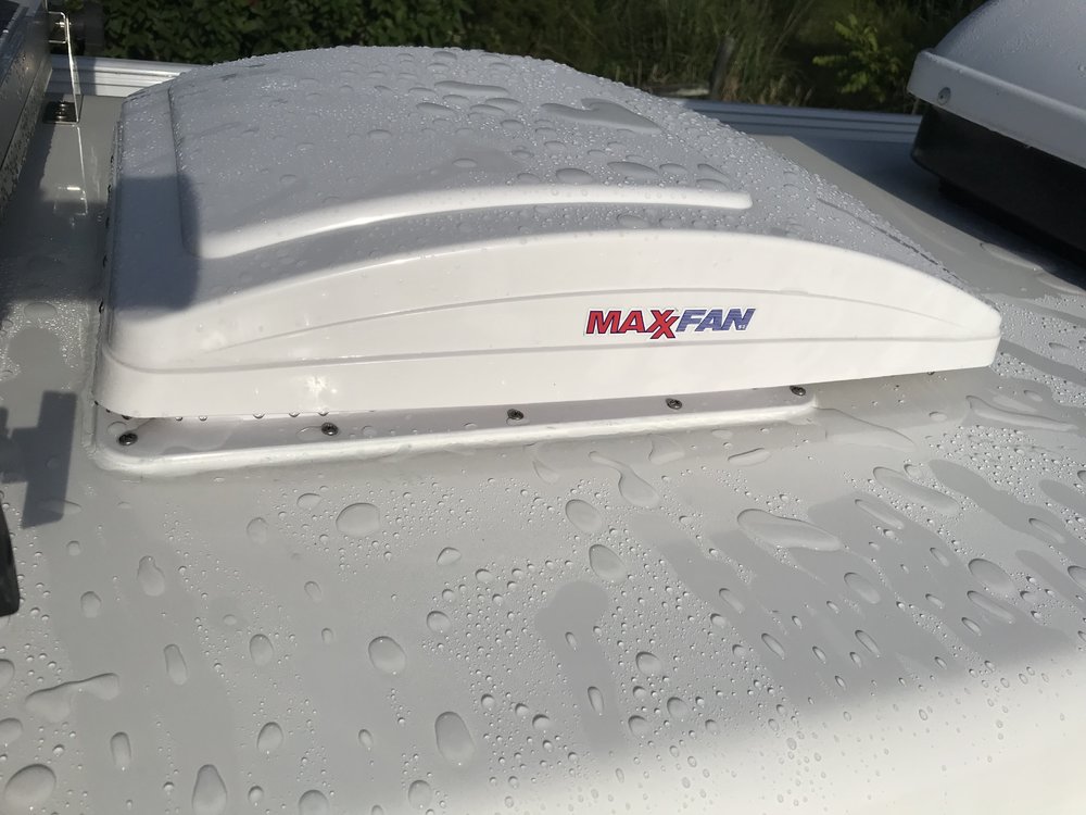

Up on the Roof....

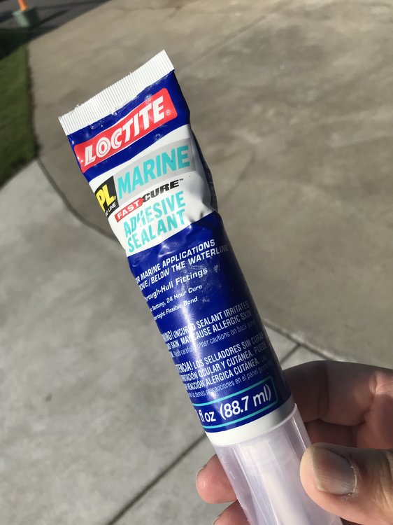

Spend the last few days up on the roof of #145 waxing and checking seals.   Found that the MaxxAir fan seals were cracked and worn.  Removed the old and applied new sealant.  I used Loctite PL Marine Adhesive Sealant.   It was a bit expensive..... about $9 for this small tube.  But went on very easy, dried quick and appears to be a tough, durable seal.  Pics attached.... Be careful up there.
Scotty
