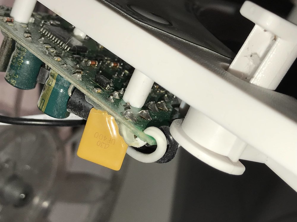

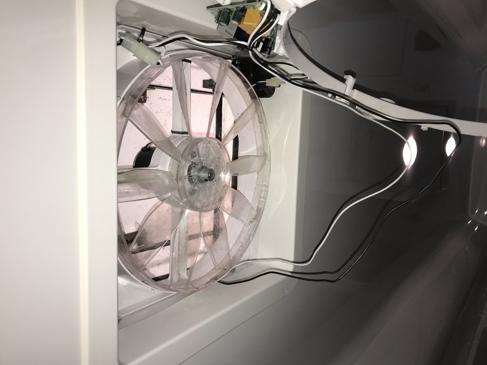

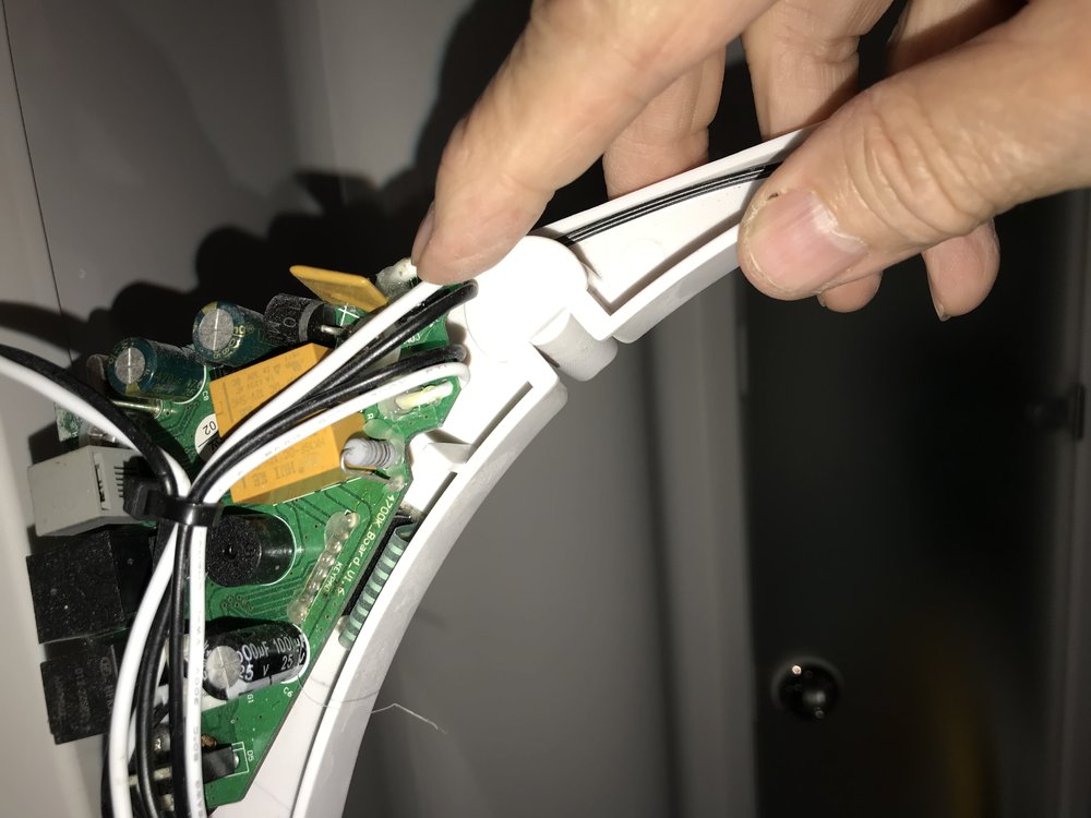

My hull number is 246.  I am familiar with the wiring behind the Furrion. I did look there again and don’t see any wires that look like they go to the fan.  BUT, I check again today at the fan circuit board and did read 14 volts power.  So this negates my earlier post of no power to the fan.  Had to make contact on the back side of board.  A little difficult so maybe I didn’t have good contact before.  Anyway,  That leaves the circuit board on the MaxxFan I suppose.  I will try to post a picture.

Yep - unfortunately this is not the first board on that fan that I've heard of biting the dust.  I'd be willing to bet that you are out of warranty too.  But, I'd give the company a call to see if they would be willing to help you.
My board had to be replaced also - Oliver just sent me a new one and I replaced it myself.  It would be worth a call to service just to see.

Follow up.  I called MaxxFan and their tech support would only talk to dealers not consumers.  So I called Oliver and talked to Jason detailing all.  He said not that common but when they have had a problem with the fan, it was the board.  He mailed me a new one yesterday and I will be returning the old one under warranty.  Will follow up one last time once replaced with hopefully fan working again.  Thanks for all the responses.
