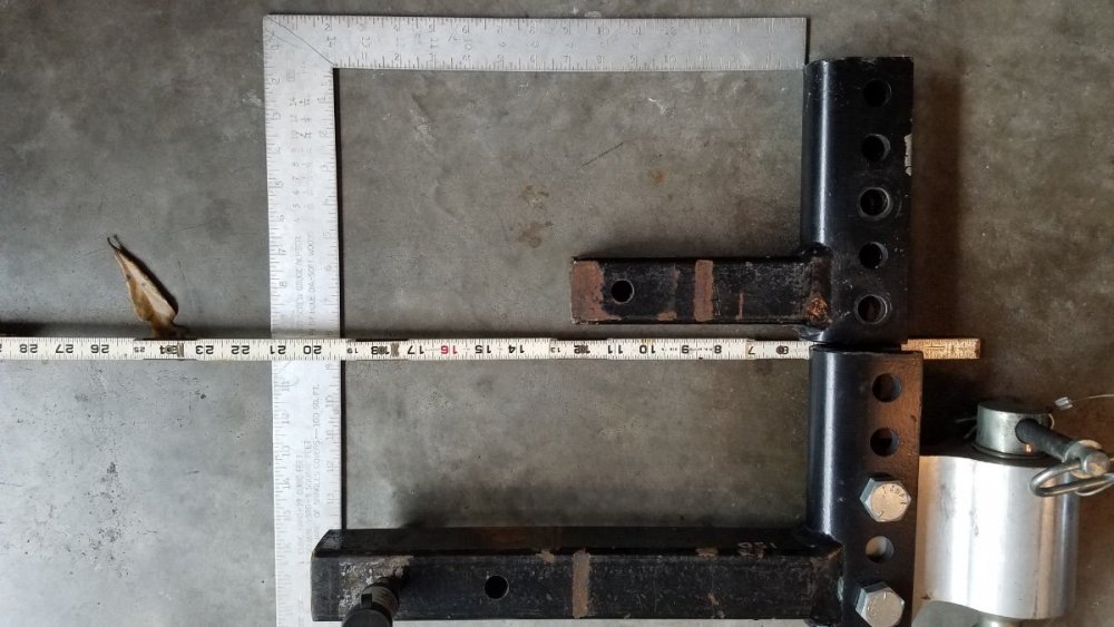

For our Elite II scheduled for delivery summer 2022, I also would like to have a longer tongue, or, alternatively, a longer drawbar adding at least another 3" between the hitch receiver and the trailer ball.  So, I called Andersen today to inquire whether they will custom fabricate a longer drawbar for their weight distribution hitches, like the one they used to offer.  Answer:  NO.
The person I spoke with confirmed that Andersen used to offer a longer drawbar, but not any more, because it was determined that it reduced the GTW rating "too much."
I noted that the drawbar that is included with the #3350 WD hitch I plan to purchase includes two hitch-pin holes, one about 1.5" inboard of the other.  See photo below.  I asked the Andersen rep if it was o.k. to use the inner hole to increase the receiver-hitch ball distance by that 1.5".  I was told that is fine, and is indeed the reason there are two holes, but that Andersen is not comfortable making or selling a drawbar that is any longer, or has any more holes.  3350.jpgSo, if I don't like the TV rear bumper-to-Elite II A-frame distance once I pick up the trailer, I may be paying for custom modification of the Andersen stock drawbar, with the reinforcing gussets John Davies suggests, to ensure an ample GTW rating.
Hull #1291
Central Idaho
2022 Elite II
This picture is for reference purposes only.  Both drawbars are Andersen products.
