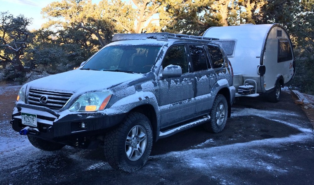

I am not ready to upgrade tow vehicle, which limits me to an Oliver Elite or similar weighted trailers.  The Elite II is just a little to heavy for the GX470, which has a towing capacity of 6500#.   I did a suspension swap on the GX470 that includes :
(...for the gearheads)
32" tires,
2.5" lift with factory airbag delete
Dobinsons suspension with HD suspension front; rear with HD shocks and medium progressive coils.
Airlift 1000 airbags.
My wife and I currently tow a 2015 T@B Outback (see photo below).  Routine outings typically include 1) driving over 1 to 2 mountains passes of 10,000ft within the first hour of leaving our home and 2) traveling on 20+ miles of washboard roads on some of our outings (we looked at offroad teardrops before buying the T@B but liked the inside kitchen of the T@B).  Encountering freezing temperatures is not uncommon.  My wife and I typically limit our towing to maintained forest service roads and getting into tight little camp spots that is perfect for the T@B.  We tend to travel light and can boondock with our 140W solar and a 20lb propane for 3+ weeks.

Nice Lexus, I really like them. I actually test drove one a month ago, considering it for my daughter.
You need to factor in your larger tires and added equipment, like that heavy front bumper and winch, when figuring tow capacity and payload. What axle ratio do you have? What diameter were the factory tires? What is the specified max tongue weight?
The Elite is a cool little trailer, but it is heavy for its size. I suspect that your truck would be fine but some of those high back country passes will definitely have you wishing for more power. The 4.7 liter V8 is not a powerhouse... We hear from buyers who want to tow with marginal existing vehicles and all too often they just don’t have enough reserve capacity for really harsh conditions (hot, high and windy). If you didn’t have to tackle those passes, I would not hesitate to recommend what you propose. But in reality I think you would be much better off with either a lighter load or a bigger TV like a Land Cruiser 200. My 2013 200 struggles with the Elite II on those steep grades, but it would pull the smaller trailer without worries.... my truck is stock except for 33” LT tires (+ 2”). Plus the 200 is one of the few vehicles that lets you safely tow in 4 Low on pavement, which is really handy at altitude.

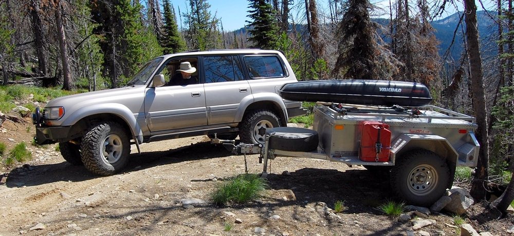

John: try towing with an FZJ80. 3″ inch lift. armor all-around…very painful when diesel trucks are passing you up the grade. That is why I bought the GX470 with the V8 for the T@B. If you are looking for a GX470 check out the GXOR forum on Facebook. Or the ih8mud 120 group: https://forum.ih8mud.com/forums/120-series-toyotas.207/. I am source3 on ih8mud. Ih8mud also has a great classified section.
Been there, done that. I used to hang out there constantly, but since I got the 200 and it is so close to stock .... not so much. My son totaled this truck a couple of years ago, but he was unhurt. The LX450 saved him. What a great truck, as you pointed out, it just needed a decent motor for towing...
Getting turned around on a side road along the Magruder Corridor Road,  Idaho Panhandle, when the double track turned into an ATV trail. You can’t do that with either Ollie:
After owning my 200 for a couple of years, I have zero regrets and would never go back.
