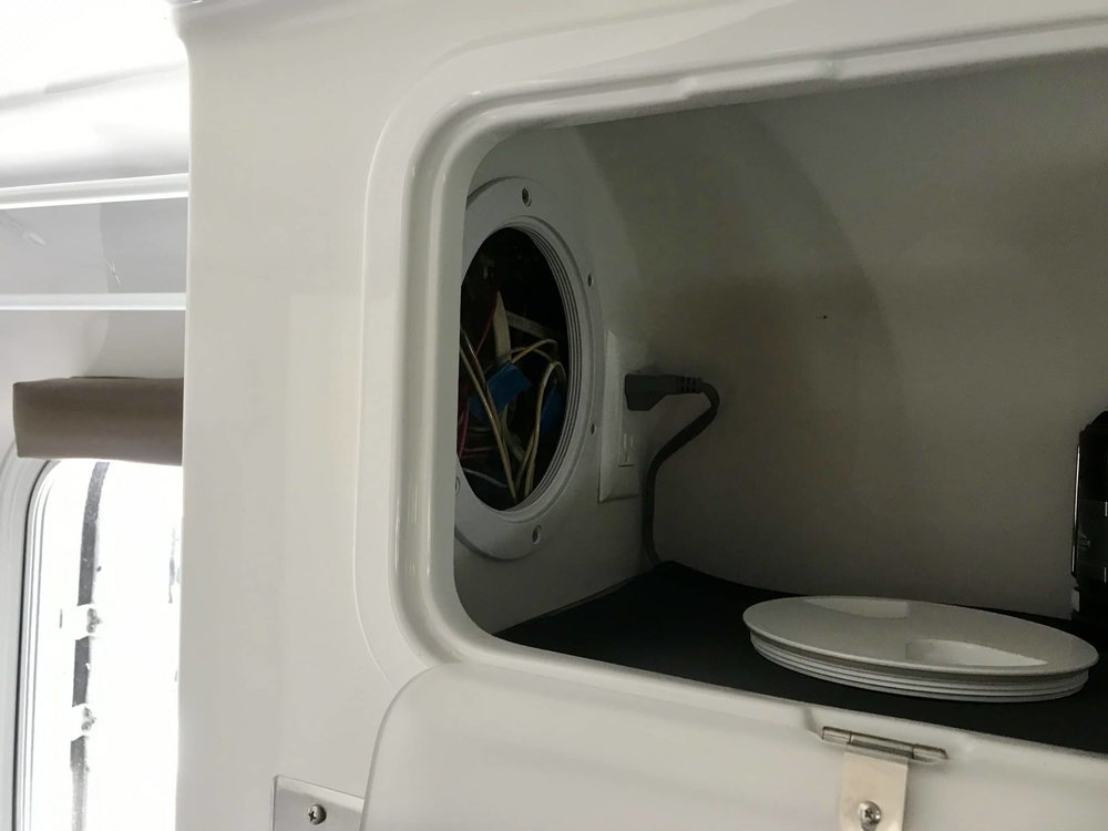

Open the access port in the upper cabinet above the microwave and find the main and courtesy light switches.  Pull the wire connector off of the switch post and push it back on making sure you have a good connection.  Do this 1 wire at a time.  Do this for both wires on each switch.
Now test you work.

We had a similar issue while at the 2018 Oliver Owner's Rally. Jason's guys accessed the connection to the switch at the door and tightened the connection for us. Since they were so nice to show how to access and what to do if it happens again, we now know what to do if we incur the issue again. The access point was just inside left of the upper cabinet next to the door.
