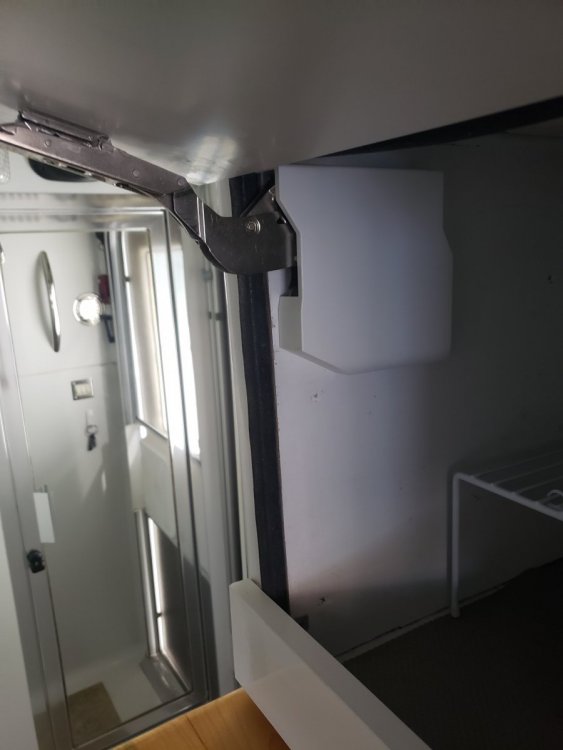

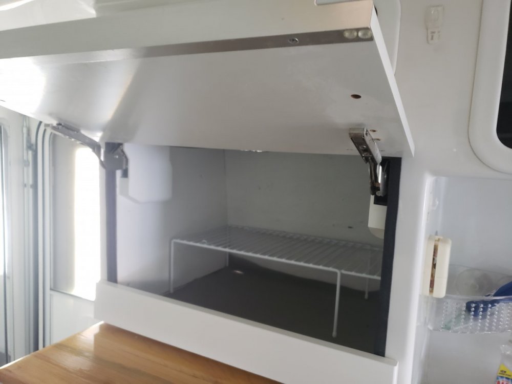

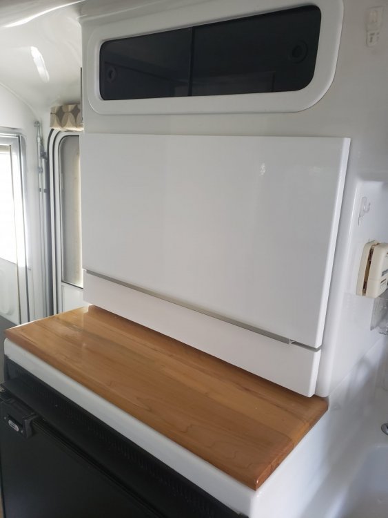

When we took out our microwave,  we built a new cabinet in the space. We used a couple high gloss  white Ikea drawer fronts, and their hinges, and our added blocks. I love the upward opening door. Just like my home cabinets, the door swings up, stays put til I'm done, and closes easily on the Blum for Ikea hinges. You might want to look at that idea. But the sliders would likely be a lot easier,  and less expensive. Imo.

@SeaDawg Any chance I could see a picture of your microwave cabinet with the Ikea doors and blum hinges? I'd love a visual. I think I know what your talking about. I have assembled quite a few Ikea kitchens... I don't have microwave either and wasn't quite sure what to do with the door, great idea!
Here you go, Josiah.
We cut down the bottom drawer front. Raw edge ( painted) is on the bottom, factory edge up. This ledge could be made to drop down, but I  like it the way it is. So, it's fastened in with a couple screws.
The Ikea high gloss white is fairly close in color to the Oliver gelcoat. I used the Ikea hinges, could have used Blum minis, and the Ikea Blankett cabinet handle.
Btw, didn't " build a box" for the microwave compartment.  I painted the fiberglass and plywood sides that we added, and covered the bottom with Ikea shelf liner. That's a 6 or 7 dollar walmart wire shelf that helps keep my cabinet organized.

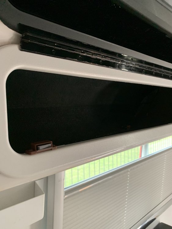

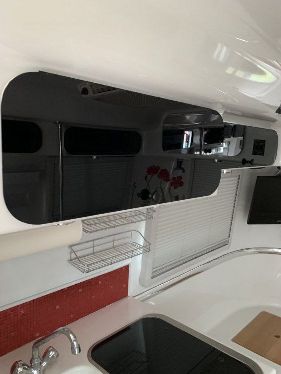

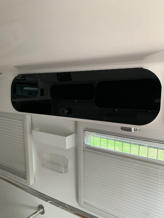

iron Horse RV in San Antonio made plexiglass doors.  Attached the top hidden piano hinge with 3M tape and out super strong magnet catches at the bottom.  We debated if the hinge should be at the top or bottom.  Went with top. Figured it would be more secure while towing
