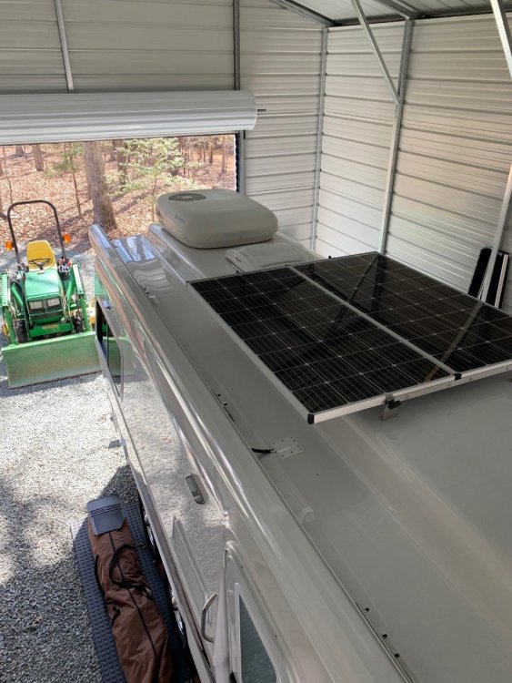

Moderators SeaDawg Posted March 8, 2021 Moderators Share Posted March 8, 2021 (edited) A few notes on our install of the smaller 9500 unit: We had another motive for changing out the ac, besides age and noise. The size of the Dometic 600 interfered with fully adjusting our two sidemounted 200 watt solar panels. We picked up several inches of gap with the new smaller ac unit. The old Dometic 600 was a well built, heavy unit, that lasted a long time. The new unit, though well built, has a lot more plastic, so we'll see if we get the same longevity. I'm also going to have to buy or sew a cover, as the outdoor unit has a huge rooftop grilled opening over the fan that will offer an open door to mud daubers, dirt, and leaves. The new unit has the convenience of a remote, but the remote is the only way to fully operate the small unit. So, I will be taking very good care of that remote. (Edit to add: limited function is available through a tiny touch screen in the bottom of the plenum. Ac will run at 24 or 22 c, fan on high.) The indoor distribution box is made of a glossy, lighter weight plastic. It's very slim and sleek, and we gained about an inch of headroom vs our old unit, but it's very light. It also just barely leaves room in the trolley part of the roof to easily remove the washable filters on each side. I'm not sure the larger unit like Katanapilot's would work in the smaller Elite. The install went very smoothly because the pieces are well thought out by the manufacturer. If you get the first indoor piece right, the rest falls into place. I wouldn't necessarily recommend our 3 person/two ladders/rope safety install without a lift, unless you have a sure-footed, strong young friend like ours, who volunteered to do the rooftop part of the job. He noted that our roof is very well waxed, and it would have been pretty easy to slip. (And, he's used to working on fiberglass boats.) You definitely want two, or better, three people, though, to make it an easier job, even with a lift. It's a very precise fit, and one on the roof, one inside, at least saves time and aggravation. We used a foam gasket, instead of silicone sealant to install the top plate. This method had served us well for the last ac. If it doesn't work out, removing it and replacing with butyl or silicon will not be that difficult. Edited March 9, 2021 by SeaDawg 2 2008 Ram 1500 4 × 4 2008 Oliver Elite, Hull #12 Florida and Western North Carolina, or wherever the truck goes.... 400 watts solar. DC compressor fridge. No inverter. 2 x 105 ah agm batteries . Life is good. Link to comment Share on other sites More sharing options...

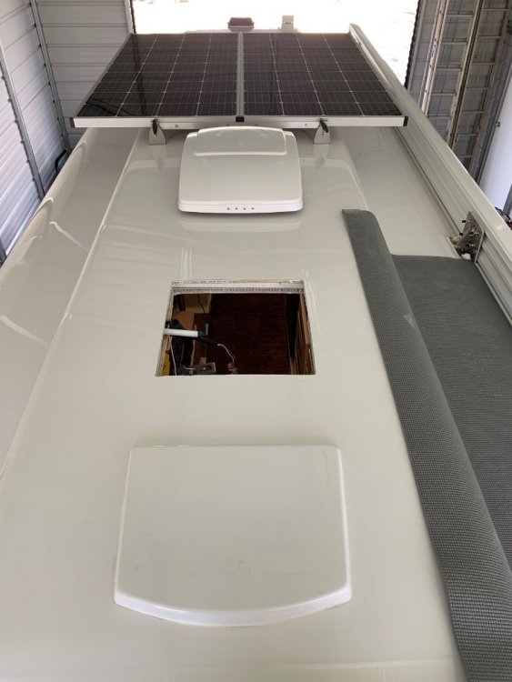

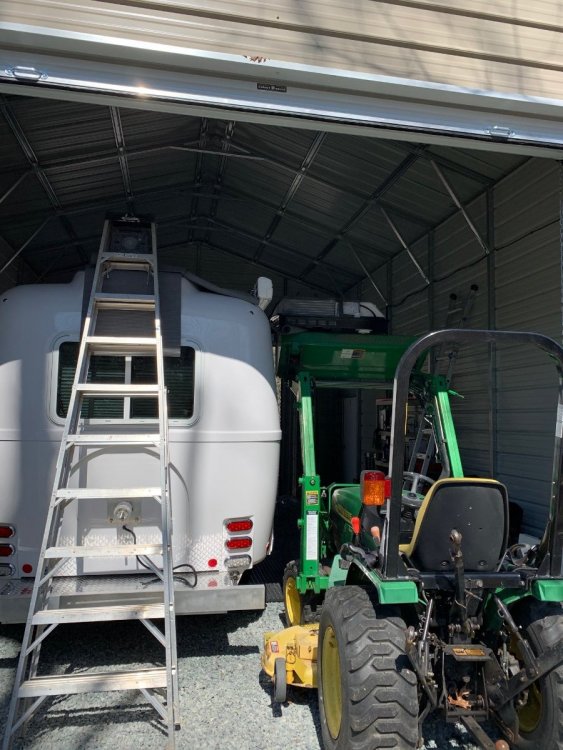

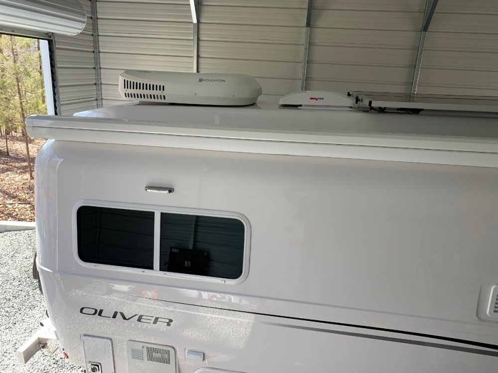

NCeagle Posted March 9, 2021 Share Posted March 9, 2021 (edited) Another Dometic "power lawnmower" AC bites the dust... Created a temporary skylight. What a nice, sturdy, double fiberglass hull with PVC board in between for strength! And a few pics of the outside of the unit since the first two pioneers (katanapilot and seadog) included different parts... All in all, it took me ~3.5 hours. I had two helpers to remove the old unit and put the new one on the roof: John Deere and my son. I ended up using Butyl tape on the outside frame because I had some high quality stuff on hand, I'm familiar with it and that's what OTT had used on the Dometic Penguin II I removed. Now only time will tell how these things perform and last. Some of my notes / observations so far to add to what has already been observed: 1. It's a lot quieter. I only measured sound at the bed where our heads are with high fan and compressor (about 5' away). With the Dometic it was ~80 dB (as loud as a power lawnmower) and with the Houghton it's ~60 dB (as loud as a normal conversation). Definitely will be able to sleep better. 2. AC and Heat Pump both work on either batteries (Lithium) or the Honda 2200 generator without the EasyStart. On battery power through the inverter, it ran smooth / fantastic. However, with the generator there were a few hiccups as the compressor didn't start a few times and the surge protector (I think) made some "strange" clanging sounds. A 2200 generator alone may be borderline and may need either the EasyStart (if possible) or a pair of generators to be safe. 3. Fan alone takes 1 Amp on 120V and 8 amps on 12V. Fan plus AC compressor takes 9 amps on 120V and 90 amps on 12V. Fan plus heat pump takes 13 amps on 120v and 130 amps on 12V. I think I'll still be carrying my small Vortex space heater in the winter, but it's nice to have another all electric option when power is available. 4. The exterior cover is nice, but it's not pure white like the Ollie or the MaxAir fan. It's a bit of an "off white" I think. 5. The AC compressor and the heatpump both cycled about every 7 minutes. I think that's expected since the thermostat is in the unit itself and there's not a lot of air circulation up in the back of the Ollie ceiling. An additional fan may help. 6. It's 3.5" shallower than the Dometic on the outside. Thanks again to katanapilot for researching and finding this alternative and to both seadog and katanapilot for sharing some additional tidbits that helped make my installation painless! Now I will try to sell my old unit to subsidize this upgrade so we can afford diesel for the next camping trip. 😬 Edited March 9, 2021 by NCeagle 5 2 2020 Elite II, Hull 688 --- 2021 Silverado 2500HD, 6.6L Duramax Diesel Link to comment Share on other sites More sharing options...
Moderators SeaDawg Posted March 9, 2021 Moderators Share Posted March 9, 2021 That looks great, John. I'm glad you decided on the butyl. Now, we have three methods to compare. 1 2008 Ram 1500 4 × 4 2008 Oliver Elite, Hull #12 Florida and Western North Carolina, or wherever the truck goes.... 400 watts solar. DC compressor fridge. No inverter. 2 x 105 ah agm batteries . Life is good. Link to comment Share on other sites More sharing options...

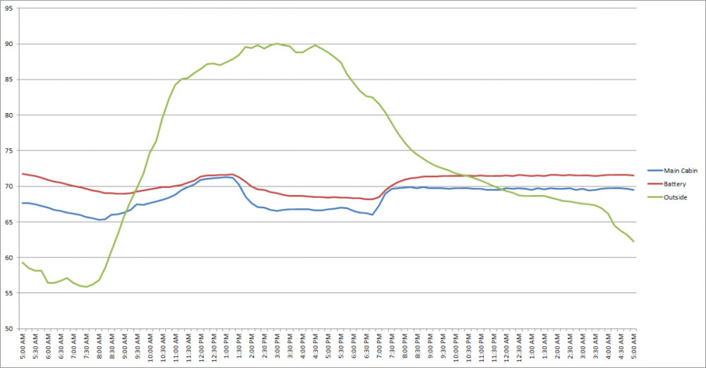

NCeagle Posted April 8, 2021 Share Posted April 8, 2021 UPDATE: Some initial findings / observations on the cooling capability of the Houghton unit. I have been testing a new ventilation system for my battery compartment and part of that testing involved heavy use of the Houghton AC. It cools the Ollie great in my opinion, although I ripped out the super loud Dometic before I had a baseline to compare to. Here's some data that shows the outside temp (near 90F) and the AC cooled inside temp. The trailer is in my metal garage, so shaded heat... I had the Houghton set at 68F initially, which keeps the cabin at 72F (cabin is always ~4F warmer than setting). At 1:00 PM, when things outside were really heating up, I turned the Houghton down to 60F (the minimum cool setting) and it was able to bring the Ollie cabin down to 67F and hold it there. I think the differential of ~23F cooler in the cabin is admirable. At 7:00PM I set the Houghton temp to 66F and it held the temp steady at 70F. The unit does cycle a lot just like the Dometic did - I think that's the way these units work and may also be related to the location of the AC within the Ollie - towards the rear right next to the MaxxAir fan is not ideal according to installation instructions. On another note, I'm not very happy with the Butyl I used to seal the unit to the roof. I checked the bolts and they were VERY loose from settling in the heat, so I tightened them up and a bunch of brutal Butyl oozed out. I'm worried I may have overtightened now and have to water test again. If this continues, I have the foam gasket @SeaDawgused ready to install. I played around with the heat as well and while it works I think of it as a backup to the propane furnace. I tried the dehumidification setting as well but couldn't get a drop of water out of the Oliver with it. Not sure if / how it works yet. 2 1 2020 Elite II, Hull 688 --- 2021 Silverado 2500HD, 6.6L Duramax Diesel Link to comment Share on other sites More sharing options...
Moderators SeaDawg Posted April 8, 2021 Moderators Share Posted April 8, 2021 @NCeagle Thanks for all the data, and the chart. That's all good news, except the cycling. I'll be interested to see if that is the same with my smaller unit that cannot be controlled via a thermostat. I don't know a lot about the Dometic thermostat. Does it have variable setpoints for temperature differential, like some modern home thermostats? Adjusting that can sometimes help with short cycling. Sorry to hear the butyl oozed.. So far, the foam seal we used seems fine. We didn't do an official water test, but mother nature provided us with several tests via heavy rains and wind, and we found no evidence of leaking inside the trailer. We haven't checked the bolts yet. We did have to adjust the bolts on the Dometic early on in 2008 and 2009, and a few other times, as the foam compresses over time, so I suspect we'll have to do that with the Houghton, as well. I haven't had occasion to really use the ac yet, as the weather has been mostly pleasant. When we bring it home next week from the window repair shop, I will probably run it while I finish setting up the interior for camping season. And, check the bolts. Our friend who works in the yacht business told me it's pretty common these days for marine ac systems to have a dehumidifier function. It uses the compressor and evaporator at a different rate, to draw out moisture. Uses less energy than the ac, but increases comfort, like our home whole-house dehumidifier. That's a feature I'm really looking forward to trying out. Our smaller (9500) ac doesn't have a heat function. Thanks again for the info. A 23 degree drawdown is plenty for us. Hope ours achieves the same. The old 13,500 Dometic would freeze us out, and was way oversized for an Elite . 2008 Ram 1500 4 × 4 2008 Oliver Elite, Hull #12 Florida and Western North Carolina, or wherever the truck goes.... 400 watts solar. DC compressor fridge. No inverter. 2 x 105 ah agm batteries . Life is good. Link to comment Share on other sites More sharing options...

NCeagle Posted April 8, 2021 Share Posted April 8, 2021 4 hours ago, SeaDawg said: I don't know a lot about the Dometic thermostat. Does it have variable setpoints for temperature differential, like some modern home thermostats? Adjusting that can sometimes help with short cycling. Hi @SeaDawg, I'm not using the Dometic thermostat for the Houghton - just the remote. The cycling is probably normal because it does it most (every 6 minutes or so) when it's "maintaining" a temperature. If I turn it down to cool the trailer, it cycles much less and cools the trailer down quickly. I trust the thermometers I'm using, but that 67F felt like 55F with the fan on and the AC running. It was too cold and that was good news! I'll have to play around with the dehumidifier function a bit more once the humidity gets bad here in NC. The manual says to set the mode on dehumidify and then set the temperature 1 degree cooler than the room temp. I just noticed when I tried that my sensors humidity didn't move much but it wasn't super humid to start with. I spent the past few hours removing the butyl and putting on the foam seal. I like it better already as I was able to get the bolts correctly torqued and the foam is 1/2 compressed. I did use the spare foam to build support pads in the back and level it off too. Hope this works better. I don't think the butyl was leaking, but it was getting too messy and I thought it would eventually fail. Maybe the way I put the butyl on (too much?) or the weight of the unit pressing down on the butyl in the recent heat made room for too much settling. All I've ever used butyl for before are windows, so this was new to me. Glad we have options. 1 2 2020 Elite II, Hull 688 --- 2021 Silverado 2500HD, 6.6L Duramax Diesel Link to comment Share on other sites More sharing options...
