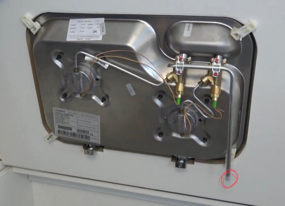

I have not accessed the stove top and the documentation from Dometic is not helpful.  There is an 8mm compression fitting on the bottom of the unit.

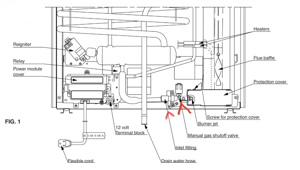

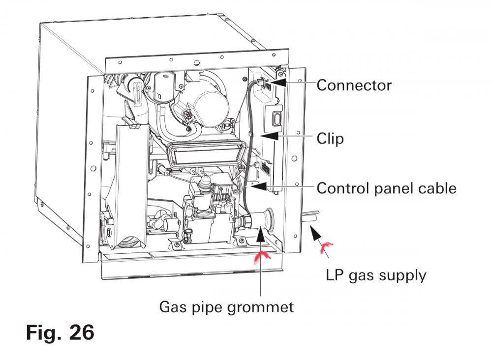

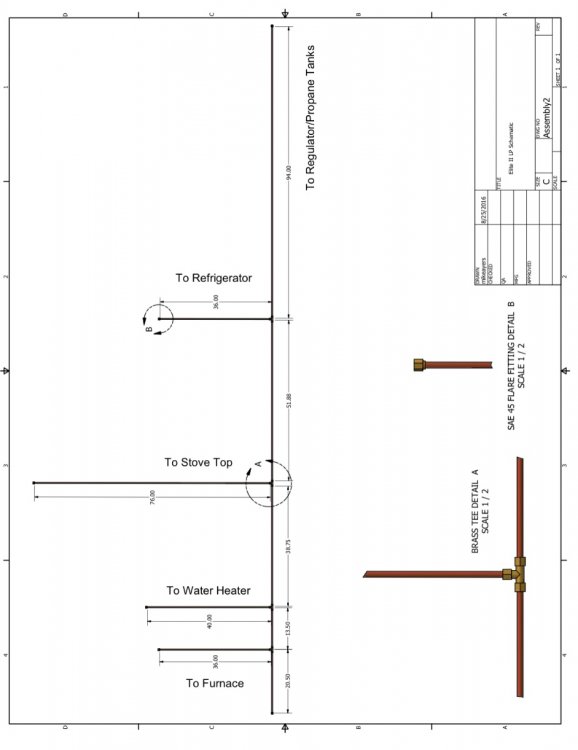

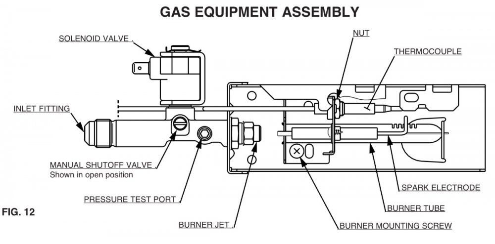

On 12/21/2020 at 11:51 PM, mjrendon said:
Make sure the stove is turned off. If that is not it, then you can start checking the other connections.
Where do people find these diagrams? I looked in my manual and didn't find anything... thank you for posting them.
