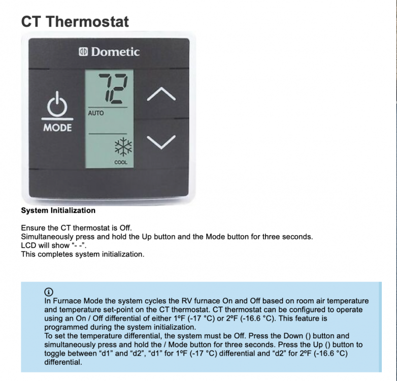

Thanks for the feedback guys. I figured for sure it was the board or the igniter. Like I said the thermostat initiated the furnace and the blower went on. The last thing I thought it would be was the T-stat. Well I did a reset on my T-stat today and the thing fired up I could hear the infighter and the flame. Here's a screenshot of the procedure. Wish I knew why this happened.
Peter
