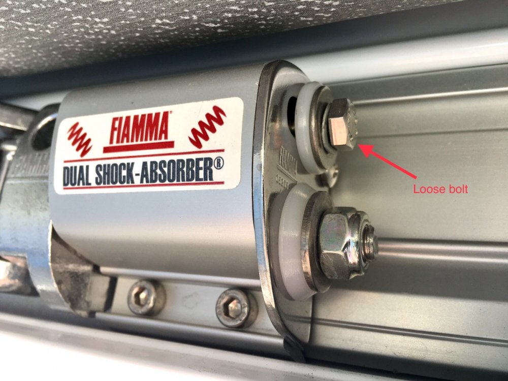

John E Davies Posted April 6, 2021 Share Posted April 6, 2021 (edited) Mine are simple bent pieces of aluminum, the newer ones have extra welded gussets. Maybe because of this? Those are stretch cracks from when the approximately 120 degree bend was made, so far none of the four brackets has a larger crack. It sure looks like a future failure point to me.... Has anybody seen a broken one? If somebody can post a picture of the new style bracket, that would be helpful. Comments? BTW, I discovered that when inspecting the awning hardware, and I also found this.... which was contributing to creaks and pops. After tightening and lubing with silicone it was OK. Thanks, John Davies Spokane WA Edited April 6, 2021 by John E Davies 1 "Mouse": 2017 Legacy Elite II NARV (Not An RV) Two Beds, Hull Number 218, See my HOW TO threads: https://olivertraveltrailers.com/topic/john-e-davies-how-to-threads-and-tech-articles-links/ Tow Vehicle: 2013 Land Cruiser 200, 33" LT tires, airbags, Safari snorkel. Link to comment Share on other sites More sharing options...
