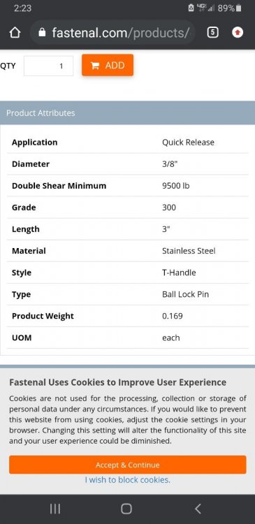

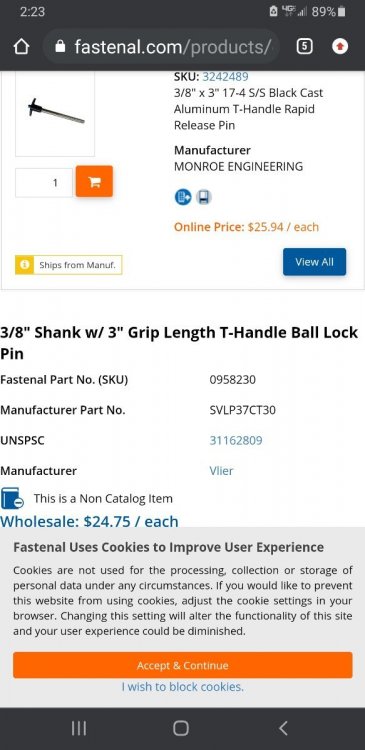

Moderators SeaDawg Posted August 16, 2021 Moderators Posted August 16, 2021 Fastenal has the Monroe/vlier at around $26. $20 if you have a wholesale account, and buy online. We have similar t-handle pins on our 2008. Glad we haven't lost one, at that price. 1 1 2008 Ram 1500 4 × 4 2008 Oliver Elite, Hull #12 Florida and Western North Carolina, or wherever the truck goes.... 400 watts solar. DC compressor fridge. No inverter. 2 x 105 ah agm batteries . Life is good.
