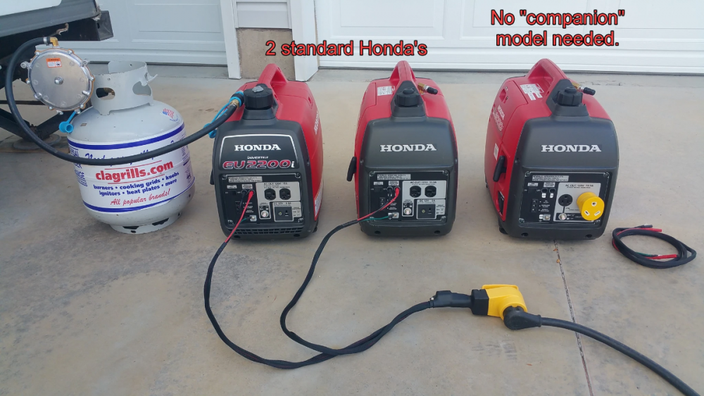

taylor.coyote Posted August 24, 2021 Posted August 24, 2021 You can go with two standard Honda 2200's and not purchase the companion unit with the 30 amp 3 prong plug if you purchase the Hutch Mt power grip parallel cable. I had them build a custom extra long version with a marine end that threads into my trailer power input. Very clean and simple. You have the option to run one or two 2200's with this cable. One cable gets it done if you have them build you one with the marine end that matches your trailer's input. Many ways to get the job done. This system works very well. My generators live on the end of my bedside. I drop my tailgate, open the back hatch of the A.R.E. truck canopy, pull out the bedside about two feet, plug in the cables, tap into the front external LP quick release and we have power from one or two 2200's as needed. https://www.hutchmountain.com/collections/amazing-generator-accessories/products/power-grip-parallel-cable-w-handle-30amp-breaker https://www.hutchmountain.com/products/power-grip-parallel-cable-w-handle-30amp-breaker 2 1 2016 Legacy Elite II, Twin Beds, Hull #124 Tow Vehicle: 2019 Ford F250 4x4 / Short Bed / Crew Cab / 6.7 Diesel Fieldbrook, Ca
