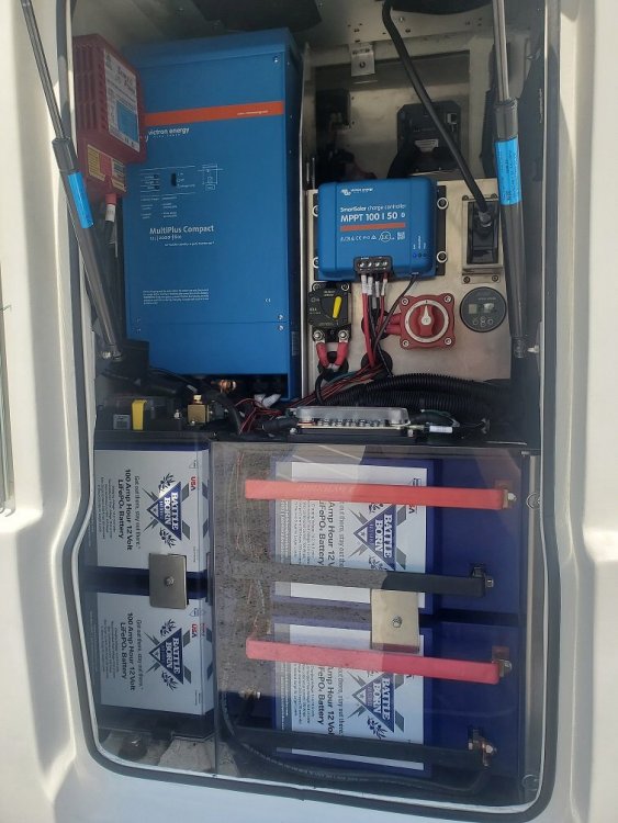

“With 60 some campers in the field we find ourselves doing quite a bit of service and upgrades. One of the more significant upgrades we offer is our comprehensive electrical system refit. We gut the entire electrical bay and install a custom Victron/Blue Sea/Sterling system with BattleBorn LiFePO4 batteries. It's a big, complex upgrade but ends up performing, and looking, amazing.

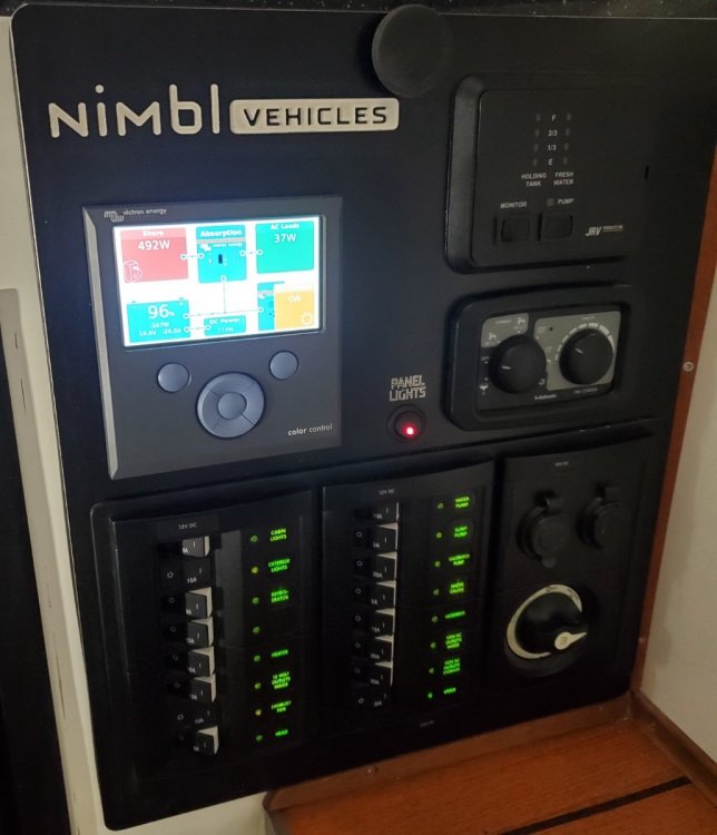

The Victron Color Control consolidates all the controls and information into one easy to use intelligent display, making monitoring your electrical vitals a snap. You can also monitor and control everything by Bluetooth on your phone or even access and control it via the internet (great for monitoring when stored).”

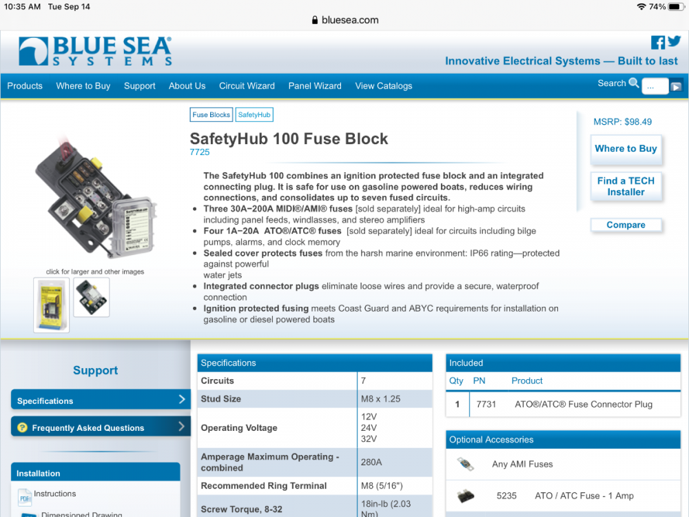

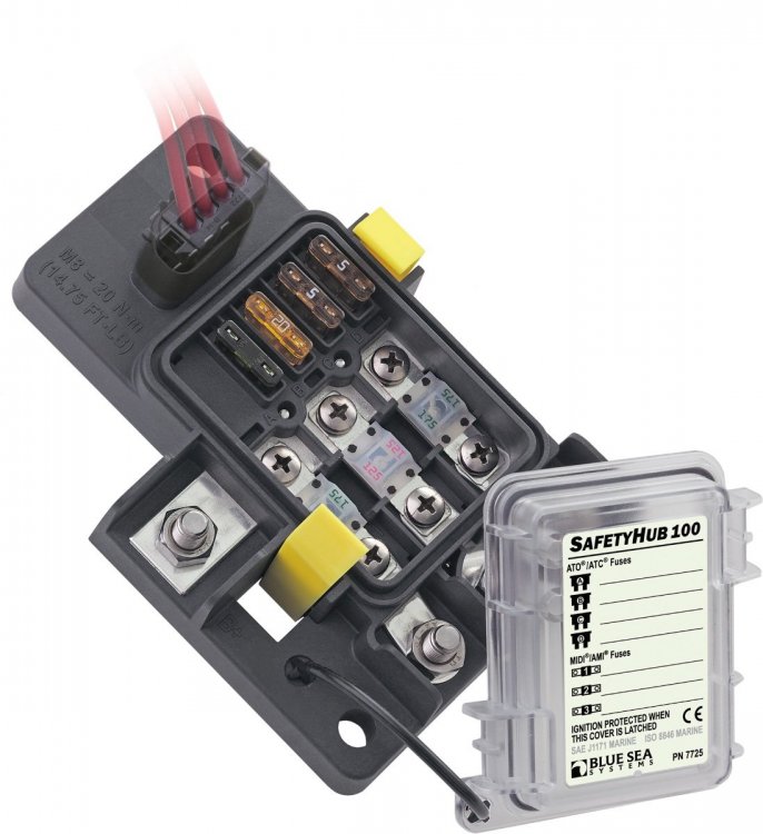

Yep, looks nice.  Interesting bus bars on the batteries - looks like bent copper bar with plastidip?  I kind of like that solution vs some of the other bus bar implementations we've seen.  It seems like it preserves much of the flexibility of cables.  That Multi looks like it could use a bit more breathing room though.  What's that box on top of the batteries on the left?
The original pictures I downloaded are higher res than the ones on the forum. Here you go…. I flipped and cropped it.
C77E86AB-5AC5-4E4F-AF27-36BCA08DAC90.thumb.jpeg.a984e7dfa29616219e2ed4dde06c3810.jpegB158FE66-413C-49E7-84FC-ABA058F51709.thumb.png.eef1624e47fa0b4ef496e6f11abd7037.png
I am not 100% sure why they chose that particular product, but the quality is top notch.

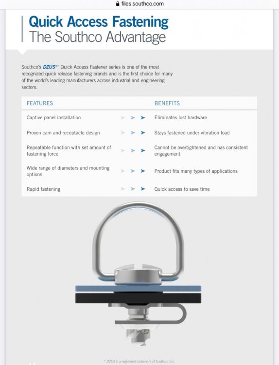

Another pic from that thread shows a clear lexan (?) cover over those copper (?) battery bus bars, probably to prevent accidental damage from somebody thinking they are battery pull handles 😳. If it were my installation I would have prominent NO GRAB labels on all four of them. You have to build for the worst case scenario, which includes an owner who is tired, inebriated, and possibly standing in the rain at night with a flashlight gripped in his teeth.
You can sort of see the aircraft Dzus quick release fasteners that hold it on. That is very high end design work..
https://files.southco.com/static/documents/brochures/201808-BR-Quick-Access-Fasteners_EN.pdf

I just noticed it looks like a Sterling battery to battery charger in front of the Multi.  I wonder why they chose that over a Victron when they used Victron kit everywhere?  With a truck camper especially, you'd think that they'd want engine charging info to be integrated with everything else.
