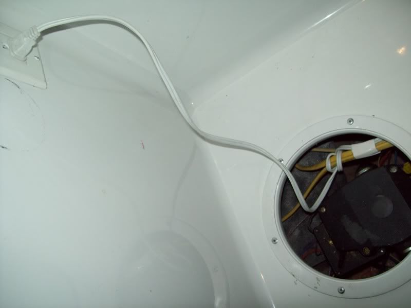

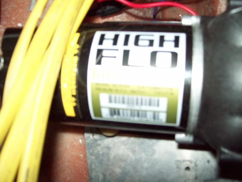

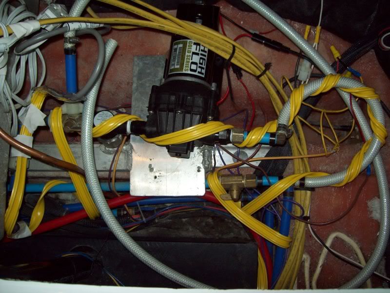

Moderators mountainborn Posted December 17, 2009 Moderators Share Posted December 17, 2009 Today was a day off for us and we went to a local Farm & Home supply place and Betty bought me a new pair of overhauls and a 13' heat tape. We installed it so that it will keep the water pump from freezing as well as the lines where the water supply comes in. The installation was tough since we were having to work through the seat storage and between the hull halves. It would be much neater if it was installed during construction and before the hull halves were mated. The power cord comes out through the manual electric jack access port, staying there until needed: Here is the water pump portion of the install: Water pump look different from yours ? Here is a closer look: A closer fit and better freeze protection would result from a factory install during construction. Freeze test coming up tonight ! I would rather wake up in the middle of nowhere than in any city on earth 08' Oliver Legacy Elite HULL NUMBER 0003(sold) Link to comment Share on other sites More sharing options...
