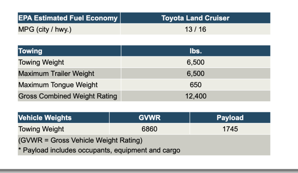

John E Davies Posted February 8, 2022 Share Posted February 8, 2022 I would like to add that many Land Cruiser owners add lots of heavy accessories like skid plates and racks, and install oversized tires. All these severely affect its towing ability, and wreck the fuel economy. If that term can even be applied to this series of (wonderful) trucks. How many mods have you done to yours, and what is your payload now? I found this, your original payload is actually pretty decent, it is higher than the LC200, but the tongue weight limit is really marginal for the LE2, which has about that much, on average. I hope this doesn’t sound too negative, I love mine. I just don’t think it tows the big Ollie very well. But when Armageddon arrives I will be glad to have it😬, at least until I can’t find enough gas to keep it going. John Davies Spokane WA 1 SOLD 07/23 "Mouse": 2017 Legacy Elite II Two Beds, Hull Number 218, See my HOW TO threads: Tow Vehicle: 2013 Land Cruiser 200, 32” LT tires, airbags, Safari snorkel, Maggiolina Grand Tour 360 Carbon RTT. Link to comment Share on other sites More sharing options...
