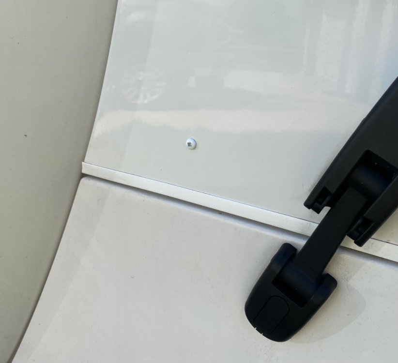

Got a note back from service stating that they started scoring back of block in the 2021 production to improve adhesion.  My block was an older stock 2020 version smooth on both sides.

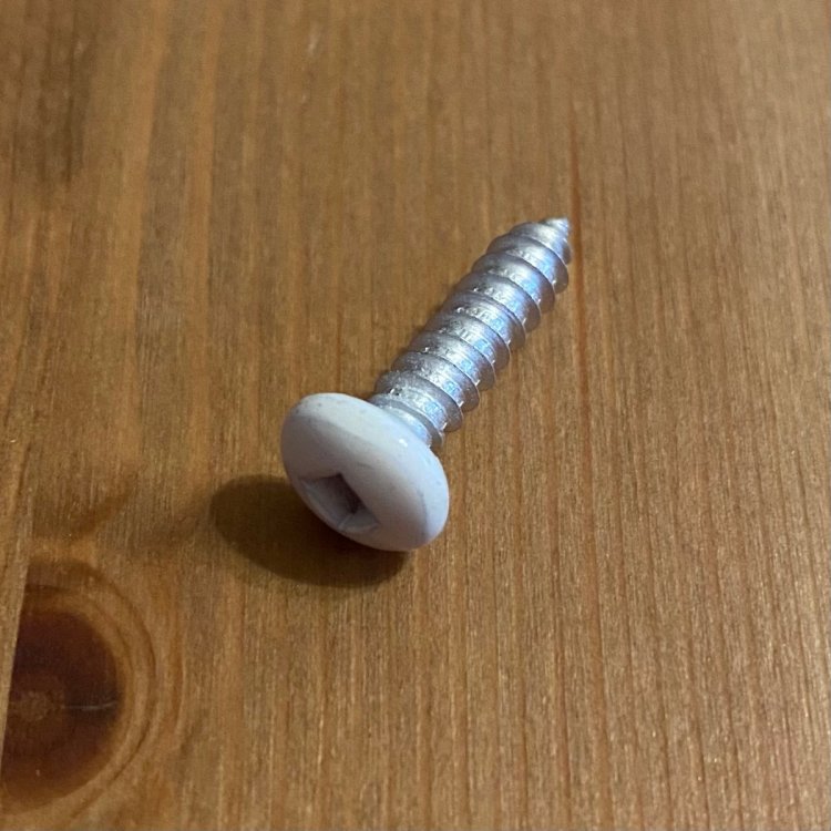

The blocks on my cover never came off, but after seeing a few owners have issues, I secured all three blocks with white pre-painted aluminum trim screws (available at any hardware store like Lowe’s, etc., but I had some in my garage parts stash from a previous house project).  Drilled through from the outer surface of the cover and into the aluminum block and then threaded in the screw.  With the white painted head on the screw, it’s barely noticeable on the white fiberglass.
Nicely done - very clean mod...  Thanks for posting.
