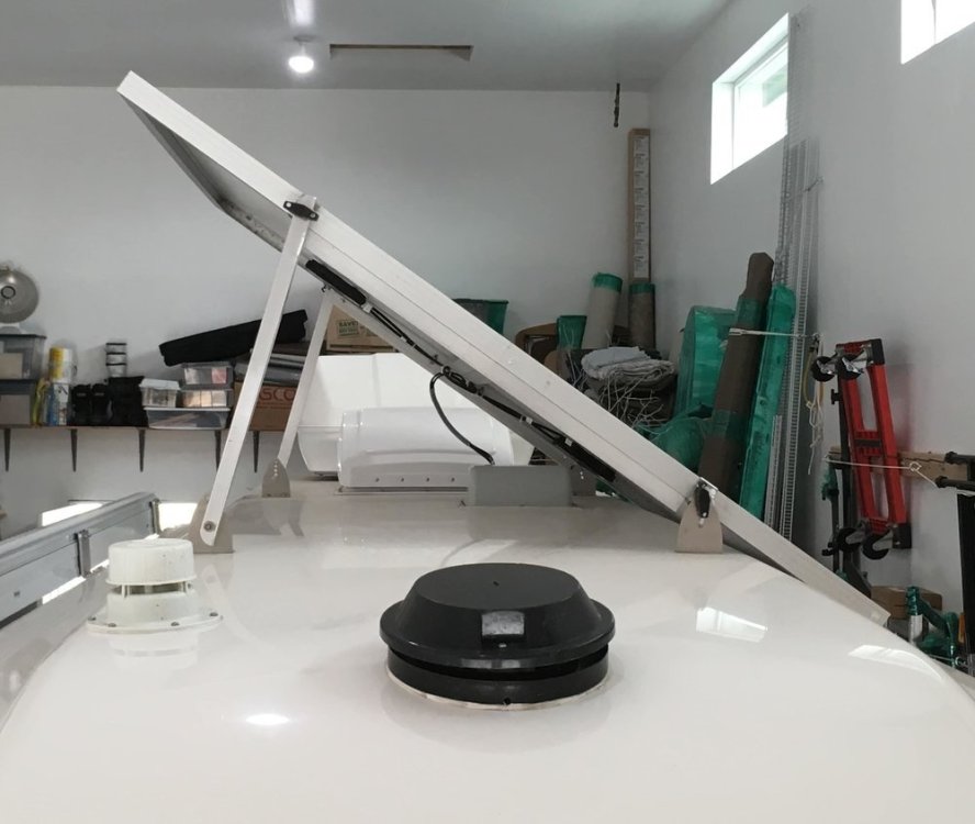

John E Davies Posted February 25, 2022 Share Posted February 25, 2022 You can use the “crawl space” between the awning and the center bulge of the roof easily, IF you raise up the solar panel to give extra room. A foam “eggcrate” camping pad cut in half lengthwise provides padding and a completely not-slip work surface. Be sure to tie your access ladder to the awning so that you are not stranded up there if it falls over. This will only work if you have a single awning, for obvious reasons: https://olivertraveltrailers.com/forums/topic/2791-how-to-solar-panel-extension-arms/ John Davies Spokane WA 2 SOLD 07/23 "Mouse": 2017 Legacy Elite II Two Beds, Hull Number 218, See my HOW TO threads: Tow Vehicle: 2013 Land Cruiser 200, 32” LT tires, airbags, Safari snorkel, Maggiolina Grand Tour 360 Carbon RTT. Link to comment Share on other sites More sharing options...
