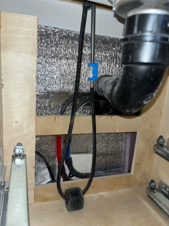

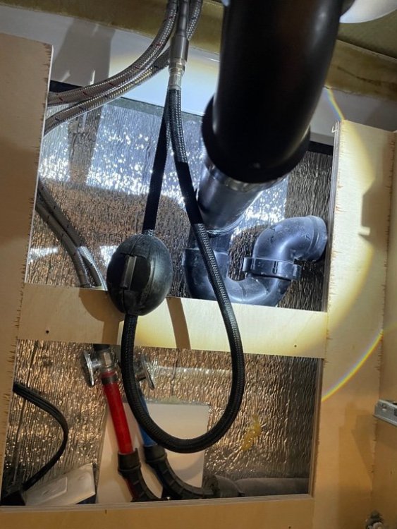

This is easy, it just takes a few nylon ties. Remove the drawers by squeezing inward on both of the orange brackets and lift up. Remove the screws holding the flip out sponge tray. The following pics show the space with the wood tee and the thin plywood access panel removed, that is not needed for this mod. Sorry, the first two pics are rotated and I cannot straighten them out! Does anyone know why this happens?
The faucet hose has a big weight and hangs down at random over the top drawer.,..,,\

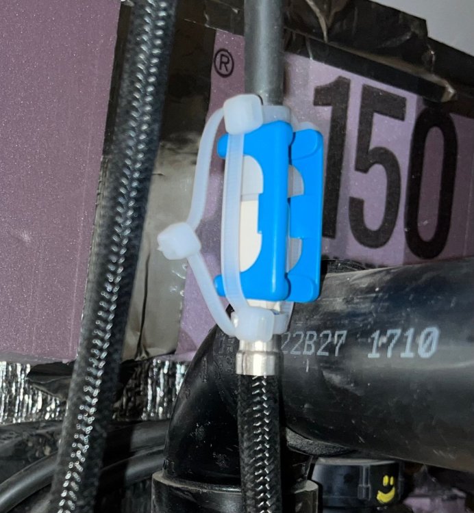

The blue clip secures the two sections of the quick release coupling. At least one owner had their hose come open and it leaked long enough to trash the wood underneath. This tie method will prevent the clip from coming off until you want it to. There is another vertical tie hidden on the far side.
This hose can leak if the oring seal fails or the two halves separate. It would be prudent to inspect this area annually! If you are hooked to city water, it can leak like crazy and you won't know until you see water coming out from the hull drains, and maybe all over the drawer contents. If you are using the 12 volt pump, it will alert you by cycling rapidly IF you do not have the accumulator (mine does not). If you have an accumulator, that will mask the leak to a degree!.

JD:  Good suggestion.  Just wondering if crossing the two zip ties to form a pair of "X's" over the blanks vs. two parallel ties would make is more secure?  Or am I missing something.
Thanks
GJ
I am not sure exactly how that would help. I have used this pattern every now and then for many decades, usually for an electrical quick connection that has a broken retainer, or to simply make sure something could not possibly separate. You could also use stainless safety wire in your X pattern, it follows unusual routes better than nylon ties. That would be OK for plumbing, but not for wires!
