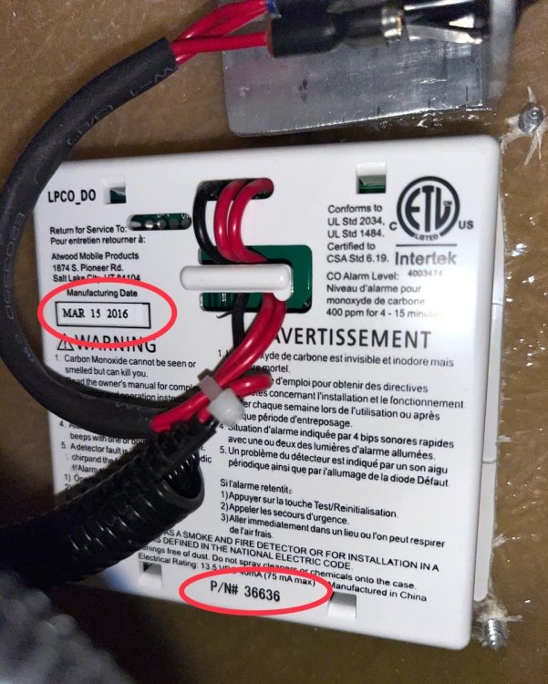

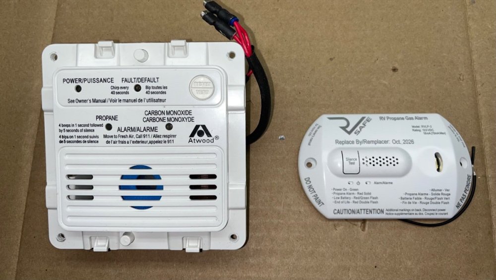

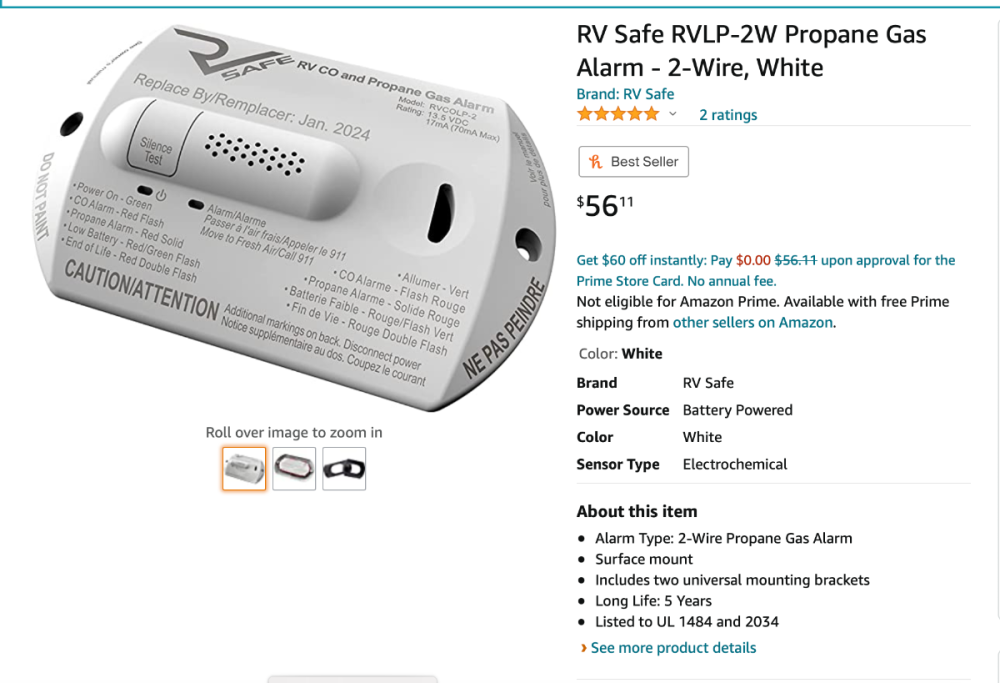

My original combination detector was getting close to retirement (72 months). It is a really expensive unit ($90 to $160 online) and a little hard to find in stock.
I bought these units:

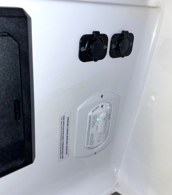

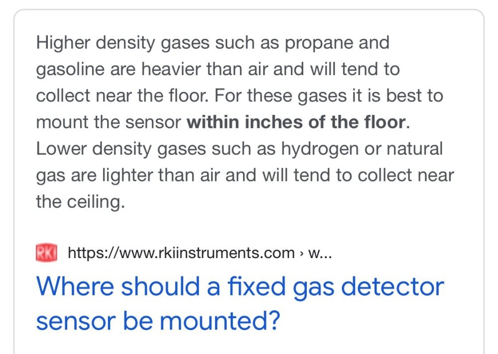

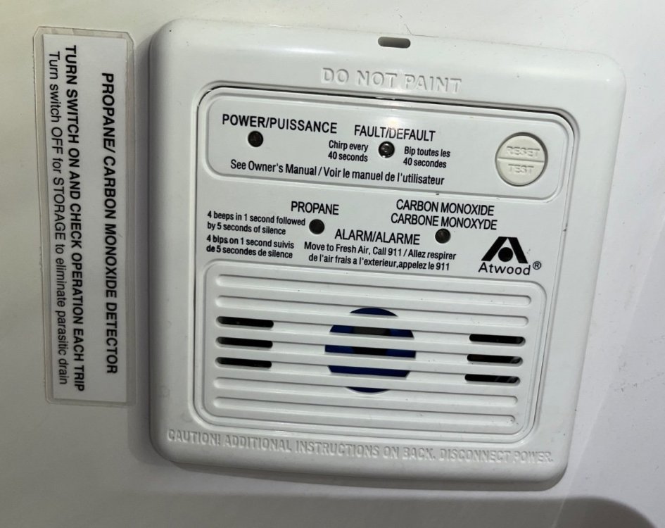

The propane detector has to go near the floor, because the gas is heavier than air. Here is the Oliver installed one:

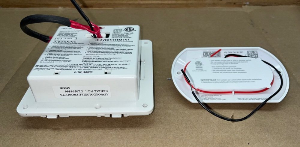

Size comparison:
The difference in thickness and weight is enormous, too bad Oliver doesn't use these from the start.

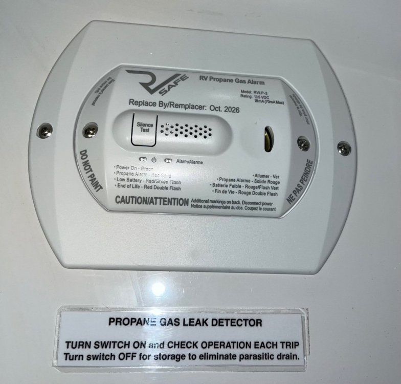

The RV Safe unit comes with two big bezels, to cover up the big ugly hole when you remove an older unit. The small one worked fine here, positioned vertically. This position makes it easier to read the label when crouched down under the table:
It uses the same amount of power as the old one, about 50 milliamps. The big difference is size and (if surface mounting) the need to only drill a 1/4" hole for the wires to pass through. My detector has a power switch:

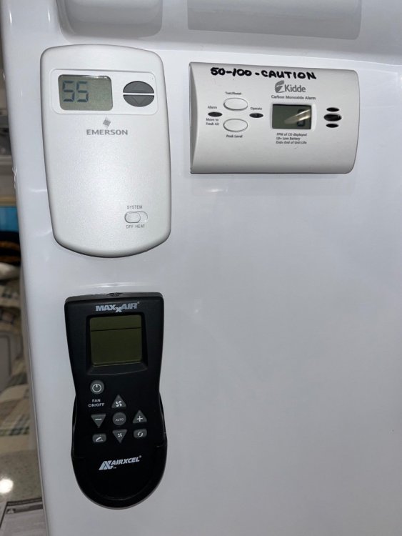

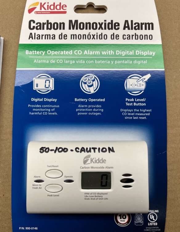

I really like the Kidde unit, I have one in my garage and one in my house next to the thermostat. The big deal about it is that it records the concentration level history, and you can push the button to see the peak level and erase it. A dumb detector is just YES or NO, which tells you nothing at all until it alarms. Anything up to 50 ppm on the Kidde can be ignored. 50 to 100 is getting hazardous, you should investigate. My garage unit peaks at 55-60 when I run a car engine nearby, that doesn't worry me any. Repeated high levels might mean the furnace or water heater is acting up.
I screwed it to the wall next to the thermostat, for easy visibility.
FYI, Ollies come with two detectors, a Smoke/ CO unit in back, and a Propane/ CO detector near the galley floor.

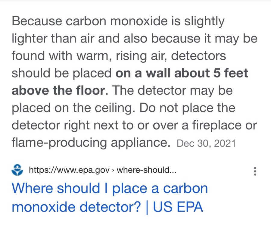

A nice solution, and the original combo detector mounted by the floor doesn’t make a lot of sense since the recommended locations for CO vs. propane are different.   A CO detector should be mounted higher, while a propane detector should be close to the floor.   Thankfully Oliver installs the other smoke/CO detector up high back by the beds.

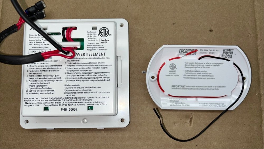

RV Safe describes their gas detector as "battery powered", that is misleading since you must hard-wire it to a 12 volt source. It has no internal batteries.
