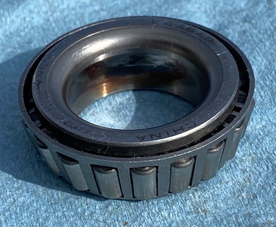

Rleog Posted June 8, 2022 Share Posted June 8, 2022 Hull 244, LE II. 2017 Approx 30,000 miles on the trailer. Bearings first repacked at 9,100 miles. Repacked a second time at 22,000 miles. After another ~8,000 miles I decided to inspect and repack them again. The pics below are the outer bearing from the L (streetside) forward wheel. I carry an infra red temperature ‘gun’ and regularly monitor the wheel temps near the hub when on extended trips. There was no indication of that wheel having elevated temps. I also carry spare bearing sets and tools to change them on the road. I changed out all 8 sets of roller bearings and races yesterday and today. This outer bearing and race was the only pair that was damaged. Carry spare bearings. 1 6 Bob G Link to comment Share on other sites More sharing options...

connor77 Posted June 8, 2022 Share Posted June 8, 2022 Can anyone ascertain what caused this? Is this a bearing quality issue? Just normal wear and tear? Since RLEOG has done regular maintenance and used a premium grease it would appear to me that this is a bearing quality issue. I'm asking because the answer will likely determine if I swap out the original Dexter (Chinese) bearings (when I'm ready to do this service) instead of cleaning and repacking them. The answer might also motivate me to do this sooner than the recommended 10k or 12k miles that Dexter suggests. 2 2021 Elite 2 Hull # 832 "Bucket List" 2021 F250 7.3L Gas / 4.30 AR / Central Maine Link to comment Share on other sites More sharing options...
Frank C Posted June 8, 2022 Share Posted June 8, 2022 1 hour ago, connor77 said: Can anyone ascertain what caused this? Is this a bearing quality issue? Just normal wear and tear? Since RLEOG has done regular maintenance and used a premium grease it would appear to me that this is a bearing quality issue. I'm asking because the answer will likely determine if I swap out the original Dexter (Chinese) bearings (when I'm ready to do this service) instead of cleaning and repacking them. The answer might also motivate me to do this sooner than the recommended 10k or 12k miles that Dexter suggests. I had the same concerns as you. So when I did my recent annual maintenance I swapped out the original Dexter supplied bearings with new genuine Timken bearings from an authorized Timken distributor near me here in Pennsylvania, and verified as genuine Timken using the WBA bearing app. There are a lot of counterfeit “Timken” bearings on Amazon so be careful what you buy. Some of the original Dexter installed China bearings showed some odd discoloration on the races that appeared thermal/heat related (see photo) even though they had always been well maintained/greased, so I didn’t want to take any chances so I replaced them. Thankfully the axle spindles were still in perfect condition. 2 Link to comment Share on other sites More sharing options...
