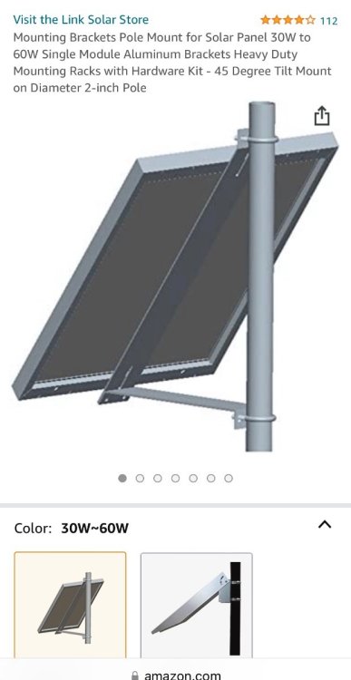

“Covered storage” yay! This sounds like a perfect scenario for a 50 to 100 watt portable panel for maintaining the AGMs as a trickle charger. You might need to secure the panel with a cable lock. Or ask the owner if you can permanently mount a bracket on a nearby roof support.
