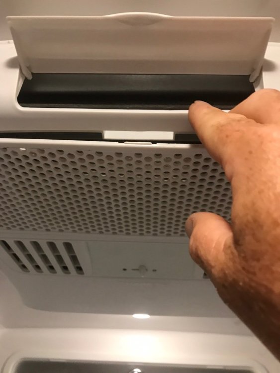

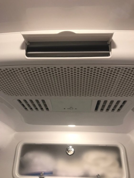

Is the return air filter clean? It is located under the grill shown in the photos below. Be careful removing the grill. It’s easy to break the tabs off and it’s not available as a separate part.
Do you feel air coming out of all four openings on the sides and the sliding grate on the bottom?

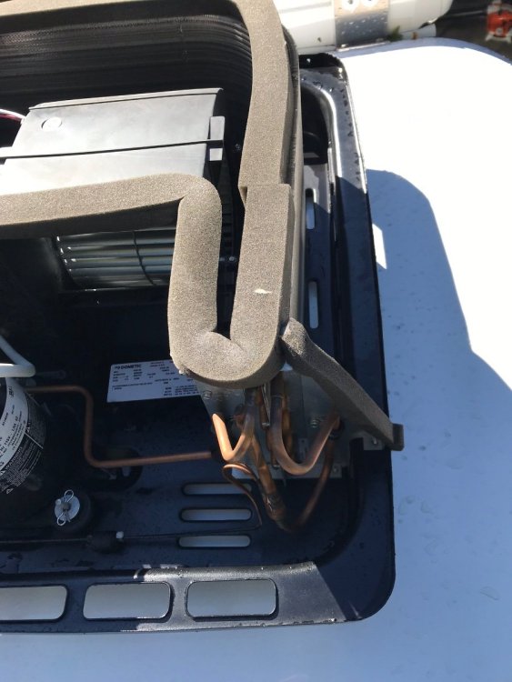

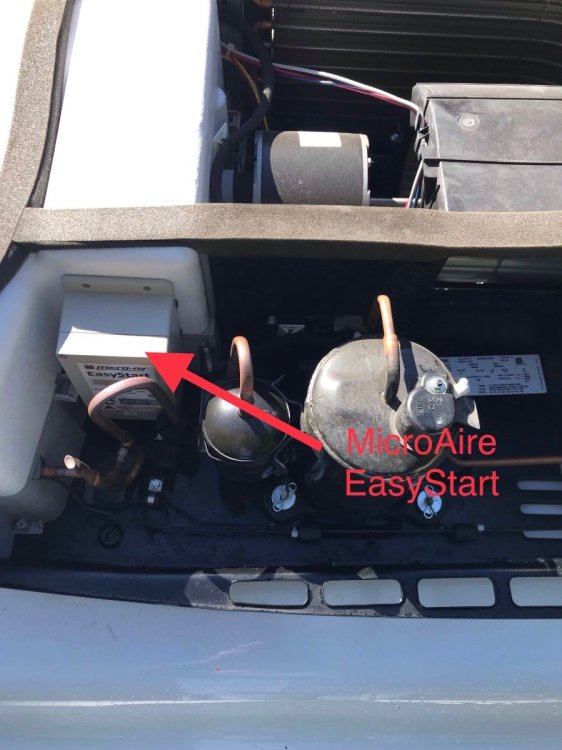

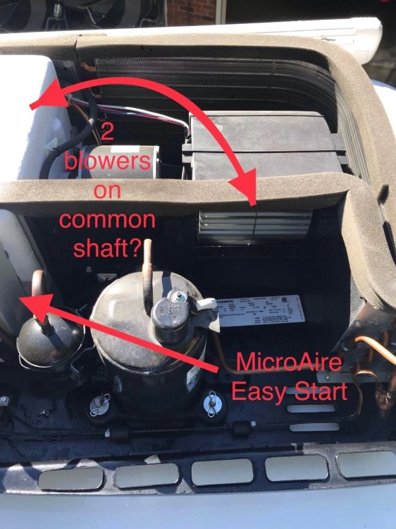

Your trailer is a 2017 so it has been in storage. Has anyone checked to see if the coils under the shroud on top are clean?
(Disregard arrows and text, I used these photos before to explain something else.)

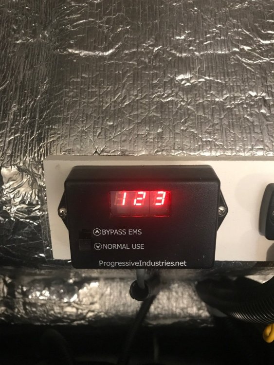

What is the voltage shown on your Progressive Industries display?
Do you feel air coming out of all four openings on the sides and the grate on the bottom?
Your trailer is a 2017 so it has been in storage. Has anyone checked to see if your coils under the cover on top are clean?

Stick your fingers in the opening on the front and gently press down on the return air filter/grill then remove the two and separate them. Clean the filter and grill. Leave them off if the filter is completely plugged and see if your air is cooler.  You will need to get an RV Tech to remove the a/c shroud on top and check for dirty coils.

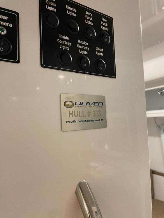

@Margaret Do you have hull number 179?
Not sure.  Sorry if I sound naive.  Where is hull number?
Margaret.  Oliver Legacy Elite II, 2017 (Jasmine).  Nissan Armada 2018.  Hull 179.

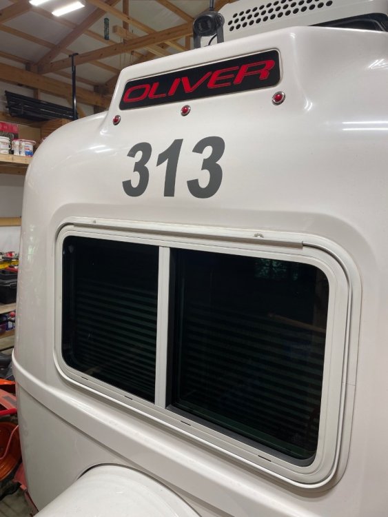

@Margaret At the time your Oliver was built your hull number will be the last 3 digits of your VIN number. Later production Olivers have a hull number not indicated in the VIN. The hull number indicates where in production history your Oliver was built. I have hull 313 so it was the 313th Oliver built. When you ask questions about your Oliver and readers know your hull number it gives us some idea of what might be going on with your Oliver. Some problems are known to be associated with a particular range of hull numbers. Owners that have Olivers built around the time yours was built may be able to provide help because they have already experienced the problem you are having. By listing your hull number in your signature line readers have some idea as to how to better respond to your questions.
Look for VIN sticker on left front corner
Or on a sticker near the hinges on the door
Your Oliver might have a hull number plaque near the door
Some Olivers have the hull number on the top rear

I will add that Oliver Sales or Service (?) will send you a complementary hull number plaque as shown above for you to apply near your entry door, normally it would be below the switches, but you can use your imagination. My 2017 LE2 Hull 218 did not have one, they sent me one a few years ago. It did not come with adhesive, I used double sided Scotch tape. You can also look at your trailer registration, the VIN is on there, so the last 3 digits should be the hull number. Normally when you submit a Service Department request (Ticket) they ask for that.
