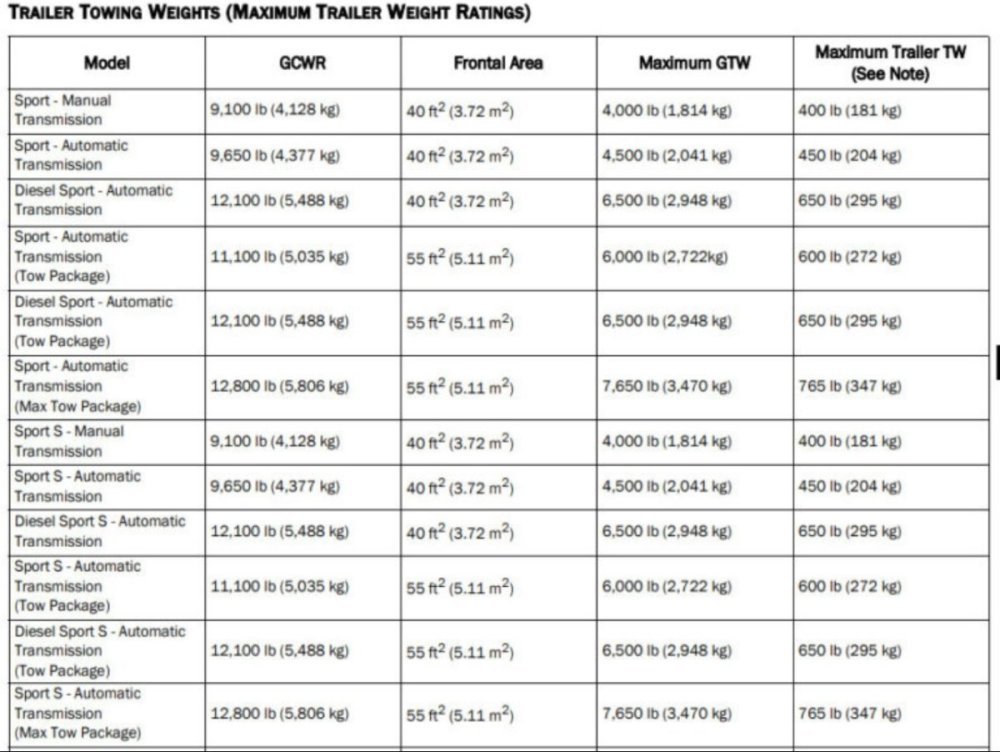

Trainman Posted August 28, 2022 Author Posted August 28, 2022 So far hoho and CRM do not have the facts together, the Gladiator Sport with Max Tow Pkg has a towing capacity of 7600 lbs. and 1700 lbs. of carry on weight which includes tongue weight and carry on weight. The Oliver Elite II will easily fit in this towing range, so once again is anyone towing with a Gladiator. Jeep Gladiator Factory Towing Specs. trainman 2019 RAM 1500, 5.7 Hemi, 4X4, Crew Cab, 5'7" bed, Towing Package, 3.92 Gears. Oliver was sold.
CRM Posted August 28, 2022 Posted August 28, 2022 7 minutes ago, Trainman said: So far hoho and CRM do not have the facts together, the Gladiator Sport with Max Tow Pkg has a towing capacity of 7600 lbs. and 1700 lbs. of carry on weight which includes tongue weight and carry on weight. The Oliver Elite II will easily fit in this towing range, so once again is anyone towing with a Gladiator. trainman Was just going by the weight specs on their website. They'd be smart to include the optional towing package capacity in those specs.. 2010 Elite II Hull #45, the first LE2 sold. 2020 Toyota Tundra TRD Off Road 4WD 5.7 with 38 gallon tank, 4.30 axle and tow package.

hobo Posted August 29, 2022 Posted August 29, 2022 19 hours ago, CRM said: Was just going by the weight specs on their website. They'd be smart to include the optional towing package capacity in those specs.. I did the same. I went to the Jeep Gladiator and looked up the specs which showed a towing weight capacity of 4000 lbs. The listing provided didn't show any version having a rating of over 4000 lbs. If the numbers are in error, then my assessment was made with inaccurate data. 1 2018 Elite II, Hull #414 (the very last 2018 produced). Trailer name "2 HOBOS" . 2018 F250 4X4 Crew Cab, 6.7L diesel
