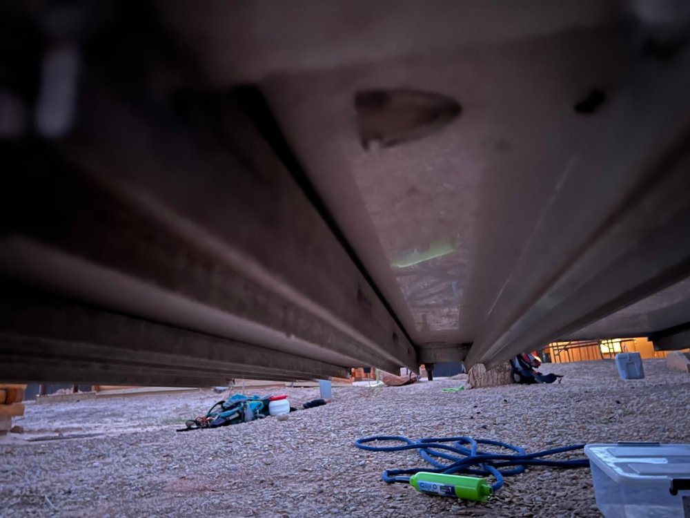

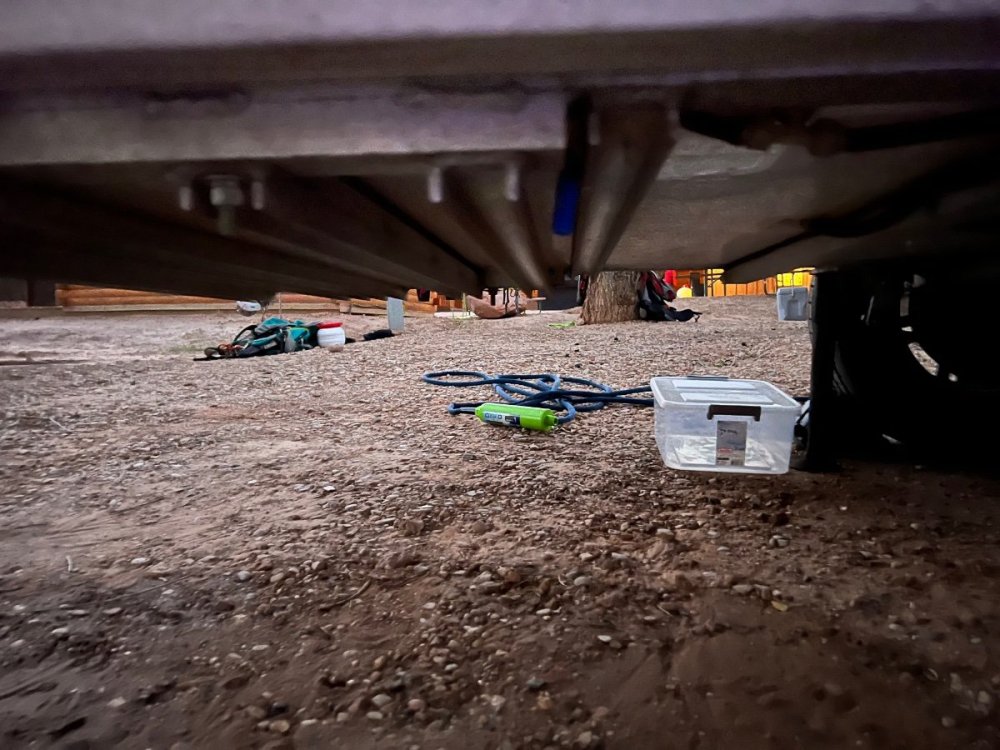

We arrived in Zion NP a few days ago with our 2022 Legacy Elite 1.  After connecting the water spigot at our site straight to our City Connection, we noticed water exiting a blue hose underneath the trailer on the passenger’s side behind the trailer wheel.   Now, even after disconnecting the water, we have a leak under the trailer, at an outer body shell drain.
We are looking for diagnostic help as to the source of the leak.

The pictures attached show the blue tube, and the body drain water is currently leaking from.  When faucet was connected to City Water, water flowed as a small constant trickle out of the blue hose.  After disconnecting, no water comes from blue hose, but there is a constant drip (~once every 3 seconds) from the body drain.  :(

The blue tube exiting under the hull is your fresh water tank drain tube.   The drain valve on that drain line might be open.  Have you recently filled the fresh water tank?   If not, it could be a bad check valve in the water pump (or very high city water pressure) that’s letting water from the city water connection leak back into the fresh water tank, and if the fresh tank drain valve is open, water from the fresh tank will exit out of that blue tube.

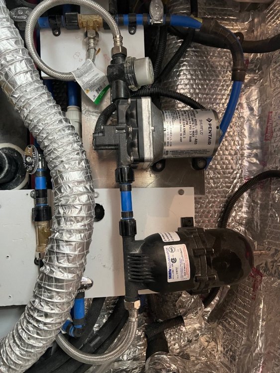

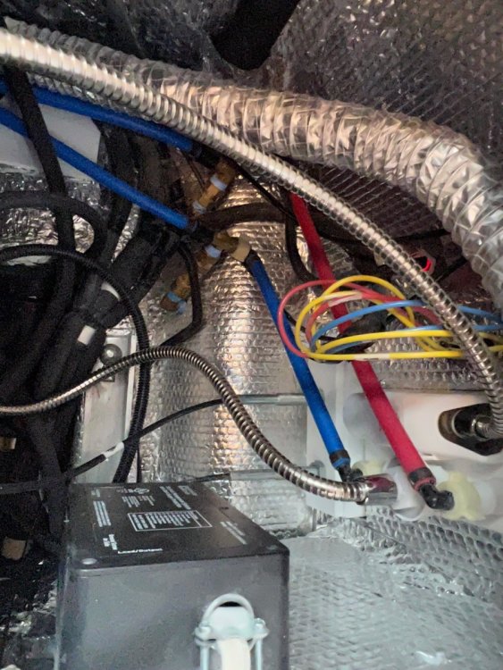

Do you or anyone have ideas for how to check the tank connections?   I’ve checked all connections under the settee/bed cushions, as well as under the sink, and so far everything is testing bone dry. (Dust comes off on finger wipe), and there are no signs whatsoever, including paper towel wipe,  of a deceptive leak running down a pipe or other path in the areas checked.
it’s hard to see dryness in the pictures, but the attached images show the plumbing under each side of the bed cushions.
The valve that controls draining the fresh water tank is on the very bottom of the trailer below the pump and to the right.  You will see the PEX piping, blue, beneath the furnace duct by just raising it and moving it so that you can see the chrome 1/4 turn ball valve.  it has a short piece of PEX, and elbow, and the piece of PEX that you see below the trailer on the curbside and just to the rear of the trailer axle in line with the curbside stabilizer.  This is strictly a gravity drain pipe to allow draining after filling or as a part of the sensitization process.
