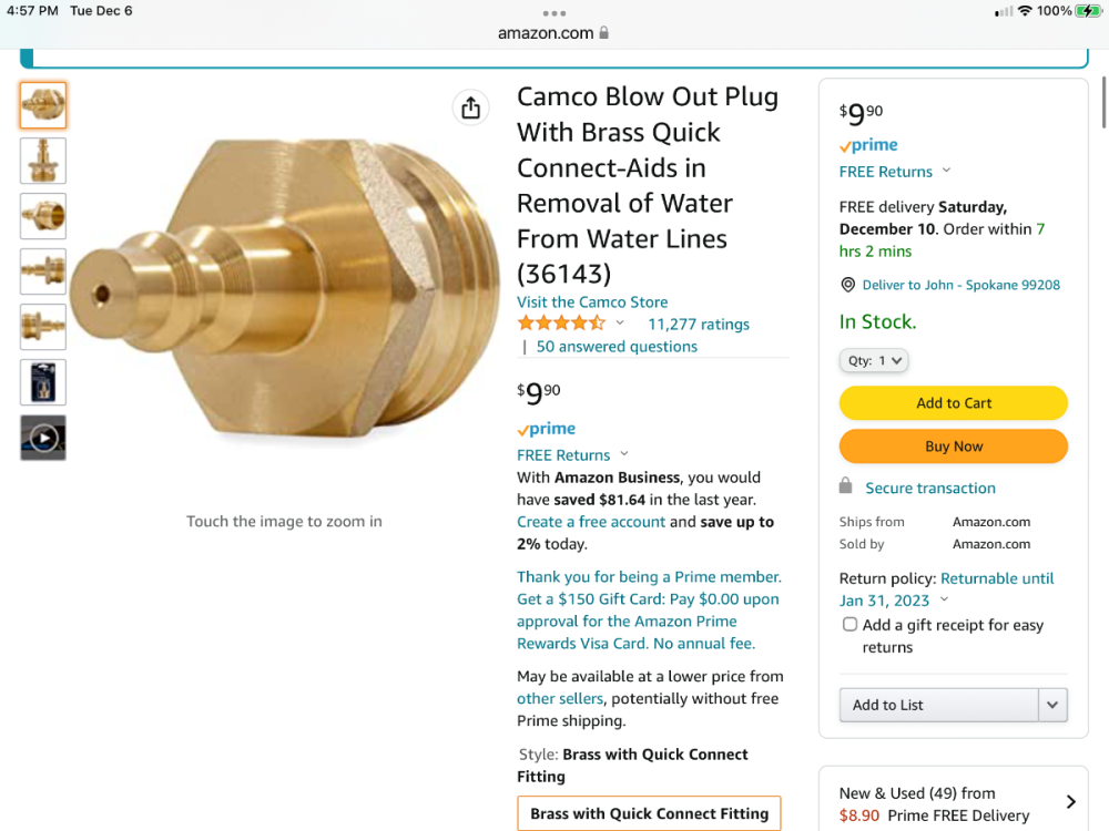

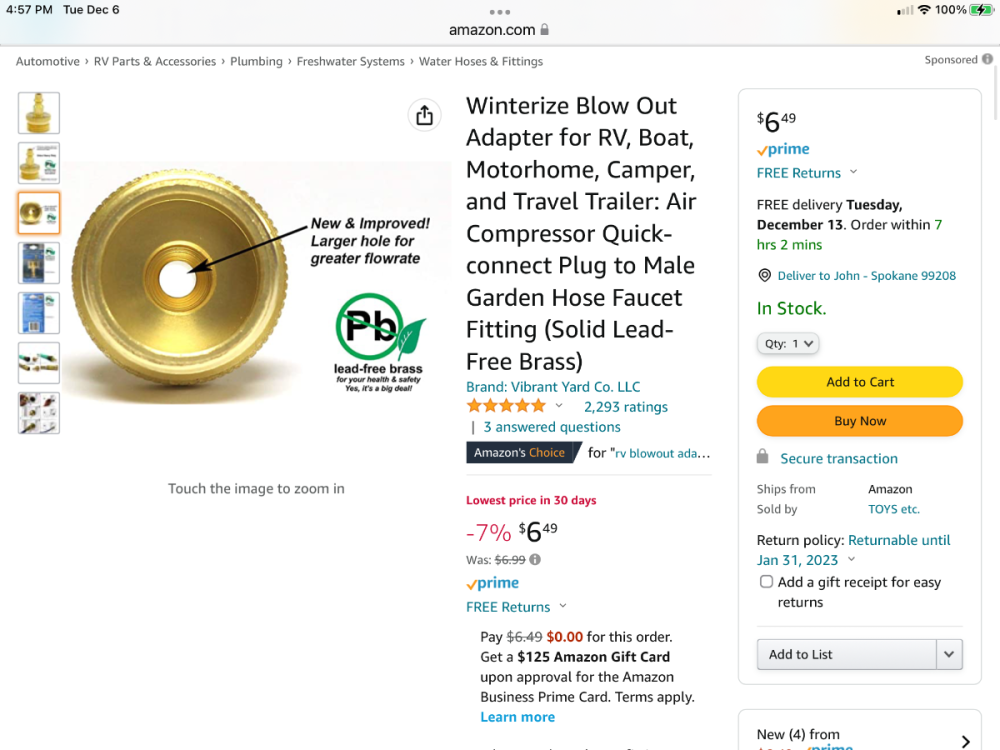

John E Davies Posted December 6, 2022 Share Posted December 6, 2022 24 minutes ago, Geronimo John said: Suggest you VERIFY that the food grade antifreeze you use to winterize your OE2 is rated for at least -50 degrees F. Some are, some are not. Buyer beware. PS: Amazingly the Super Tech is rated for -50F. Surprised me. If I thought the temp was going to drop much below 0 degrees F, I would drain the entire system (long before the cold hit!) and blow it out with air, then do an antifreeze treatment, and then blow THAT out with air. The real worry with using only compressed air is that there will always be a little leftover water in the system, and it will accumulate at the low spots like the street side check valves. Doing it twice with AF in between should make the system freeze proof. The folks who really get screwed don’t winterize nearly soon enough, and when they do try to do it - “OMG an arctic blast is here!” - all the drains are frozen solid and it is far too late. This is all entirely theiretical for me 😬. The coldest my unheated but attached RV bay has every gotten is +42 degrees F. John Davies Spokane WA 3 SOLD 07/23 "Mouse": 2017 Legacy Elite II Two Beds, Hull Number 218, See my HOW TO threads: Tow Vehicle: 2013 Land Cruiser 200, 32” LT tires, airbags, Safari snorkel, Maggiolina Grand Tour 360 Carbon RTT. Link to comment Share on other sites More sharing options...

John E Davies Posted December 7, 2022 Share Posted December 7, 2022 1 hour ago, GAP said: I do have the nozzle attachment and hose fitting to do so as well as a pressure control valve but we've read and have been told by the OTT shop to not do so. To fill in some blanks can you share how you've safely blown out lines on your Oliver and why you suggest the redundancy of blowing out and winterizing with antifreeze twice? You need to keep the compressor at no more than 60 psi. It will not hurt anything. Using 120psi off a big compressor will rupture lines. I suggested blowing out twice with AF between those two processes. As long as you trust your AF is rated to -50F, I think you would be safe with just the AF. The main thing is to try to eliminate any and all trapped pockets of water. Do you plan to carry an extra propane bottle? You will go through the gas incredibly fast. Depending on the inside temperature…. My adapter is a Camco one, I drilled out the tiny hole to make it flow better. I see that you can now buy one like that, see below. John Davies Spokane WA 2 SOLD 07/23 "Mouse": 2017 Legacy Elite II Two Beds, Hull Number 218, See my HOW TO threads: Tow Vehicle: 2013 Land Cruiser 200, 32” LT tires, airbags, Safari snorkel, Maggiolina Grand Tour 360 Carbon RTT. Link to comment Share on other sites More sharing options...

GAP Posted December 7, 2022 Author Share Posted December 7, 2022 15 hours ago, John E Davies said: You need to keep the compressor at no more than 60 psi. It will not hurt anything. Using 120psi off a big compressor will rupture lines. I suggested blowing out twice with AF between those two processes. As long as you trust your AF is rated to -50F, I think you would be safe with just the AF. The main thing is to try to eliminate any and all trapped pockets of water. Do you plan to carry an extra propane bottle? You will go through the gas incredibly fast. Depending on the inside temperature…. My adapter is a Camco one, I drilled out the tiny hole to make it flow better. I see that you can now buy one like that, see below. John Davies Spokane WA Hey John, Thanks for the clarifications. Yes, we do travel with a 3rd 30lb propane tank. We found last winter that once temps got below 10f, we went through a 30lb tank every other day. Will probably go through it faster this year because we've made tweaks to run warm air through the closet, basement and garage so will be heating more areas. Also, if it seems safe, will be turning on the water system this season so the water heater will eat up some BTUs. I am intrigued by your suggestion to blow out lines in addition to using antifreeze. As I've never blown out before, I'll look for youTube procedure to do so. I have a regulator which supposedly with limit pressure to 45lbs. I do remember hearing that the danger was not to expose pressurized air to one of the systems - water heater or pump mabey - can't remember which. Does this ring a bell and how do you workaround when you do so? SOLD: 2021 Elite 2, Twin Bed, Lithium & Solar, 3000W Inverter SOLD: 2022 Ford F150, 3.5L V6 EcoBoost, 4x4 Supercab, Trailer Tow Package Link to comment Share on other sites More sharing options...
