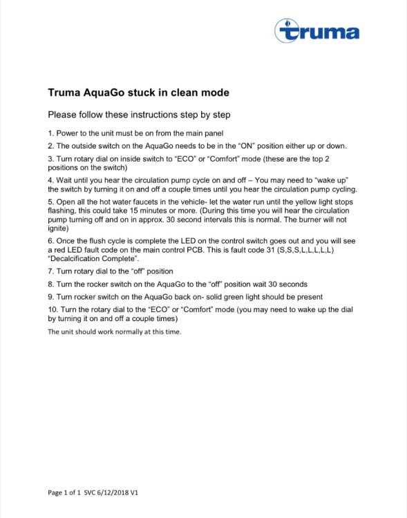

Dave Mazone Posted January 29, 2023 Posted January 29, 2023 I really don't like the search function in this app! Anyway, I decalcified today and did it be the book (albeit my first year). I cannot get the LCD 3 at the control panel to stop flashing rapidly and hence cannot get the system working again. Repeat: I did it by the book. Anyone have a reason for this and a solution? Thanking you in advance. Dave & Terri Mazone 2022 LII Hull #1019 TV: 2001 Chevy Silverado 2500 HD diesel, Crew Cab (4WD)

Frank C Posted January 29, 2023 Posted January 29, 2023 Here’s the instructions from Truma if the unit is stuck in CLEAN mode. 2 4

Dave and Kimberly Posted January 29, 2023 Posted January 29, 2023 We were up in Nova Scotia... when I inadvertently bumped it into the "Clean mode". Frank C came to the rescue with the above procedure to reset the Truma water heater and it was much appreciated. I would advise everyone with the Truma water heater to print that off and keep it in your manual. It's not in the manual. 1 2 2022 Elite II, Hull #1097 Elli Rose 🌹 and she has the solar panels with the 390Ah lithium batteries. Our tow vehicle is a 2019 Ford Lariat F-150 4wd, 3.5L Eco-boost, 3.55 rear end, with the Max tow package. Elli Rose also has the street side awning and several walnut and cherry mods on the inside.
Dave Mazone Posted January 29, 2023 Author Posted January 29, 2023 2 hours ago, Frank C said: Here’s the instructions from Truma if the unit is stuck in CLEAN mode. Super Thanks! I will give this a try today. 1 Dave & Terri Mazone 2022 LII Hull #1019 TV: 2001 Chevy Silverado 2500 HD diesel, Crew Cab (4WD)
Dave Mazone Posted January 29, 2023 Author Posted January 29, 2023 9 hours ago, Frank C said: Here’s the instructions from Truma if the unit is stuck in CLEAN mode. Frank, that did it! Thank you so much. 1 1 Dave & Terri Mazone 2022 LII Hull #1019 TV: 2001 Chevy Silverado 2500 HD diesel, Crew Cab (4WD)
