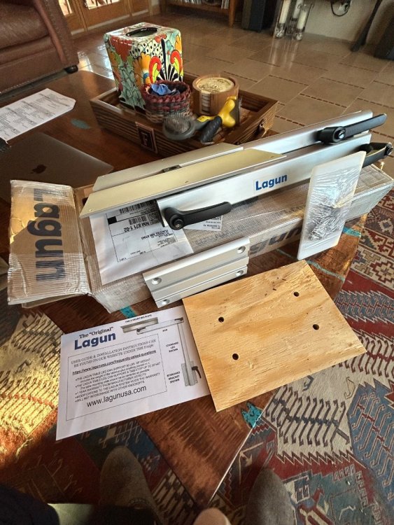

The Lagun hardware arrived here when I was on travel last week.  We ordered it from Lagunusa.com directly.

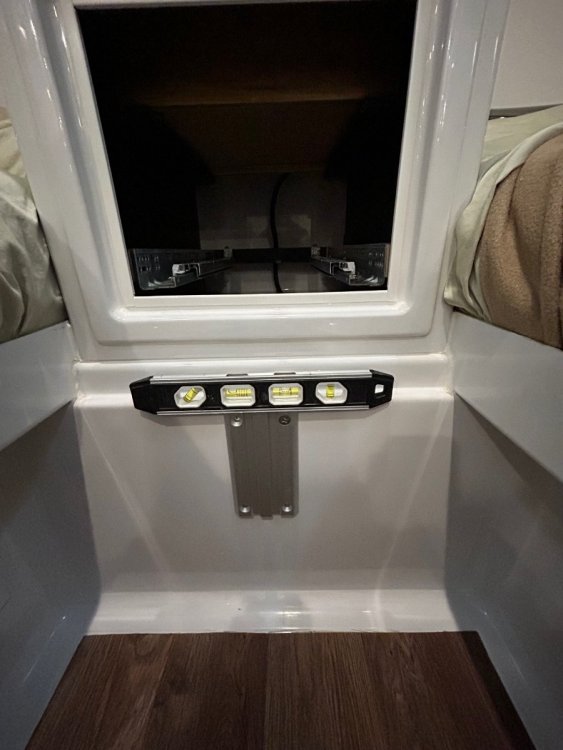

OK, so I started the Lagun Table installation a couple days ago.  I installed the main leg mounting bracket first.  Leveled rig fore/aft and port/starboard to get a good level on the bracket.

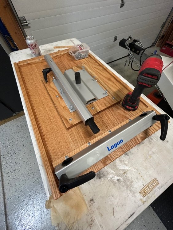

My hardwood lumber supplier here was totally out of mahogany, so I decided to go with American red oak instead, I know - heavier and not as interesting as mahogany, but we've scheduled a long weekend camping trip this Friday and I wanted to get this table knocked out.  We'll call the oak version a temporary bookmark for the time being.  I glued/dowelled 4 pieces of 1/2" x 5.5" x 48" oak to get a tabletop dimension of 20" x 32", FYI.  I used the extra wood for the table mount plate and cross spars (shown in later pix).
The second pic above, shows the grooves on either side of the underneath portion of the table - the grooves are for when the table is in the "Puppy Mode."  They fit over the twin bed lips to hold it in position when either towing or when Magnus is sleeping on it.  This stage was for fitting purposes.
This one illustrates how the grooves fit over the twin bed lip.
Above shows fitting cross spars and mounting plate on underneath side of tabletop.  Spars and plate are glued and screwed to keep table flat and reduce cupping as humidity cycles up and down.
After a few coats of Watco natural oil/sealer, this shows the fitment of the Lagun hardware (in storage/Puppy mode).
Ready to set up...
In tabletop dining mode - height is adjustable to well above nightstand so tabletop can be swiveled either direction...

Did you use any backing or bracing on the other side of the fiberglass? Or is the fiberglass strong enough to hold the weight?
I believe if you look at his very first picture, you will see a piece of plywood with holes in it. I think that is the bracing for the inside of the fiberglass.
Brian
Thanks Brian. I saw that but wondering if that is strong enough. I don't know anything about the strength of fiberglass so I guess I need to do some research on this. Don't want to damage ours when I install the lagun table mount.

The Lagun hardware packet came with a 3/8" thick piece of plywood for the backing bracket.  I chose to use a piece of 3/16" aluminum plate (same width/length dimensions as the plywood piece) as the backing bracket.  It's a bit bigger than the backing plate used for the TV mounting hardware, FYI.
