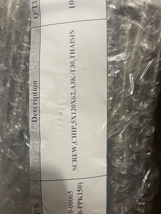

1 hour ago, Rivernerd said:
As a workaround, I asked Oliver Service to email to me a photo of the longer screws, with a description of dimensions and thread pitch
Did Oliver email you the info, if yes can you share it with us?
**Sold😞**

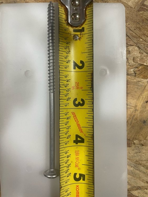

They are 5mmx120mm T30 flathead wood screws.  Photo below shows the bag they come in.
Next photo shows the length in inches.
A Google search so far has revealed no sources for 5mmx120mm wood screws.  But, the approximate size in Imperial screws is #10x5".  Those are readily available in the USA.
I figure if I have to address a leak around my Truma AC unit, I will buy some #10x5" screws and carefully try them.
