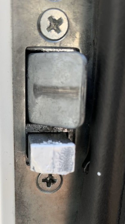

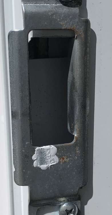

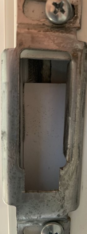

From the time I took delivery of my 2022 Elite #1209, the door has been difficult to latch.  It required too much force, especially for my wife.  I always lock it when we travel.  On two trips the door popped open.  On inspection the latch bolt barely engaged the strike plate.  I adjusted the strike plate sideways but could still jerk the door open.  To resolve the problem I had to grind out the opening in the aluminum door frame further and the horizontal screw hole openings in the strike plate allowing me to slide the strike plate further.  This solved the problem with the latch bolt. It never occurred to me to check the deadbolt as I just assumed it was engaging.  One evening I just locked the deadbolt and then easily pushed the door open.  When home, I placed a small amount of white paint on the end of the dead bolt latch and locked it.  As I expected, the dead bolt latch did not engage the strike place opening.   In fact, dead bolt was hitting the metal on the strike plate and not functioning at all. I could not reposition the strike plate because of the position of the opening in the doorframe.  I cut a square opening in the bottom of the opening in the strike plate and used the paint a time or two to insure that the dead bolt fully engaged the opening and no longer hit the strike plate. I could immediately tell that the deadbolt latch was in the opening and the door firmly locked. It was obvious that either the wrong strike plate was used at the factory or that they positioned it too high so both the latch bolt and deadbolt could not both go into the same opening.
The photos show the paint marker on the end of the deadbolt latch, where it struck the strike plate, the square opening I had to cut into the strike plate to get the deadbolt to work properly.  I advise, especially new owners, to take a close look at the position of the door strike plate and insure that both bolts are engaging.

Looking at the pictures it looks like the striker plate is on upside down which was stopping the deadbolt from engaging at all. Do you know if the deadbolt has ever worked since you picked up the camper from delivery day? Looking at the white piece inside the door, it looks like the striker plate has been flipped at some point as the white piece is installed as a background so you don't see the inside of the door frame.
