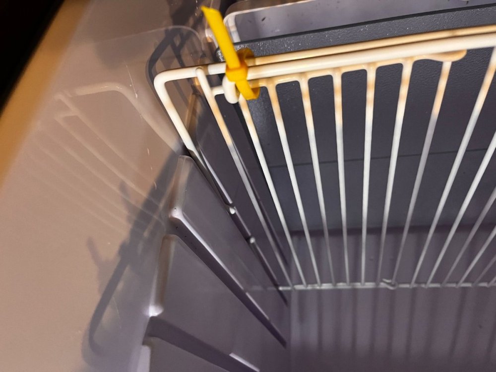

John E Davies Posted May 11, 2023 Share Posted May 11, 2023 I just installed one, into Hull 218, and the shelves are a disgrace. You need to remove them, bend the side “spring bars” outward (that ride in the grooves), I doubt that they have an actual name, and try to make the shelves straight again. They are much smaller gauge wire than the old Dometic 3 Way, and seem to be made from old wire coat hangers. And they seem to have the same strength, meaning none…. I am not impressed, I really hope a stronger set becomes available. I can’t file a claim with Oliver, but you and other Isotherm owners should. In the mean time try to keep the heavy stuff down low and in the bottom tray. Adding adjustable spring loaded fridge bars, braced against the sides, to keep foodstuff from sliding around should also help. These used to be pairs, I cut them into “singles”. You could also add small plastic clamps to all the shelves, to fix them in place, but I suspect that they would still deform. John Davies Spokane WA 1 SOLD 07/23 "Mouse": 2017 Legacy Elite II Two Beds, Hull Number 218, See my HOW TO threads: Tow Vehicle: 2013 Land Cruiser 200, 32” LT tires, airbags, Safari snorkel, Maggiolina Grand Tour 360 Carbon RTT. Link to comment Share on other sites More sharing options...

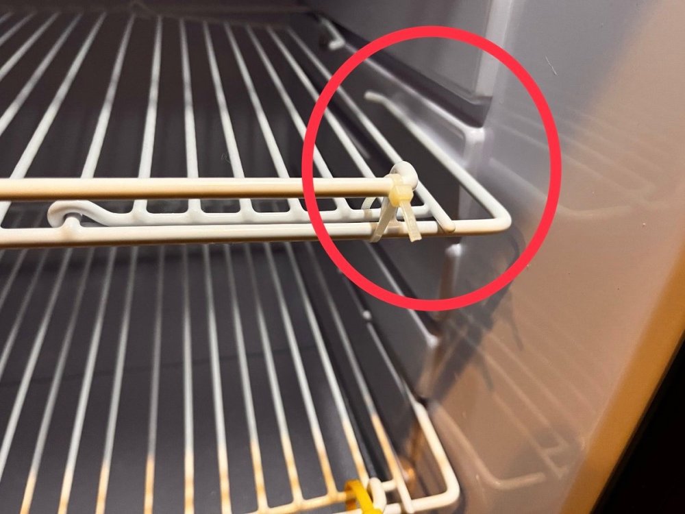

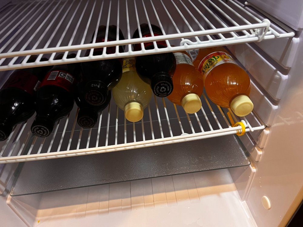

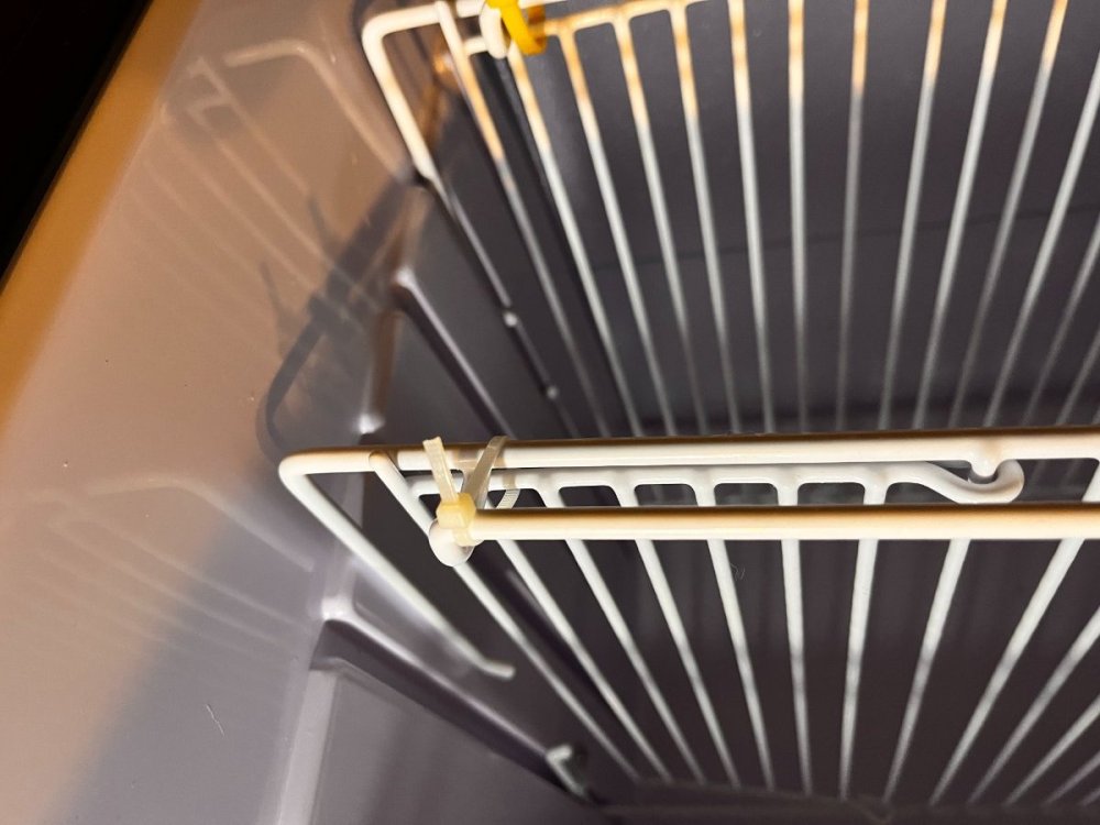

LeBill Posted May 12, 2023 Author Share Posted May 12, 2023 I may have a remedy...I reformed the shelves (bent them) to be much wider at the "forearm", causing them to not have a tendency to slide forward (out towards fridge door). Previously, they would slide out, such that only the "forearm" of the shelf was within the slot, the "elbow" was not supporting the shelf. The forearm would easily bend, and we'd see a collapsed shelf. Now, even though they are actually no wider, the shelves do not move fore and aft by themselves in the fridge, resulting in full support by the complete wire arms & elbows. I tested it in place with eight soda bottles (~8lbs) and they did not collapse under moderate jiggling. (sorry, I could not successfully flip over the two images...) LeBill Elite I Hull 1352 2021 Jeep Gladiator Northwestern NC (retired) Link to comment Share on other sites More sharing options...
John E Davies Posted May 12, 2023 Share Posted May 12, 2023 That is what I was talking about previously, your shelves are identical to mine. Those have to be bent outwards. You can clip those cable ties and then flip over part of the shelves so you can put three 1/2 gal milk bottles in there, resting on the strong glass shelf. That alone will take some load off the steel. A couple of 3 liter plastic juice bottle will fit too. And put drinks in the door… only light stuff up high. I guess we need to add all this stuff to this thread: https://olivertraveltrailers.com/forums/topic/8827-thread-for-isotherm-cruise-130-elegance-2-way-compressor-fridge-the-unit-used-in-2023-models/ John Davies Spokane WA SOLD 07/23 "Mouse": 2017 Legacy Elite II Two Beds, Hull Number 218, See my HOW TO threads: Tow Vehicle: 2013 Land Cruiser 200, 32” LT tires, airbags, Safari snorkel, Maggiolina Grand Tour 360 Carbon RTT. Link to comment Share on other sites More sharing options...
