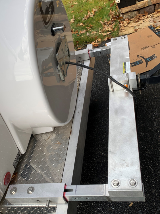

Rear Storage Carrier

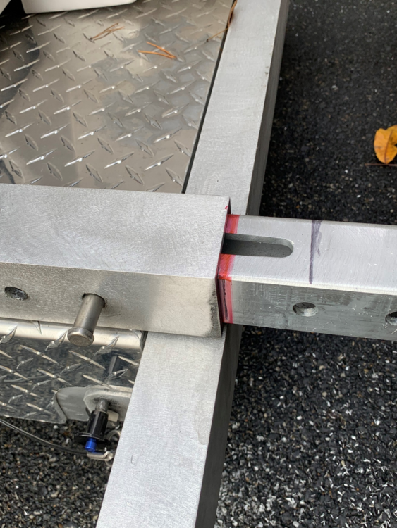

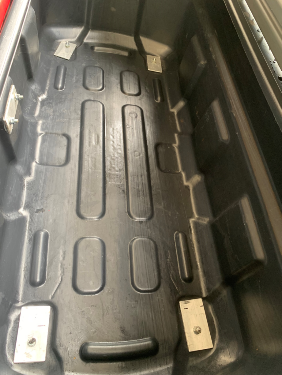

Since storage on the Elite is so limited and since my tow vehicle is a Subaru Ascent, not a truck, I’ve adapted some ideas I’ve seen on the forum that seem to be working well. I mounted a Rubbermaid ActionPacker 48 Gal using aluminum plates in the bottom and bolted it to a MaxxHaul 70422 48”x 21” Hitch Mount Cargo Carrier.  Together they weigh a total of 43 lbs allowing me to carry a little over 100 lbs and be under the 150 maximum for the hitch. I also measured how far I could slide out the carrier and get the spare tire out without removing the carrier. I drilled a couple of extra holes in the hitch that allows me to slide in a retention bolt on each side to prevent the slid out assembly from falling in case I have to slide it out on the road.  I did have to remount the license plate and a light that required extending the wiring.
image.thumb.png.60a522a0d634f8757d1bbc76736bcc1a.pngimage.thumb.png.a4d94ebafa223e0a5752ba9702d01e56.png

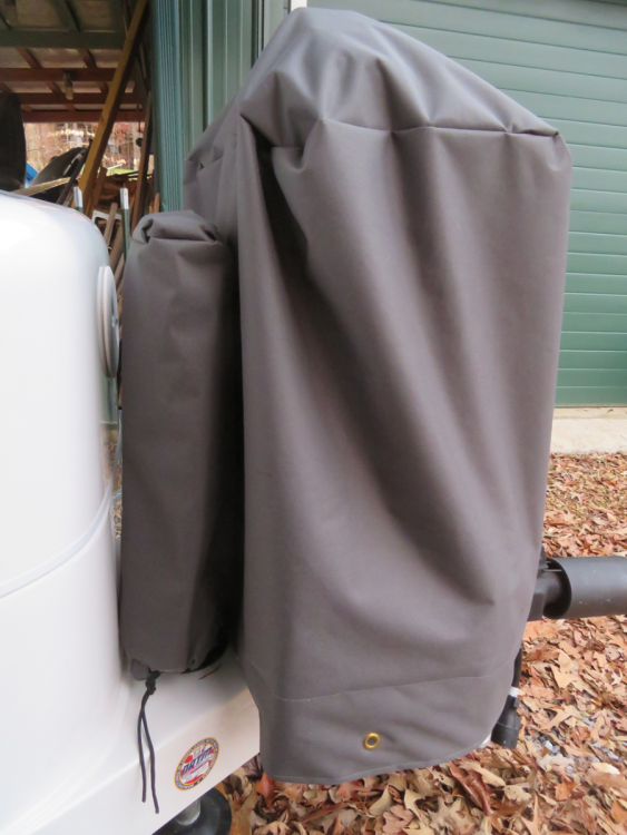

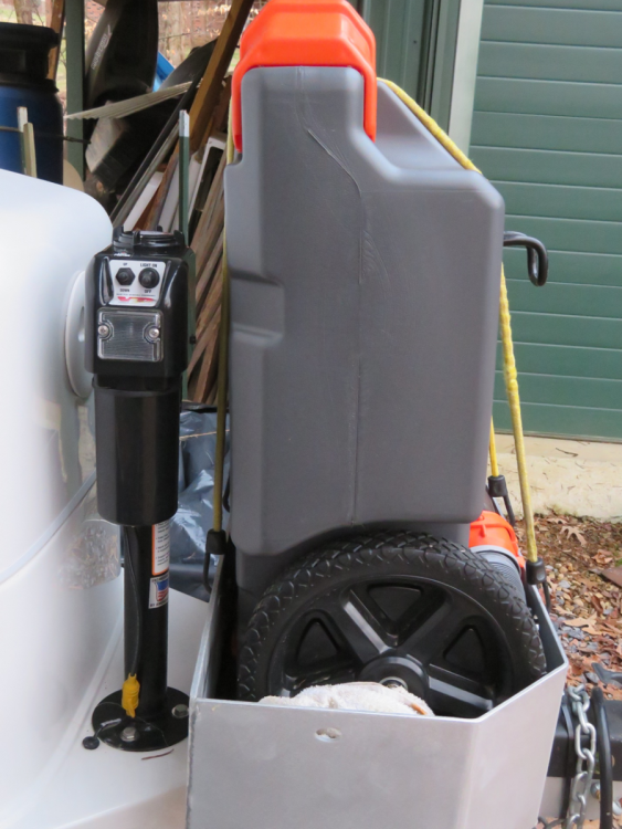

I also made some water/UV resistant canvas covers to protect the rear cabinet, jack, and front box where I carry my portable tank, mainly to protect the plastic from the UV.

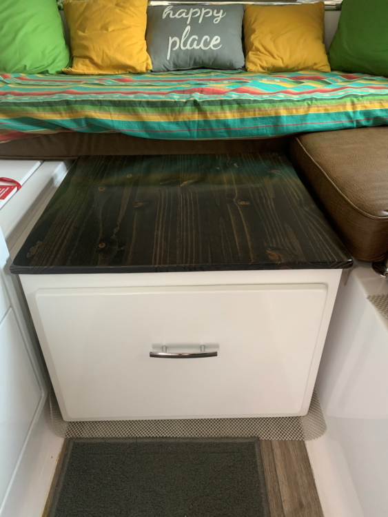

Since I’m a caregiver, I need to make it as easy as possible for me to easily access my wife’s clothes.  We have found that the single bed across the back works best for us in our situation, that I can leave up all the time.  I set up and take down my side bed.  We don’t need the large dinette, so I made a smaller version to support her bed and it frees up floor space. We were storing clothes in bins below the bed having to slide them in and out.  I decided to build a small cabinet that would allow us to easily access her clothes. It also serves as an extra countertop. I can pick up the cabinet for travel and set it on the floor.  I learned from other posts on this forum, that by setting things on shelf liners on the floor that nothing moves during travel. I’ve found that in the evening I can set up the fiberglass extention Oliver provided and use it like an ottoman.  With all the pillows it’s pretty cozy watching TV.  This wouldn’t work for tall people, but my wife is tiny and I'm fine sleeping on the side bed. I think most of you tall folks have the Elite II anyway.

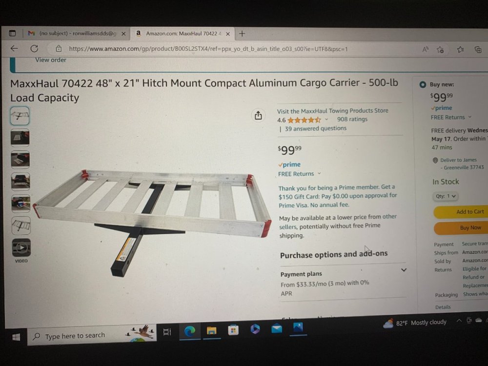

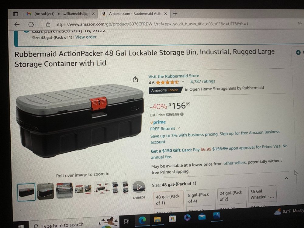

Very cool mods @Ron and Phyllis!  Especially like your rear cargo arrangement.  Can you give a link to the rear platform for the storage box, pls?  Thanks, brother!
Gladly, If you use the Maxxhaul 70422 Aluminum Cargo Carrier, it looks like the support connector fits a 2" hitch.  That's what I see on most of the carriers, so you'll need an adapter for the 1.25 on the Ollie.  I happened to have another carrier ( Apex ACC2-4820 Metallic Aluminum Cargo Carrier) that came with two supports for either 2" or 1.25". I used the Apex 1.25" support on the Maxxhaul carrier as it fit perfectly.  In a short search I don't see the Apex currently  available.  The box fits in either.  I think it's important to use some very large washers or plates in the floor of box when mounting to prevent cracking.  Now that I've used this for several trips, I think I'm going to add a small support chain inside connected to the lid to prevent it from going so far back when it's opened. All the other premade carriers I saw online were too heavy for the Oliver rear hitch or just didn't allow practically any cargo because of their weight. I uploaded screenshots of the box and MaxxHaul and hope you can open as I'm not sure how effectively I navigate around this forum.  Hope it's all ok.
Ron
