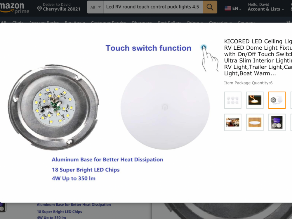

Ollie-Haus Posted May 28, 2023 Posted May 28, 2023 Here's one source on Amazon, many other choices but you have to make sure they are touch operated. Some only work from the switch source. https://www.amazon.com/Risestar-Ceiling-Interior-Lighting-3000-3500K/dp/B07TN6945F/ref=sr_1_1?crid=1KXMUHWEGLDGH&keywords=Led+RV+round+touch+control+puck+lights+4.5+inch&qid=1685286639&sprefix=led+rv+round+touch+control+puck+lights+4.5+inch%2Caps%2C103&sr=8-1 1 2 What's today?............. the most frequently asked question as a retiree 🙄 Chris and Stacie Neuhaus Greenfield, Indiana 2021 Ford F350 7.3L Tremor (Redzilla) LE2 #1373 - Ordered 10/21/22 - Delivered 05/10/23

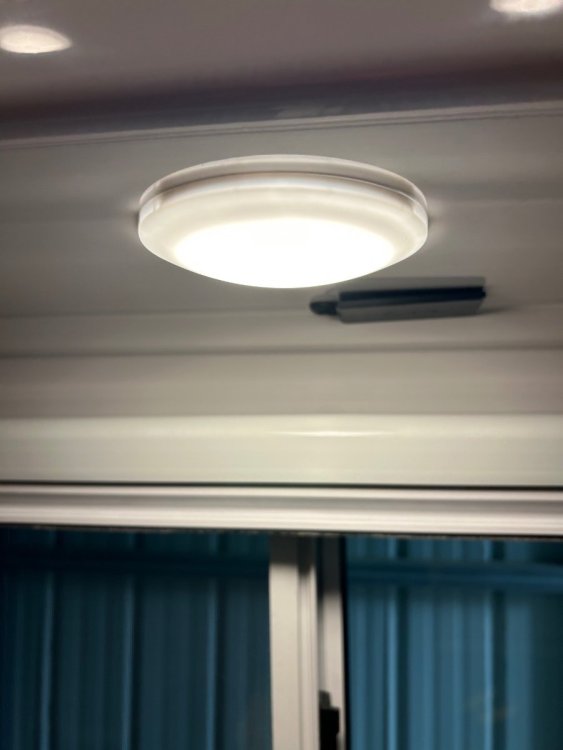

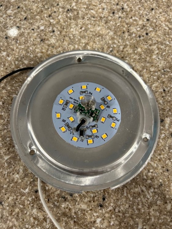

Patriot Posted May 28, 2023 Posted May 28, 2023 @Ollie-Haus Great find! I just happen to be replacing a touch light over the dinette. So I took a photo of it. Thanks for posting the Amazon link as they look petty identical. Probably the same company in China just a different supplier. I purchased (3) spares on our recent trip to Oliver. I hope this replacement lasts! This is the third touch light I have replaced. 😏 Oliver TL Amazons version - 1 4 2020 OLEII - Hull #634 aka- “XPLOR” TV 2021 F350 6.7 liter Diesel Lariat Ultimate Tremor aka - “Beast of Burden” Retro upgrades - Truma Aventa 13.5 AC, Alcan 5 leaf pack, Alcan HD shackles & HD wet bolts, 5200lb never lube axles. XPEL 10 mil PPF front both front corners, 30 lb LP tanks, Sea Biscuit Front Cargo Storage box. North Carolina 🇺🇸

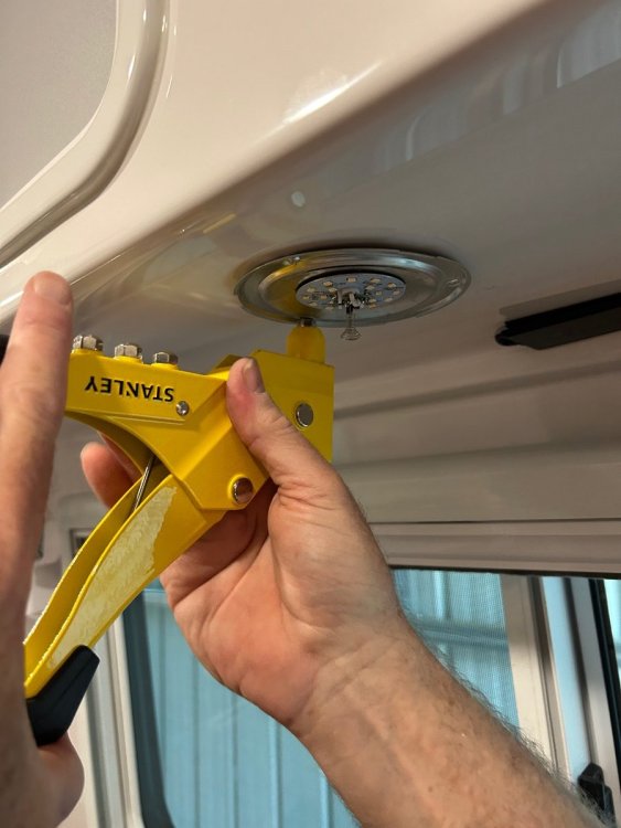

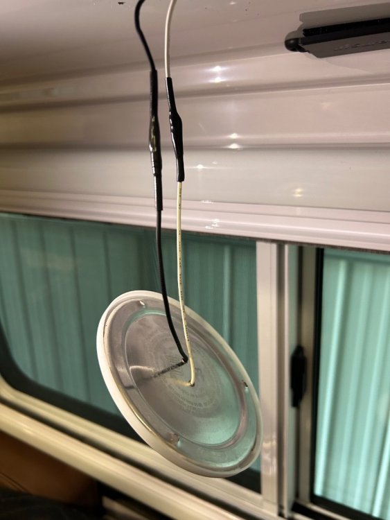

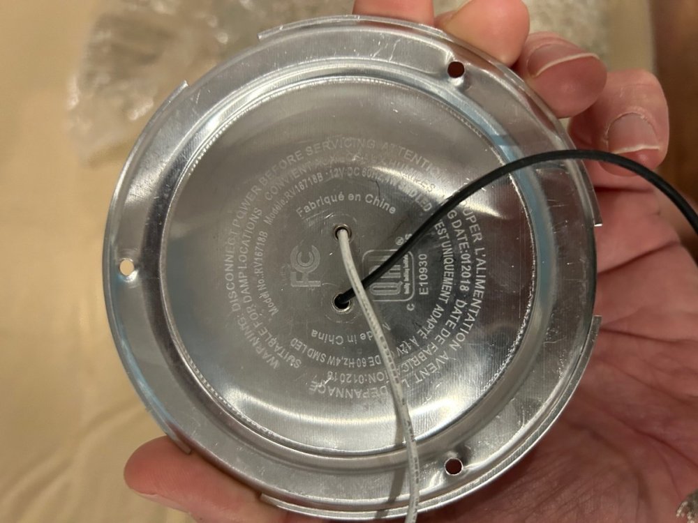

Patriot Posted May 28, 2023 Posted May 28, 2023 Touch light replacement just completed over the dinette. It’s important to note that the TL’s I have replaced have all been working fine. I do hope Oliver finds a higher quality touch light. These are cheesey at best. Hopefully they will last. Loosen the light cap by turning and remove it. Drill out the existing rivets, cut the white and black wire as close as you can to the old light. This will leave you plenty of wire to connect your replacement. Connect the new TL wires by braiding the wire ends to each respective color. I used electrical tape and heat shrink tubing for the finish. Tuck the extra wire back into the wire opening in the hull ceiling. Install the light base with new rivets and attached the light cap. When using these touch them gently. Don’t ask me how I know. 😎 Let there be light! Patriot🇺🇸 Pics- New light with heat shrink tubing. If for some reason you need rivets you can purchase these at Ace HW. They work fine. 2 4 2020 OLEII - Hull #634 aka- “XPLOR” TV 2021 F350 6.7 liter Diesel Lariat Ultimate Tremor aka - “Beast of Burden” Retro upgrades - Truma Aventa 13.5 AC, Alcan 5 leaf pack, Alcan HD shackles & HD wet bolts, 5200lb never lube axles. XPEL 10 mil PPF front both front corners, 30 lb LP tanks, Sea Biscuit Front Cargo Storage box. North Carolina 🇺🇸

Patriot Posted June 5, 2023 Posted June 5, 2023 @bsullivan I use a small cordless drill and drill bit small enough to just remove the top of the rivet head and then push the remaining part of the rivet shaft up into the hole with a small awl or finish nail if you don’t have a tiny awl. You cannot drill the rivet out as it will spin in the hole. The extra rivets should come with your new touch lights if you order them from Oliver. Note: makes sure when you remove all (3) rivets and the light drops down from its mounted location that you cut the wiring as close as possible to the old light. This will give you plenty of extra wire to work with when installing your new TL. If you need further guidance send me a PM and I call you and be glad to help walk you through it. You need - 3 new TL, a small drill, a small drill bit, electrical tape, shrink tubing, a lighter to heat the shrink tubing, wire strippers, and patients. Take your time, you can do it!👍🏻 Patriot🇺🇸 1 2 2020 OLEII - Hull #634 aka- “XPLOR” TV 2021 F350 6.7 liter Diesel Lariat Ultimate Tremor aka - “Beast of Burden” Retro upgrades - Truma Aventa 13.5 AC, Alcan 5 leaf pack, Alcan HD shackles & HD wet bolts, 5200lb never lube axles. XPEL 10 mil PPF front both front corners, 30 lb LP tanks, Sea Biscuit Front Cargo Storage box. North Carolina 🇺🇸
