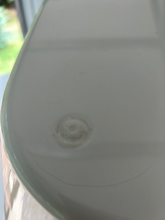

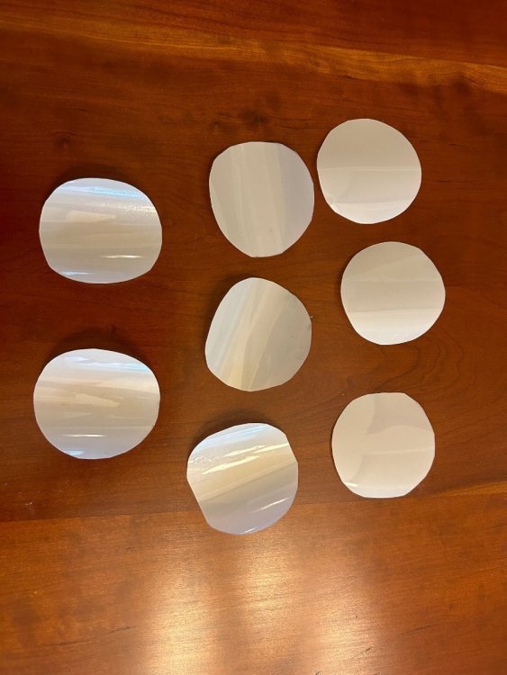

I learned from Oliver Service that the Truma Aventa has a design flaw where the (8) fasteners that hold the AC cowling/shroud in place will hold water when it rains. This could result in a leak if the cowling screws are torqued too tight and the plastic cracks.
Oliver has made Truma aware of this concern and has also taken steps to preempt water intrusion issues with the counter sunk screw holes by adding a self leveling sealer to each counter sunk fastener hole in the cowling. (See in pics)  All new Olivers with Truma Aventa AC units have this self leveling sealer installed at the plant.

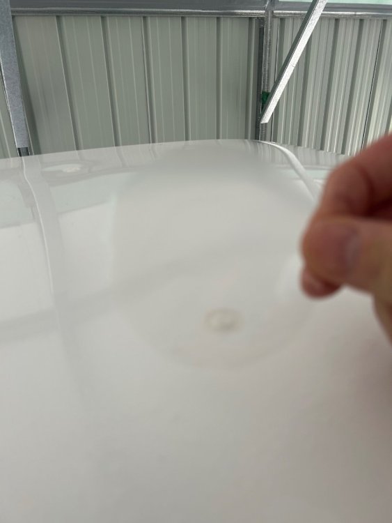

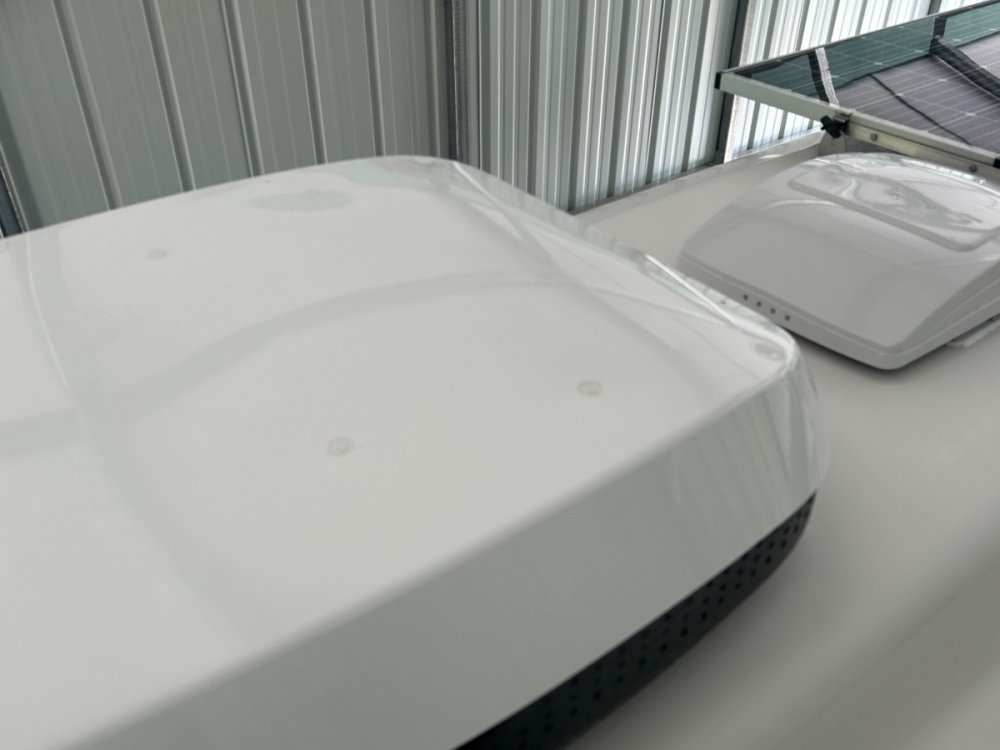

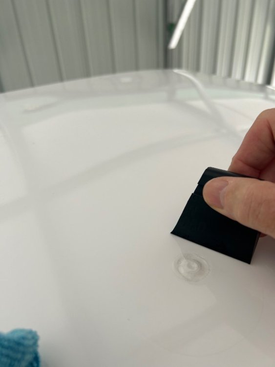

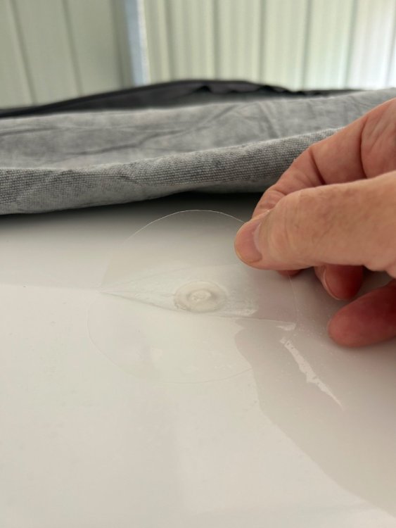

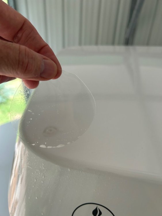

Today I opted to take sealing these counter sunk fasteners to the next level with some 8 mil XPEL paint protection. I cut 8 small circles of the XPEL PPF and simply covered each of the 8 fastener holes. It took longer to trace and hand cut the 8 small circles from my PPF than to do the install. This PPF can easily be removed for access to the screws and then removal of AC cowling. The PPF will completely prevent any water intrusion issues even if the self leveling sealer should fail. I also covered the Truma side decals in PPF to prevent weathering or peeling over time. The PPF also has a UV protection which should also help keep the sealer from degrading under normal full sun light. This XPEL PPF is very tough material. We have had it installed on our cars, trucks and even 10 mil sheets installed on the front of our Ollie with excellent protection results.  Mod On!!
Patriot🇺🇸
A few pics -
These pieces were cut from scraps of 8 mil XPEL I had in my shop. Once installed they disappear.

Good anti-water intrusion fix...
Edited by MAX Burner
Changed post...
  • (SOLD) 2022 TUNDRA
Thanks Max, 😊
Indeed this quick and easy mod along with proper torquing of the cowl fasteners will remove the concerns of ever having to think about water intrusion. 👍🏻
