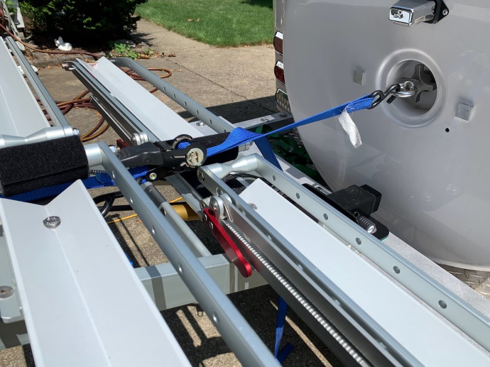

I know that some of you have had the basement back wall out. And I've looked at those, but can't see deep enough. What, if any, support backs up the spare tire mounting 5/8" threaded rod? I'm using a ratchet strap to take the slop out of the bicycle rack system, and if there's only a big washer behind the wall, I don't want to pull the whole thing through!!
I looked at the limited photos I was allowed to take from our plant tour, but didn't have this area of the outer lower hull. I'm hoping that there's a support welded to the frame, or at the very least, a large plate embedded in the fiberglass.
Thanks!
NOTE: For actual use, I will have a threaded carabiner in place of the steel hook to avoid it coming off on a rough road.

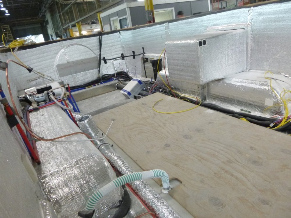

Do these pics help you?
Keep in mind that the hull moves around on the frame, you can secure the rack to that tire rod, but you need to add some give to the strap. It certainly cannot safely be tightened completely. How about a heavy line with a rubber dock line snubber?
I personally think the bikes should be guyed hard to the trailer frame. Could you use two straps secured to this point on each side, with two tie down rings? Or heavy pieces of 2x2” aluminum angle with holes drilled.

Yes, sir. Thank you. That looks like a substantial support.

Thanks, John. I hadn’t considered hull movement in relation to the frame. I figured those rubber mount pads were pretty stiff, and the whole thing solidly mounted. Thinking about it, that would transfer a lot of twisting stress to the hulls.
I do have a snubber of sorts. It is a motorcycle strap that has an internal stretching component and adjustable strap. Probably. It enough tension, though.
I like the idea of the eyes on the frame extension. That should be easily doable.
I found the rings on Amazon by searching for “5/8 eye nut” and then limiting my choices to stainless steel and next day delivery (we’re heading out again Thursday morning.) If I could have waited I’d have gone with a less expensive option.
Thanks!
Steve - Northern Ohio, USA
Facebook - Instagram

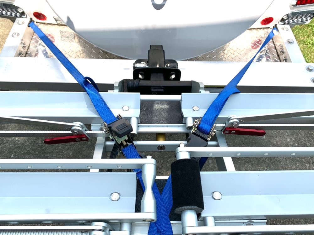

20 minutes later: Nope, that’s not going to work. The ratchet from the end of the two receivers to the highest solid spot on the bike rack is almost perpendicular to the movement. So while the ratchet is very tight, it didn’t reduce up/down movement at all.
Back to the ratchet to the spare tire mount. Now that I know there’s a solid plate inside, I cranked the ratchet tight, and it took up all the slack. And there’s enough stretch in the webbing to allow a bit of downward movement. I think I’ll try that on Thursday. Smooth interstate almost all the way, so it shouldn’t be unduly stressed, and I’ll check often.
