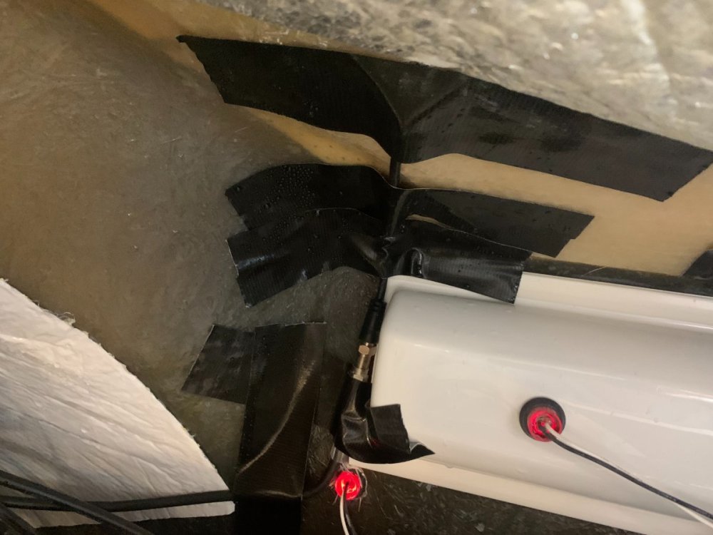

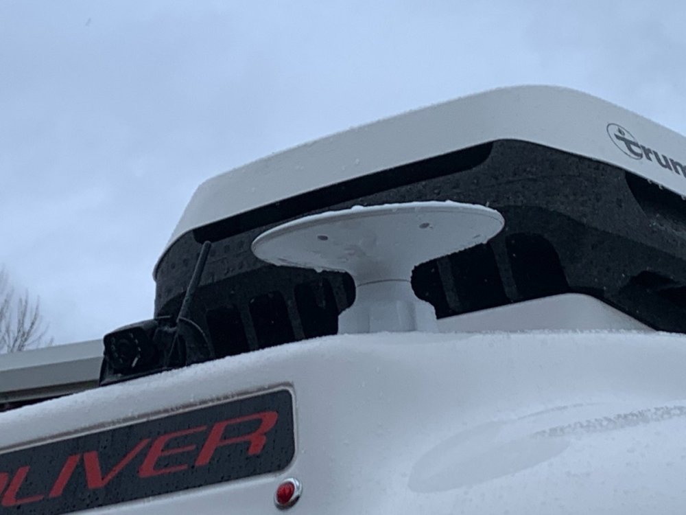

Just to give you some food for thought, here are a few pictures showing where Oliver ran their lines.

Antennas work best when they are installed with a 360-degree unobstructed view. The install shown above on Jason's Oliver will work fine anywhere in East Texas (not West Texas), along the coasts, near the cities, the major TV markets, but you can see how about 150 degrees out of 360 is being blocked by the Truma A/C sitting well above it in height. This install will have reception issues in the distant areas of the West, when you park your trailer in the wrong direction.

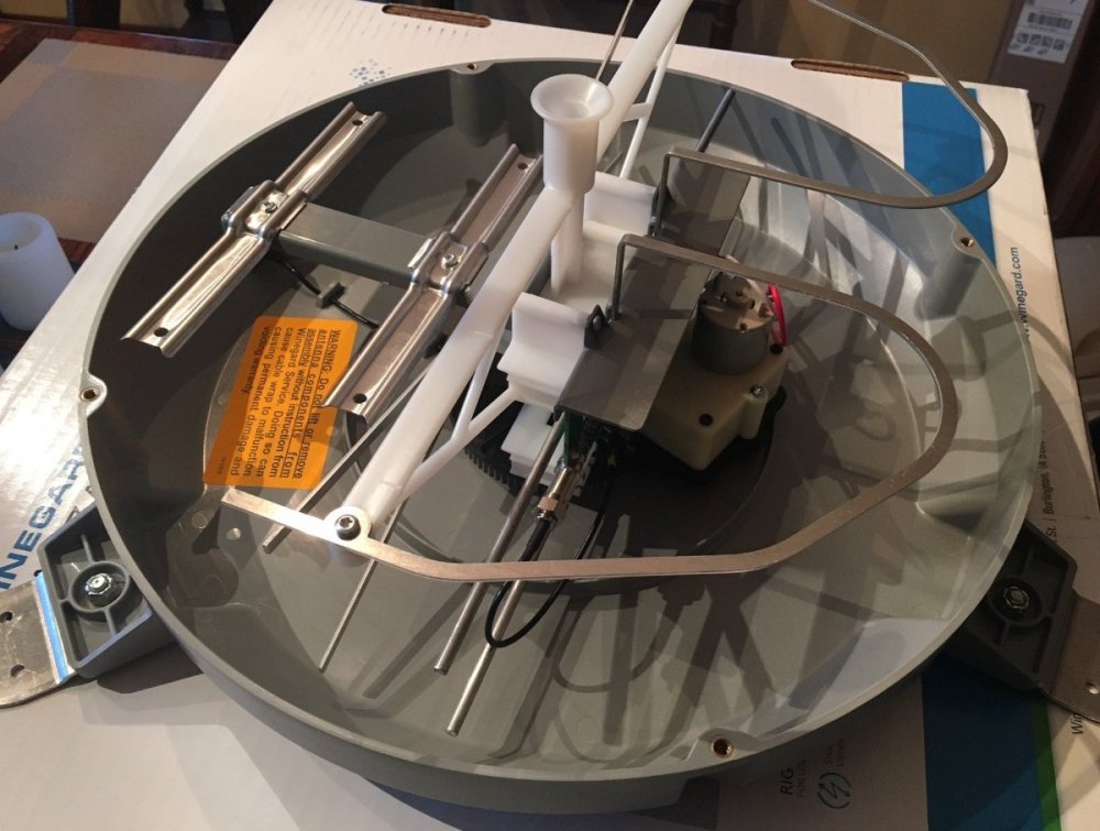

The antenna I have is designed to sit on a flat horizontal section of an RV roof with 2 FT clearance around it (not happenin' on an Oliver). This smart antenna senses the direction for the strongest signals and rotates automatically (see pic).

I'm now thinking of a sheet metal shelf that would sit closely just above the shroud, bracketed to the A/C steel frame vs. mounting directly to the shroud. At this time, I'd rather drill and mount several bolts into the A/C frame than into the fiberglass. (Note the white plastic cover is removed from the antenna in this picture.)
