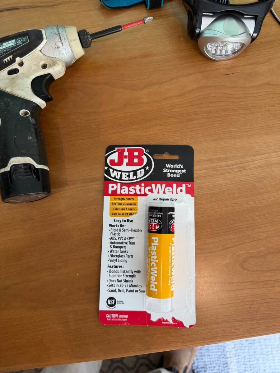

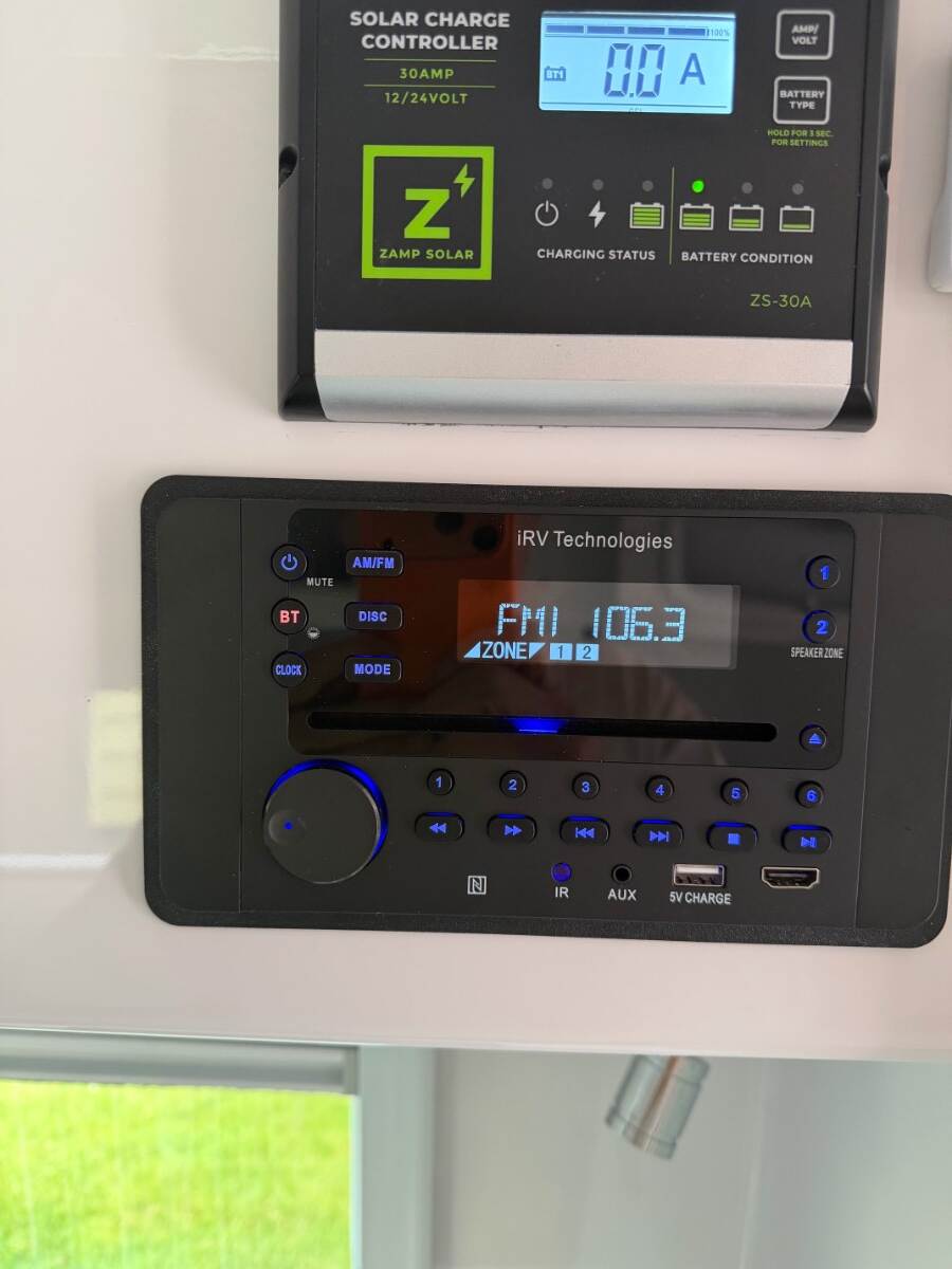

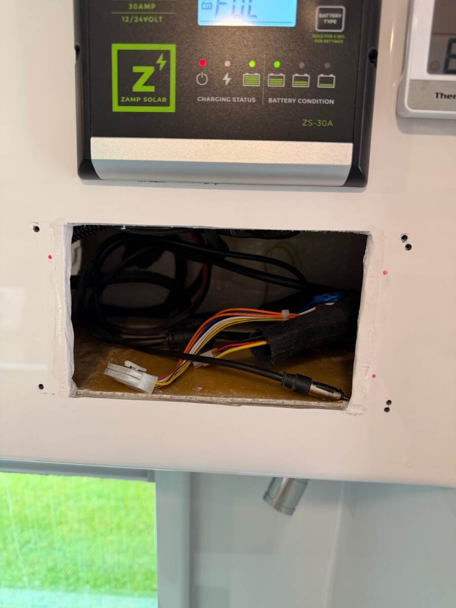

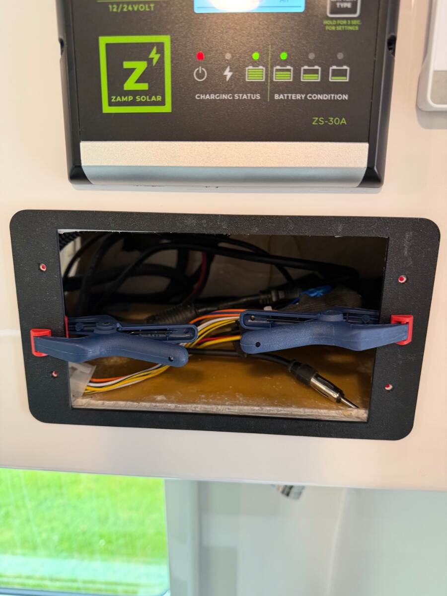

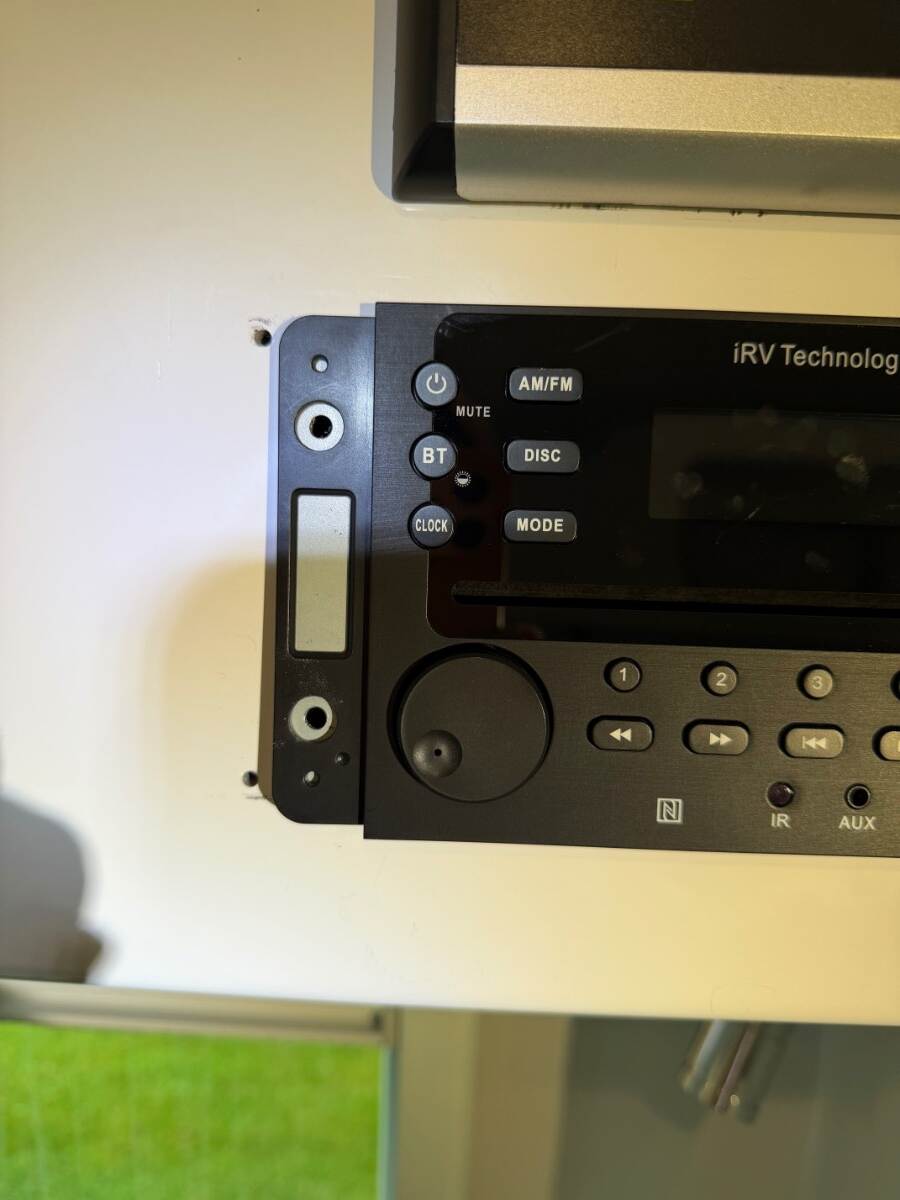

There are not many decent replacements available, but the iRV RV62 was a good fit on paper. However there were fitment issues because Oliver miss-drilled the Furrion mounting holes so they weren't covered by the IRV faceplate, and the Furrion opening was cut to large so that the IRV mounting screws were on the very edge of the cutout. This was fixed with white JB weld to strengthen the edge holes, and a 3-D printed Bezel to cover the miss-drilled holes (can hardly tell there is a bezel in the picture). Let me know if you need one, I made extras. I'll probably do a post on the modification pretty soon because just the improvement of the controls makes it worth doing. BTW, I'm also annoyed by bright LED's, to the point where I posted a modification on how to dim the main panel switch LED's with in-line resistors. It's called something like "I was awakened by flashing blue lights." The IRV unit goes dim when off, not too annoying at all. Cheers! Geoff -
