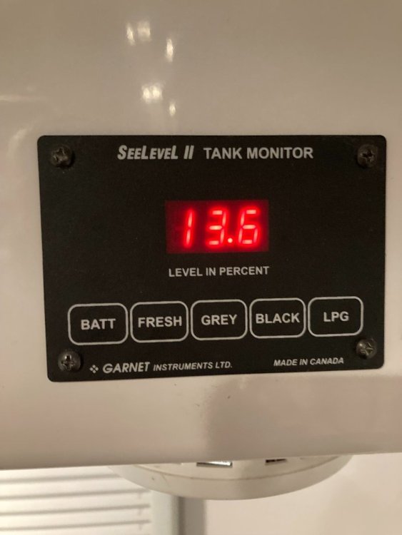

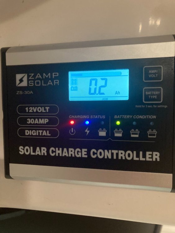

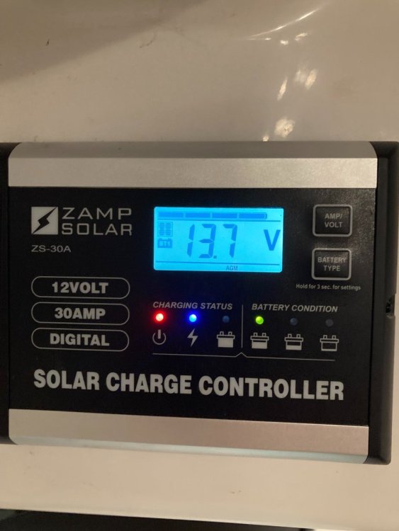

Upon shore power inspection this morning the controller read 13.7 and the tank monitor read 13.6 I unplugged the trailer and will monitor throughout the day whether the batteries hold or not. Nothing is running, no lights or fans. One concern was the ah readout which said 0.2. Shouldn't that reading instead represent a full charge after being plugged into shore power for over 12 hours? Hmm -

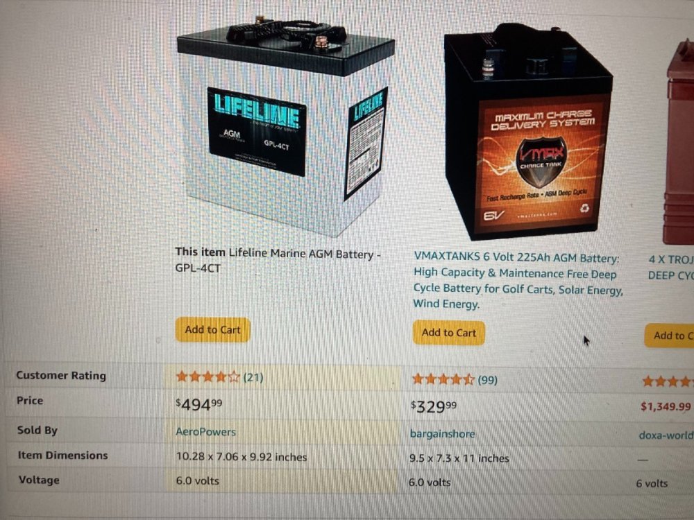

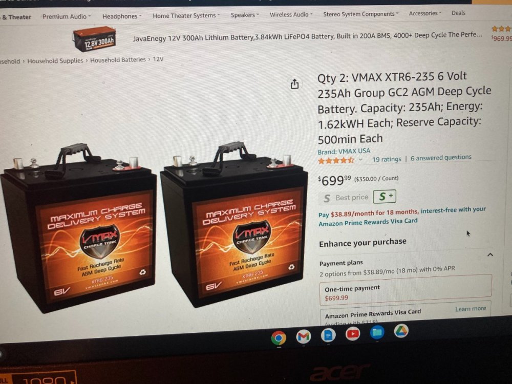

I am certain my two factory installed Llifeline gpl-4ct agm batteries need replacing as they won't hold a daylong solar panel charge. (My shore power is out at the moment.) I get them up to 11.1 Volts and within two or three hours they are down to 7 and slipping fast. What are the best replacement batteries for these two? I saw on amazon this option VMAXTANKS 6 Volt 225Ah AGM Battery: High Capacity & Maintenance Free Deep Cycle Battery for Golf Carts, Solar Energy, Wind Energy. I want to do what's best long term. I don't think I want lithium but will stay with AGM. Any suggestions or insight? (My elecrician still hasn't shown up. He says today.) I also saw this last double one but not sure if it is the right replacement. Ideas?
