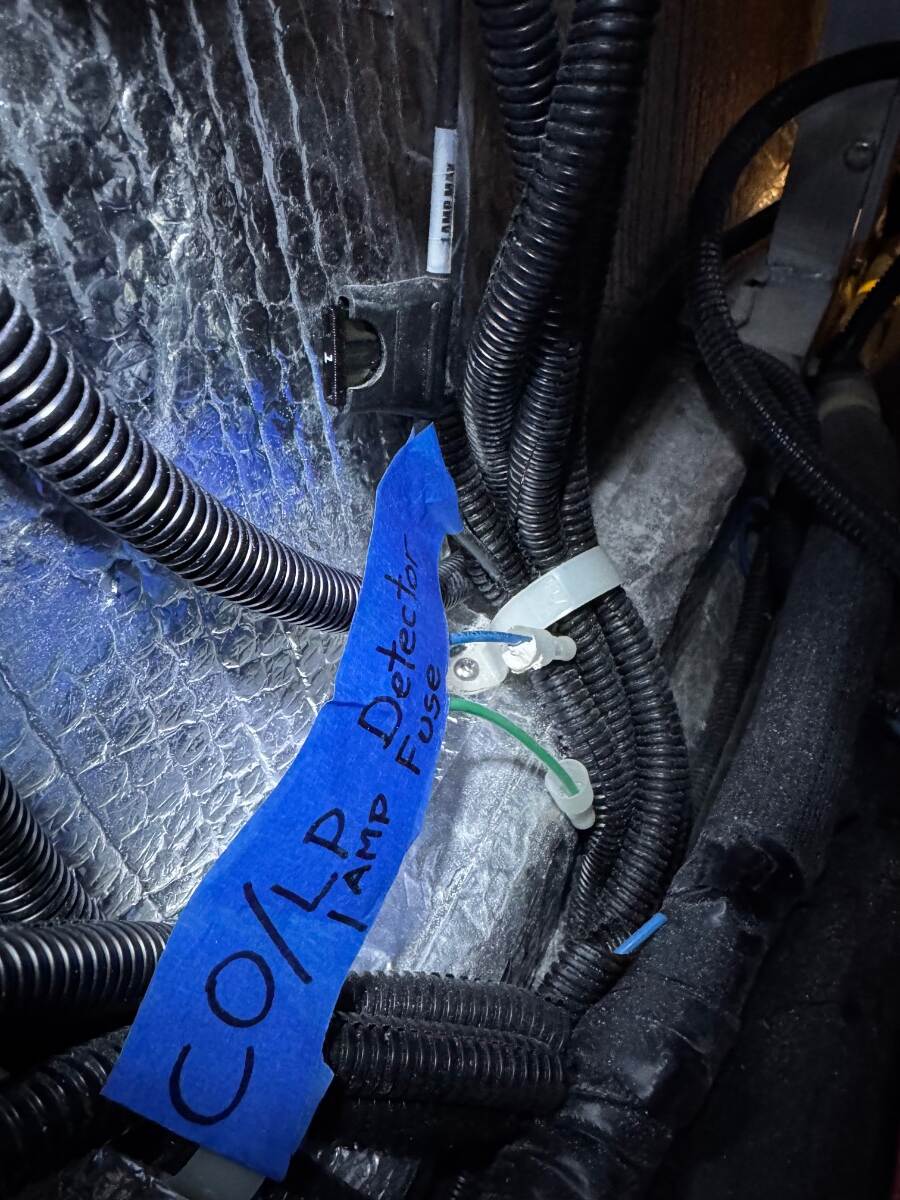

So… first thanks to each of you that responded! The CO/LP detector fuse is easy to find and get to (under street side bed)… IF YOU KNOW WHERE TO LOOK! I put a tag on it similar to what Galway girl did (Good idea!) I added another 1 amp fuse to my box of emergency fuses and also realized I only had one 30 amp slow blow inline fuse (for the three electric jacks)…. So ordered some more. The new detector looks good and the fun thing is it adds to my collection of little lights that reflect all around inside the camper when I find myself wide awake in the middle of the night. I like to think of them as “stars”. -

Thank you! I did find exactly that 1 amp (black blade type) fuse. Mine isn’t marked or anything obvious like yours but I will find a replacement 1 amp fuse for it. If that’s it, I’ve found it, but didn’t know it! Patriot pointed me in that General direction too… I’ll report back anything I discover. -

I couldn't exactly trace the very specific detector wire... but I did check the wires going into the back of the 12 volt panel... and also checked each ground wire on the bus bar to ensure they were all good and tight. I'm a little bit out of my "lane" doing electrical work... so I called an electrical inclined neighbor to confirm my steps and he was stumped as well. Side bar: It's good to hear from you Bill... you are still looking good! 🙂 -

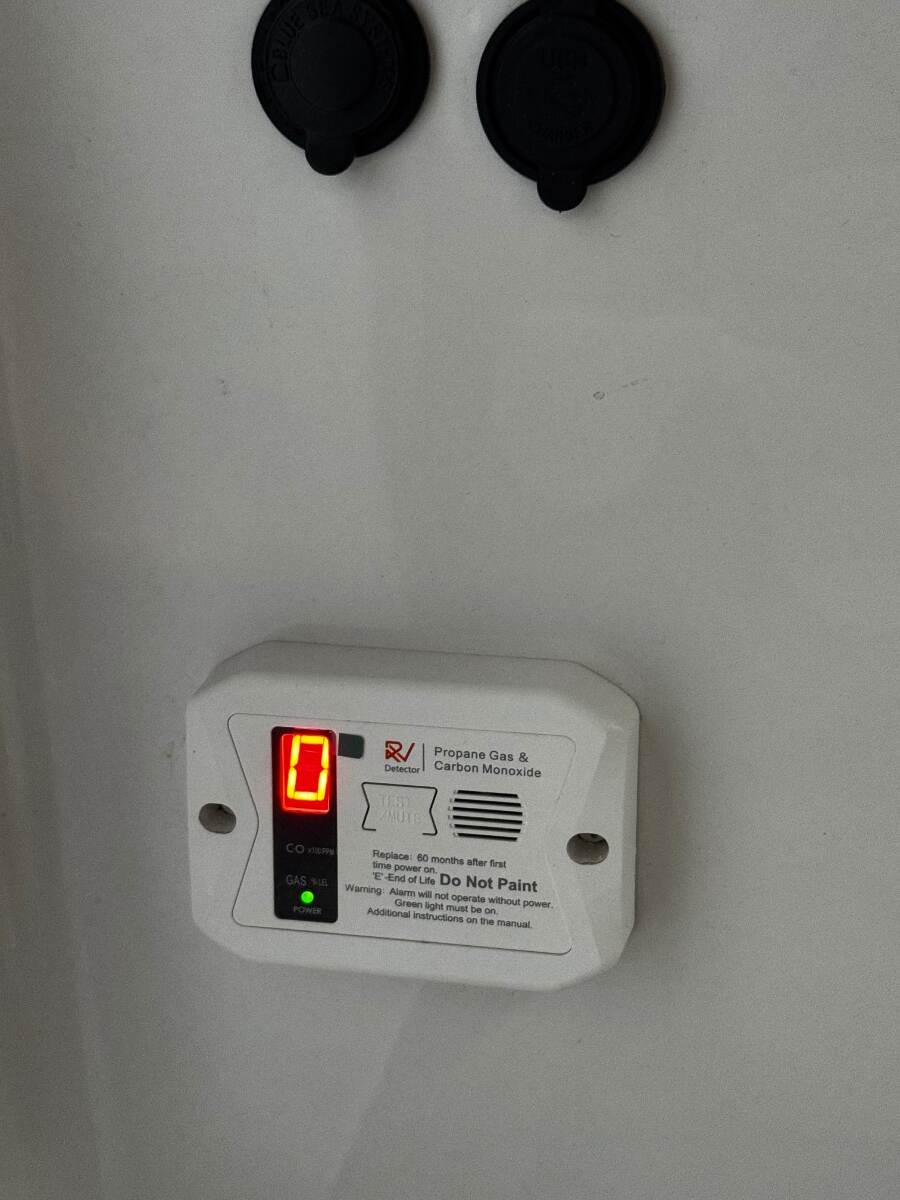

It's been a while since I've had to ask for some help... but here we go tonight! Prior to putting our Oliver away for the winter... the CO/LP detector seemed to be getting more and more "hyper sensitive" to the point where it finally just wouldn't go off. I reached under the front dinette seat and had to cut the positive wire to stop it. Plan was to simply replace it with a new one. I get the new one and now I find that the wires going to the detector (the ones I cut) do not have voltage. I had a friend confirm my findings and we checked every 12 volt fuse and everything was fine (there is no fuse specifically marked for the detector). Everything else, 12 volt in camper seems to be working fine... including the little USB plugs and all the lights. Anyone have any experience with changing out the CO/LP detector? Clues or ideas? I did try to jump start the the new detector just to confirm that it works but was unsuccessful in that. It seems highly unlikely that the brand new detector is "bad".... especially considering the OEM installed wires going to the old detector appear to be dead.
