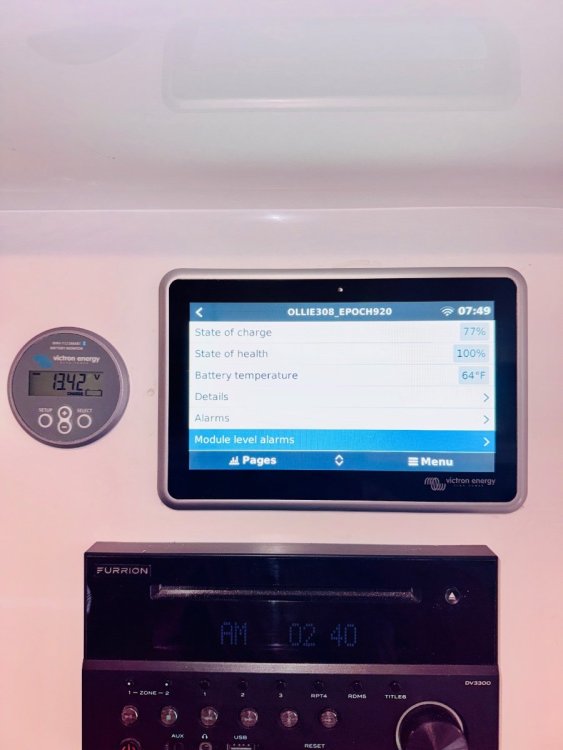

Victron MP2 with (2) Epoch 460ah batteries. DAY #1 Removal, rewiring, mounts, routing wires
Why the multiple control/indicator screens?  Will the GX Touch not do everything you need, or was this just to fill previous holes in the walls?
Top right is battery indicator in red supplied by Epoch (quick visual). Under that is the Victron toggle for inverter and power assist control. Old Zamp controller area is for GX display. 2 green buttons inside pantry are remote battery shutoffs.
Thanks.  I was referring to the BMV and Multi Control.  Are they not redundant with the GX?  Only asking because I am headed down the same path fairly soon.

No, they are not redundant both do specific functions that you cannot do with the GX. So in my opinion necessary to get full functionality with Victron system. The only thing that might get rid of smart shunt and BMV is if you use Epoch batteries because their BMS communicates with Victron via BMS Bus on Cerbo or the VE. Bus on the Ekrano. I can't confirm how well that works yet because I installed the Ekrano and I am waiting on a cable that converts CAN bus to VE. Bus. So Epoch batteries BMS is not talking to Victron yet.  Doesn't matter if you're using Cerbo GX it will work but Ekrano not sure yet.
So after finally getting the Victron and Epoch batteries talking and getting use to all the settings via the VRM online I would agree that the BMV and Multi Control are redundant. But redundant in the way you have volume control through software and a physical volume knob. I would still install the Multi Control for the immediate physical control but not sure about the smart shunt or BMV because of the built in communication EPOCH utilizes. Hope this helps.
