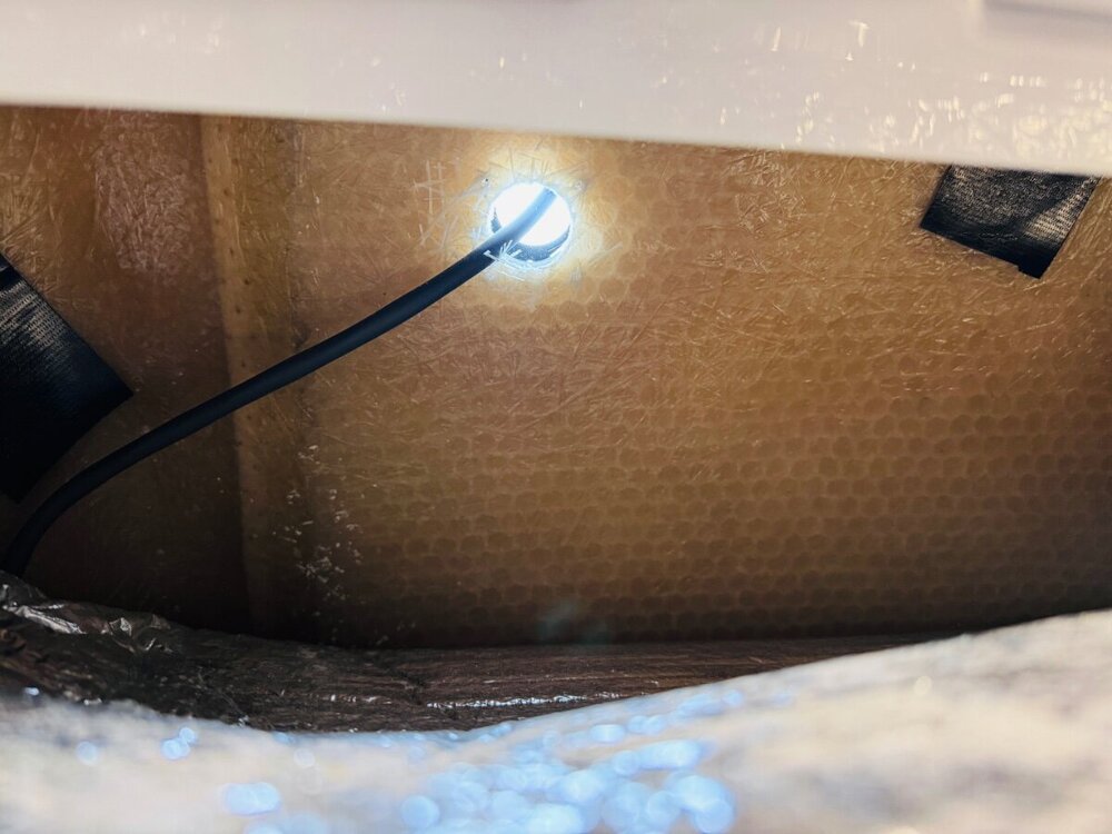

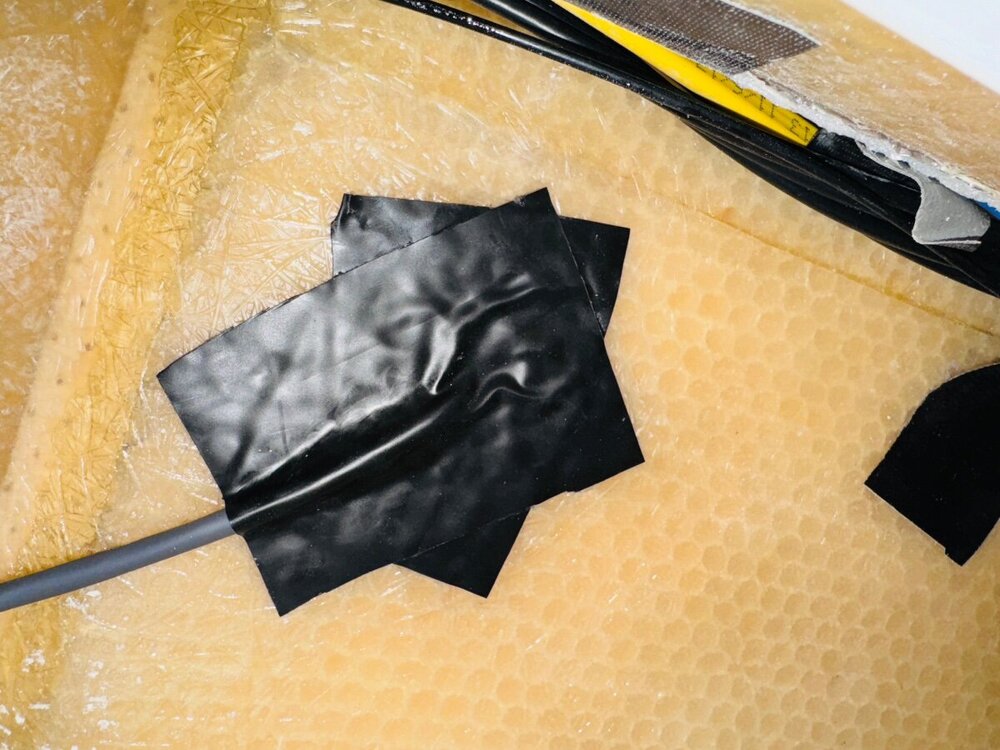

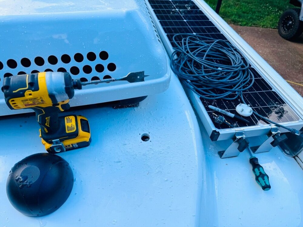

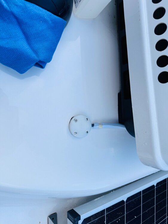

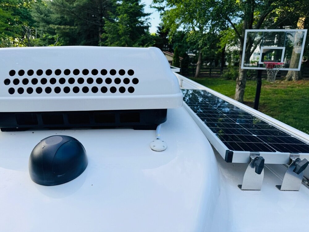

Chose to drill a 1" hole next to the one for the Cradlepoint antenna. Used a Blue Sea's clam filled with Dicor caulk. Finally, got to use my black Flex tape to bottom out the hole I made so I could fill it with caulk sealant. In transit is a Trio Flatmount with rubberized magnets and swivels leg mounts attached to place on roof with VHB metal disks for a semi-permanent attachment to the front area of roof behind the Maxx-air vent.

Chose to drill a 1" hole next to the one for the Cradlepoint modem. Used a Blue Seas clam filled with Dicor caulk. Finally, got to use my black Flex tape to bottom out the hole I made so I could fill it with caulk sealant. Waiting on a Trio Flatmount with rubberized magnets and swivels mounts to arrive for semi-permanent attachment to front area roof.
Very nice! Of course, magnet mounts won't hold to fiberglass. The video mentions other options. You wrote "semi-permanent attachment." Not permanent?
Long cable run up to the front. Did you consider mounting it somewhere in the rear or even on the AC cover? I imagine it doesn't weigh very much at all. I see why you suggested a flat roof in another post! 😂
You VHB 4in round metal disks that the rubberized magnets on swivels legs attach to and then you can remove it easily for cleaning or land use, etc. Also, I wanted to use the legs so I could get a couple inches of height and use a M6 bolt sleeve to raise the rear to give the dish an 8-10 degree slant for water shedding (similar to the OEM RV mount). Of course, you can easily permanently mount it flat using VHB or screws if you wanted to, lots of options. No room in the back to place it due to AC blockage and Cradlepoint external antenna on my application. I did consider placing it on the AC shroud and could easily trial it due to having the magnets and VHB metal disks. My gut feeling is that the shroud is not strong or stable enough plus I don’t want to catch it on anything if it is the highest point on the RV.

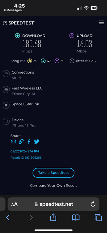

Internet speed testing has been great so far, anxious to see what the numbers are once I am traveling on the interstate.

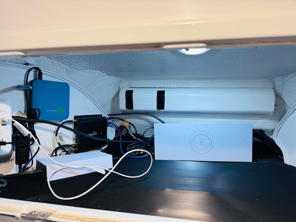

So unfortunately not good reception in the Tundra on the way down but I might get a second router to place in the front closet. If I had to do the cradlepoint modem and and antenna install originally I might have put it in the front closet so that the reception driving down the road would have been better. Maybe second router can work as an extender. Way down on the list at the moment.

Mike, you don't want 2 routers, because then you have two logins, need two antennas, splitters are not good, and more issues. What you need is a Wi-Fi access point. Then you would run ethernet cable from your CradlePoint router to some forward cabinet position.

It's better if the access point is physically in your truck. You can run Ethernet from the attic to the basement, all the way front to the hitch area. Like many have run with their DC-to-DC cabling. Then another leg of Ethernet under the truck to the interior. Mount the access point behind the rear seat like I did my router install. It runs on 12VDC, so you will have to pull a run from the truck fuse panel, likely by the driver-side kick panel.

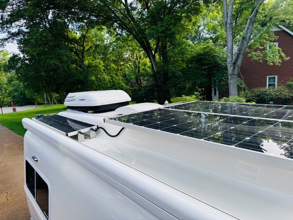

Maiden voyage with Starlink went great. SO nice to have a fast internet connection remotely. Magnetic feet on metal VHB'd discs worked flawlessly at 70mph in windy conditions. Didn't move a bit, despite being out front with no wind buffering.
@rideadeuce Mike, I'm wondering re your extra solar panel.
What make/model? Do you recommend? It does look HD/thick, like a lighter/thinner panel might be enough at that narrow width. Please let me know.
I'd like to add some solar eventually, mounted on an angle, in that area of the roof. Did you just tie them into the junction box under the OTT installed panels?
I know they make the make connectors like these for that purpose. Thanks
1 Pair, Solar Connectors T Branch Parallel Adapter Cable, 1 Pair 10awg Waterproof Solar 1 To 2 Solar Panel Connectors Wire Plug Tool Kit For Solar Panel (1*m/ff+1*f/mm),temu

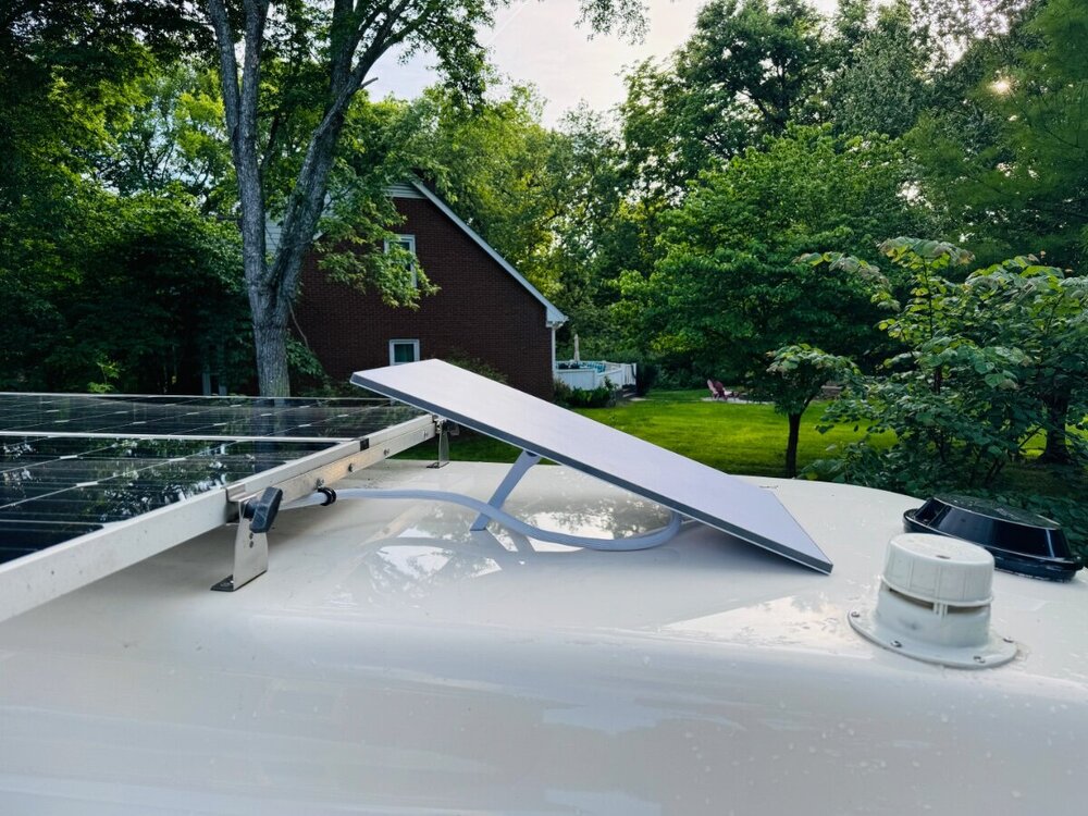

I used the OEM Zamp panels (90 watts each) to make it easy due to the SAE (reverse polarity) connection. There is an empty SAE connection at the junction box under the main panels, so super simple to add. I think I used a SAE Y-combiner to connect the 2 panels  (I would have to look). I got the mounts from Amsolar.com. But you are right there is lots of lightweight, flexible options these days. I have thought about changing the whole solar array but due to lack of flat real estate on the roof I have decided to keep what I have. So if you want to keep it simple and plug and play, I would still just go with the Zamp panels.
