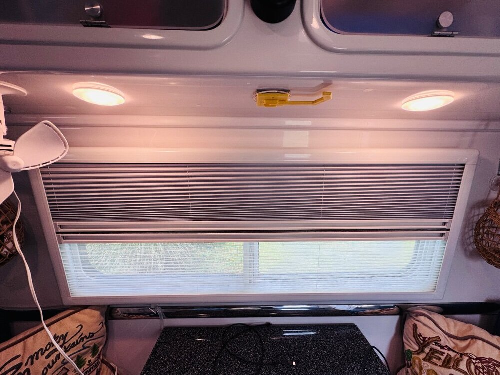

On our 2022 the shade just clips onto the wall. A firm tug on the bottom to release it, then remove it from the top clips. Snap it back in upside down to have the blackout on the bottom.
14 hours ago, RichM said:
Is it possible to orient the window shade so the blackout comes up from the bottom?
Yes.  We reversed the shade at our dinette.  Just pop off, turn it over and pop it back on.  Mike
Yes but because the blackout shade/frame is a little heavier it seems to fall down easier when positioned bottom => up to close or just the frame rides better in bottom of window position. I have used them both ways. I actually prefer the blackout shade on bottom but because it opens easier traveling I tend to use them closed/blackout with frame resting in down position.

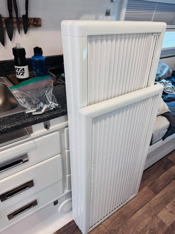

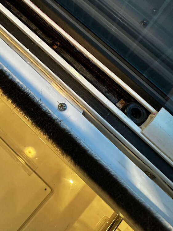

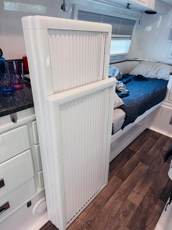

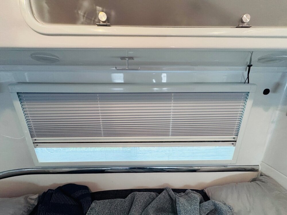

Fix for falling shade frames.

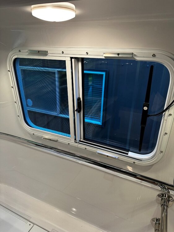

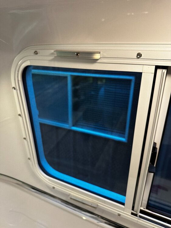

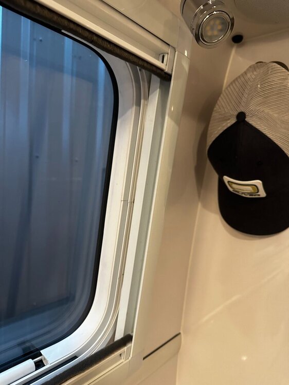

I tried replacing the clips and applied silicone to help hold. Nope. The large shade frame fell off again on the last trip so I was determined to do something different. The shade frames will never fall off again.

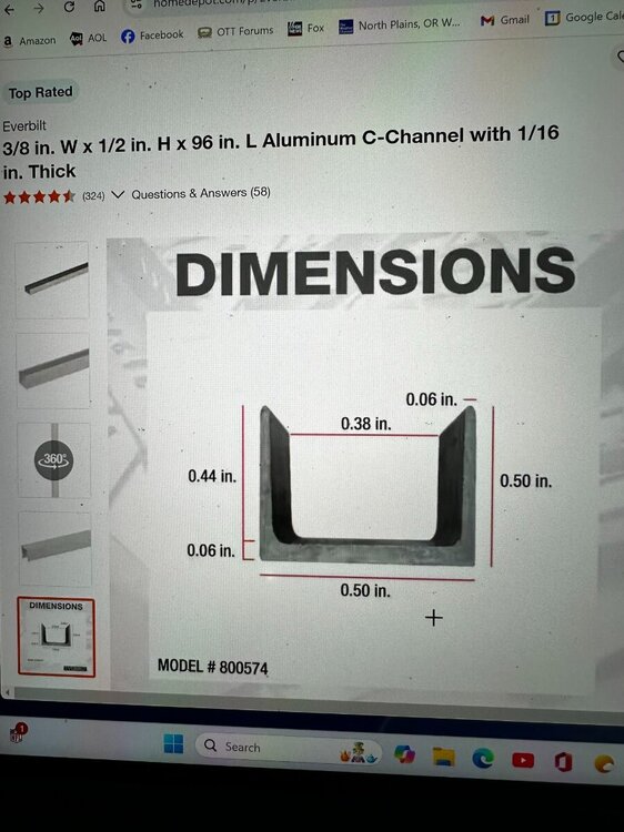

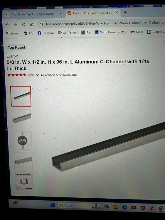

I removed all of the clips and their spacers. Cut and installed 4" long sections of aluminum c-channel purchased from Home Depot using original screws along with blue Loctite. Then placed the frames back on, drilled and attached the shade frames with #6 stainless steel screws.
Fitment is perfect. Hope this helps others. Photos attached.
