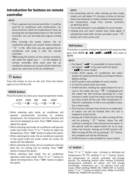

rideadeuce Posted July 14, 2024 Posted July 14, 2024 (edited) 23 hours ago, Ronbrink said: It is my understanding based on reads that one setting is made, wherein the unit will maintain that set temp as cold or heat is needed. Also looking forward to the outcome of @rideadeuce’s install and first impressions, as well. I lost contact with another owner on FB that made the first purchase of an Atmos 4.4 for his Oliver. I would think that install has been completed by now, but no subsequent report to date. Me too. My install is coming up on Wednesday. The first Atmos 4.4 bought for an Oliver was returned before install because it was the color black and the owner decided to wait on the white version to become available. At least, this is what was told to me by Kevin at SDG. The manual shows it has an AUTO MODE. You should be able to pick AC or Heat or AUTO and set corresponding temps. The unit does not receive heat signals when in cool mode only. If you can only pick a single temperature in AUTO MODE... that would be a bummer and I will be unhappy as well. At that point, I would just use the separate HEAT ONLY and COOL ONLY modes. It also has a timer OFF FXN and dehumidifier mode. The heat pump is very nice thing to have IMO and can easily be turned off. Since the unit is quiet, I actually like the idea of the fan running to circulate the air until I turn the unit off or set the timer to turn off. The APP is the only thing I can't find much information on but ratings are good. For sure, I will let y'all know how the ride home from MI to TN goes! Edited July 14, 2024 by rideadeuce 1 - Mike Brentwood, TN - 2018 Elite II - Spirit of Adventure Hull #308 - 2016 Toyota Tundra Limited 5.7L Class IV hitch with 12k lb coupler, Weigh safe adjustable trailer hitch, Dobinsons HD 2in Leaf springs, Timbren bump stops, Dobinsons 3in coilovers and UCAs, Mechman 370 amp HO alternator. Oliver upgrades: Starlink, Cradlepoint cellular modem, Victron Multiplus II 12V 3000W, Ekrano display, Orion XS 50amp DC/DC charger with Anderson connections, Toshiba 6-in-1 Microwave oven - air fryer combo, Atmos 4.4 15k AC/12K Heat pump, Nova Kool 5810 fridge, Epoch 460aH x2, 520 watts solar on top, Custom aluminum bicycle rack, Alcan Springs, Bulldog shocks, Falken H/T02 tires, Seabiscuit Metal Designs front storage box and moose rack.

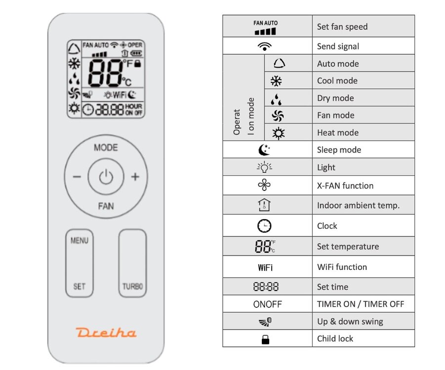

jd1923 Posted July 14, 2024 Posted July 14, 2024 3 hours ago, rideadeuce said: At that point, I would just use the separate HEAT ONLY and COOL ONLY modes. Thanks Mike, I had not run across the manual. Reading this makes more sense. Not sure when I questioned Kevin, he didn't inform me that I could use COOL vs. AUTO modes for what I asked. The fan will still run all night. My fix for that is the timer or the remote would be in arms reach, powered off when needed. Now that I have the furnace duct mod, with bedside duct capped off, I believe I would likely rarely use the heat pump which would blow warm air over the beds and not front or in the bathroom. Many voice they like the heat pump option. I'd give it a try to see but would likely prefer the warm bathroom and heat aimed on the floor vs. up in our face. For those of us who camp more often on inverter than connected to shore power, when A/C the sun is out and there is some positive AH offset. When you need heat, most of the time it's dark outside using considerable AH without solar replenishment and we carry 60 gallons of efficient LP. 1 Chris & John in Prescott, AZ | 2016 EII #113 | '01 Ram 2500 Cummins!
