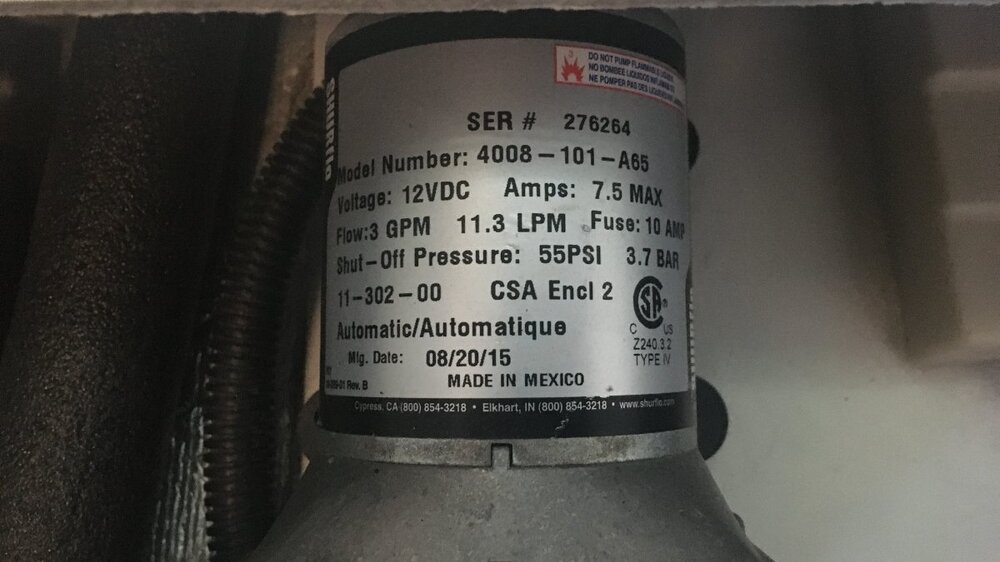

Either way, I would replace your water pump, knowing this is likely to reoccur. I also suggest replacing with an upgraded model over the OEM pump. You can add 5 PSI with no ill effect on the plumbing and go +1 GPM for much improved performance. Water pumps are relatively cheap and an easy swap.

I'm not well versed on RV water pump internals. Thinking that if the pump needs rebuilding though it would run on, for not building up pressure and/or produce less GPM. There is a set pressure for these pumps to kick-in. If pressure is regulated by the diaphragm, then this kit could do it. But I'm thinking there is an independent pressure sensor that a pump rebuild would not correct.
@Steph and Dud B's pump motor twice did not activate when it dropped well below pressure. I replaced my working OEM just to improve performance. My hull is older and hopefully a 2022 hull would have a better OEM pump than this.
