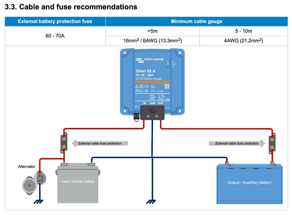

The user manual for the Victron 50A DC-DC charger states the fuse should be 60A or 70A. What do you suggest, or what did you install? 60A would be better protection but would not want to blow a fuse during a short surge. I want to go with ANL or other fuse type and not a circuit breaker.

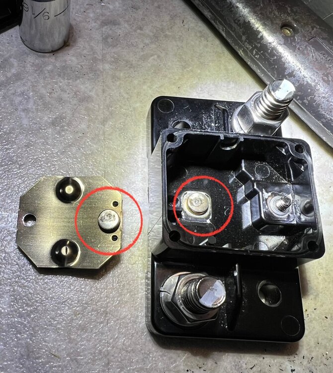

I used the following that were recommended by Artek.
1. Blue Seas MRBF Terminal Fuse Block and a MRBF 60 amp Fuse.
2. Blue Seas Series 187 Surface Mount Thermal Circuit Breaker 60 amp.
I have attached photos.

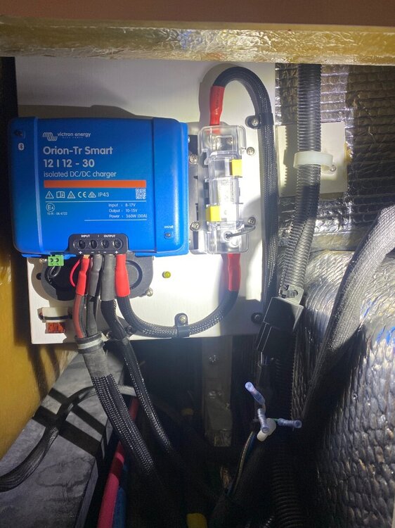

10 hours ago, Snackchaser said:
I also used a Blue Seas MRBF 60 amp fuse, and I added a redundant 60 amp breaker just as a disconnect switch.
That's a really clean installation, great work!  One word of caution though is that  manual disconnecting / connecting with an active load applied can cause contact pitting and heating of the contacts in breakers of this type.  A heavy duty marine spec. switch with larger contact areas would also fit the bill since the circuit breaker is redundant in this application.

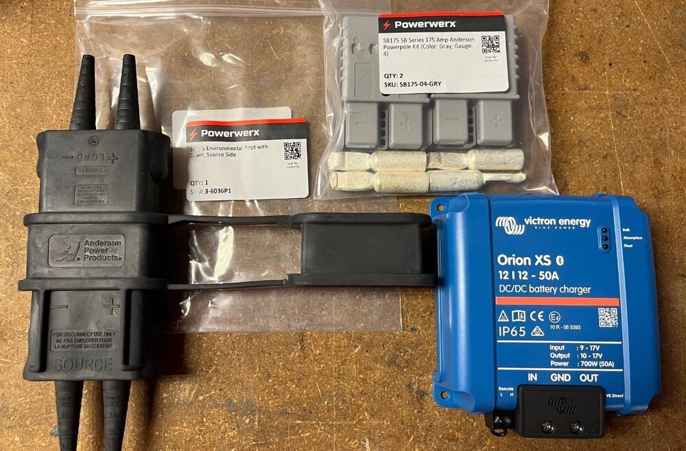

Edited by jd1923
Added picture

The Victron Orion installation requires circuit protection from both sides of the system.  One at the TV battery and another at the load side of the connection.  JD prefers two fuses and that works great for him.  I am in the Circuit Breaker camp on the TV side and a fuse like JD suggests on the Ollie end of those 4 AWG's.
Of the two, I think the load end is the most important.  Reason is that if you have a direct short our Litho's easily generate more than 3X the power that the TV battery can.
The fuse sizing criterion includes:  Amps, Volts, and Potential Power.  Sure we could put a small fuse with a small 10 Ga wire on it.  But if short circuited, it would be blown away and certainly not contain the potential energy generated by the 1800 amps or more that three Battleborns can generate.  I would not want to even guess what those twin 360 AH Litho installs could put out but would bet they can melt 4/0 cables in two seconds.  Hence using quality fuses as JD suggested or a quality circuit breaker and fuse.

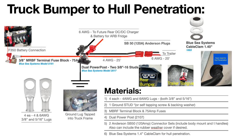

Makes me think about heavier cables. Go from 4 to 2 AWG, add $55 on my frame grounded 65 run. Make it 1/0, why not add another $135 for $230 plus tax. Need near 100 ft battery to battery 1/0
For my F-150 short box I wagged the distance at 80 feet.  to that I would of course add 10%.
But using a 100 foot long non-metallic measuring tape (Overkill for sure for this task), I actually measured three different paths for the 12/12-30.  There is more stuff under there to weave through than I had considered.  As a result I ordered out 110 feet of #4 AWG.  I had two feet spare.  I encourage owners to ACTUALLY MEASURE the path you intend on using and having at least 4' spare at the TV spare tire area for future reconnects.
