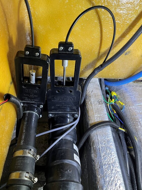

jd1923 Posted February 11, 2025 Posted February 11, 2025 (edited) On 2/9/2025 at 9:44 AM, Mike and Carol said: I will just add my experience with the long black tank cable. It is very easy to lube. Loosen the set screw on top of the black tank valve and the cable easily pulls out. Wipe down with your preferred lube/grease and it goes back in as easy as it came out. Tighten down the set screw and you’re done. I’ve done this 3 times over the years since 2016. A shorter cable run would probably be better and an electric valve better as well, but the current set up has been fine considering how many times we’ve dumped! Mike @Galileo I'm starting to feel your pain here! I worked on the long cable going to the black tank waste valve. I tried to merely grease the two ends on the slide pistons with no improvement. Then I tried Mikes method. You need an 1/8" Allen key. The cable came out cleaner than I expected. I cleaned the cable with rubbing alcohol and then greased it as inserting with a silicone-based grease. It got stuck at the end, so I freed the cable clamp (two Phillips screws) from the valve and then it pushed through easily. It's maybe a little smoother, but... When I had the cable out it had two bends in it from the forced turns in installation. One in the middle of the length and a tighter radius bend at the waste valve end. Grease cannot help much with these acute bends. I tried working them out by hand with minor improvement. etrailer wants $50 for the 144" cable alone with mid-March delivery! I still have no idea which way I will go. At least I have time, as they are difficult but still functional. This installation is crude (see pic). Besides the hard angles in the 12 ft cable, the two valves are on top of each other, angled towards each other and rubbing. They also could have mounted the 3" valve on a 45 degree angle so that the cable did not have to turn a full 180! And all they had to do was to install the 1 1/2" gray valve further forward. It's also rubbing hard on the fiberglass wall. To install electric valves on either of these, I would have to move the gray valve and replace the black pipe, from the rubber joint to the gray tank. Val, on your newer hull OTT must have done better work or something was different for you to have the room to simply install the motorized valve. BTW, nobody should really worry about adding extra splices, though I have removed many of them in our hull. Another thing you can see in the pic is all the crimped butt connectors and they were used all over the basement! More reliable than a 3M Skotchlok which should only be used by backyard mechanics adding aftermarket accessories, never in a factory installation. I hadn't noticed any of this until I got into it! More to come, sooner or later... Edited February 11, 2025 by jd1923 3 Chris & John in Prescott, AZ | 2016 EII #113 | '01 Ram 2500 Cummins!
Moderators Mike and Carol Posted February 11, 2025 Moderators Posted February 11, 2025 8 hours ago, jd1923 said: When I had the cable out it had two bends in it from the forced turns in installation. One in the middle of the length and a tighter radius bend at the waste valve end. Grease cannot help much with these acute bends. I tried working them out by hand with minor improvement. etrailer wants $50 for the 144" cable alone with mid-March delivery! My valve installation looks very different than yours. Bends in the cable will definitely cause binding. My cable was straight with no bends at all. Interesting because our hull numbers are so close. Mike 1 1 Texas Hill Country | 2016 Elite II #135 | 2020 Ram 2500 6.7L Cummins
jd1923 Posted February 11, 2025 Posted February 11, 2025 3 hours ago, Mike and Carol said: My valve installation looks very different than yours. Bends in the cable will definitely cause binding. My cable was straight with no bends at all. Interesting because our hull numbers are so close. Mike Thanks Mike, you would think ours would be about the same. Our hull was titled in 2016 but I've seen several parts in the basement with 2015 dates. Yours is 22 hulls later which in that day could have been almost a year later. @ScubaRx Steve has mentioned how each was a one-off build back in the old days. You can see in my picture the extreme 180 turn. My SS cable has a bend there to match and another one for some other reason at the midpoint of the cable. Next I'll pull the gray valve cable to the bathroom to see if it's straight. This short cable is equally hard to pull. Later I'm going to see if I can access the gray waste valve, under my Victron inverter, under the streetside bed and then come up with an overall plan. I've always really disliked plumbing! New cables, new valves, motorized... ? 1 Chris & John in Prescott, AZ | 2016 EII #113 | '01 Ram 2500 Cummins!

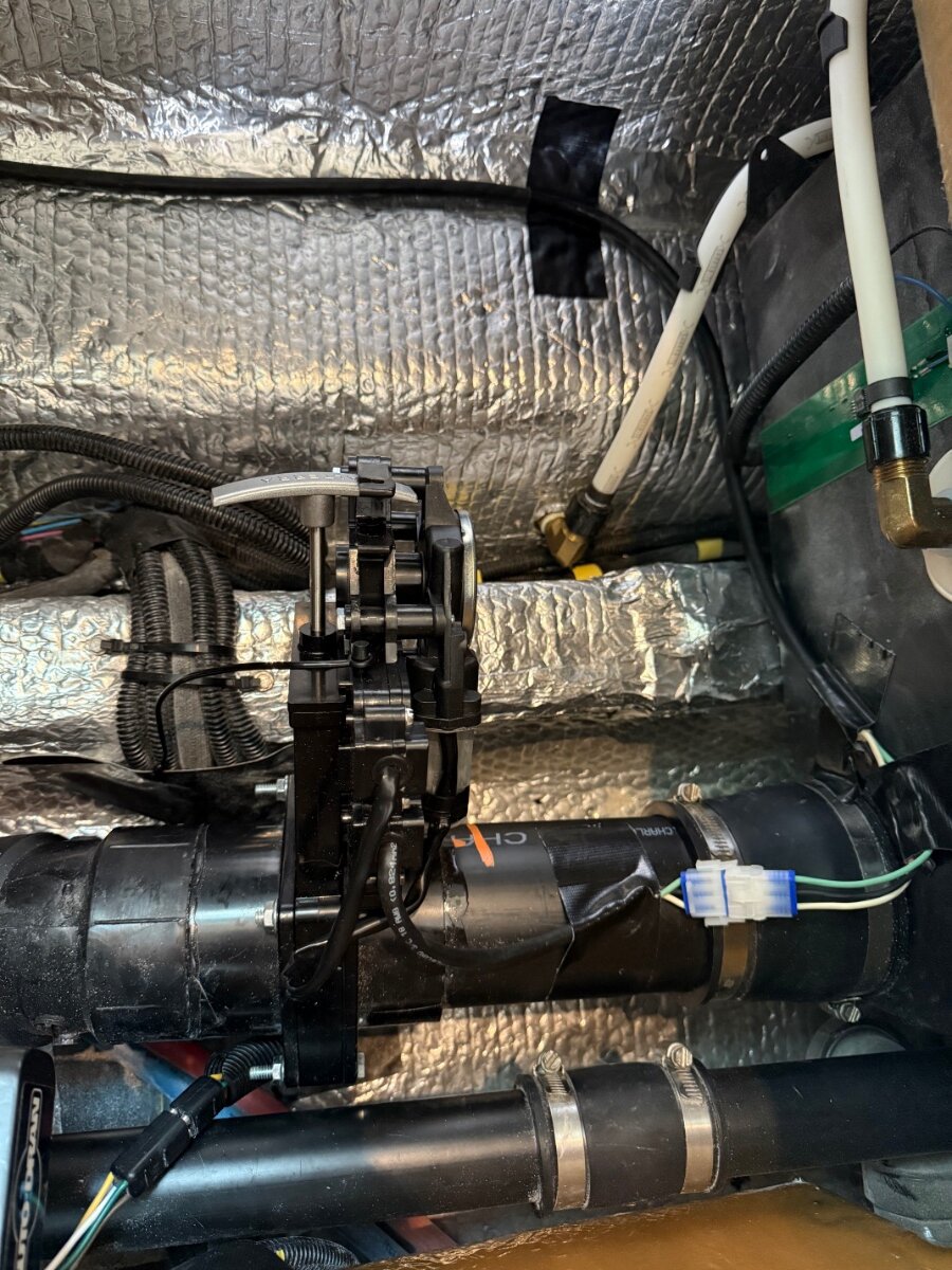

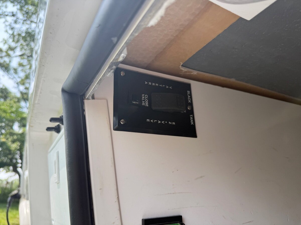

Galileo Posted June 3, 2025 Author Posted June 3, 2025 Finally finished! I admit to being quite lazy and uninspired - and yes - busy traveling and not in one spot long enough to get to it. But, the rest of the Valterra electric black tank dump valve installation is complete! The 18-3 wiring harness that came with the valve was far too short. Since I was going with a longer run, I upgraded to 16-3. I used the existing manual valve cable to pull the electric cable through. It was certainly easier than if I had to pull a harness with terminals on both ends. Only snag (literally) was where the original cable was taped to the insulation. I had to duplicate the control end of the cable. Basically 5 crimp-on 1/4” female disconnects and two jumpers. The valve end of the harness has a special connector which I couldn’t find the terminals or removal tool for - do I just butt-spliced it onto the end of my harness. Not my preference, but it was either that or cut out the connectors entirely and just butt-splice the harness right onto the valve. Six of one, half a dozen of the other. First picture shows where I installed the control. I contemplated putting it where the manual pull handle was - but it’s a tight fit, and I’d have to scrap the switch plate and open/closed legend. That, and it looked much easier to make the cutout in the place I put it than the manual dump handle location. I’m not super thrilled with this location - and having visions of it being actuated by accident - by an elbow or something I toss back there. (I don't wanna go full Dave Matthews on anybody!) I debated adding another switch, but for now, I can always swing the valve handle out of engagement with the actuator until I’m ready to dump. The “board” here - between the basement area and the location of the outdoor shower and other goodies is easily cut with a spade bit and a utility knife. Second picture shows the valve in position. Pretty straightforward. The electric physical valve swaps out with the manual one. Route your wires, use OTT official black gorilla tape to hold cable in place. Snap the connectors together and - Bob’s your uncle. 2 2022 Oliver Legacy Elite II Hull #1029 King Bed Floorplan electronics package Truma Aqua-Go LOUD Dometic Penguin A/C LevelMate Pro+ Valterra Electric Black Tank Dump Valve TV - 2025 GMC Sierra 1500 Denali, 3.0l Duramax Diesel, Crew Cab 4WD RealTruck hard tonneau cover Rove R2-4K DashCams Canada: New Brunswick, Nova Scotia, Prince Edward Island
jd1923 Posted June 5, 2025 Posted June 5, 2025 On 6/3/2025 at 1:00 PM, Galileo said: Love the switch install, excellent work! 😂 1 Chris & John in Prescott, AZ | 2016 EII #113 | '01 Ram 2500 Cummins!
