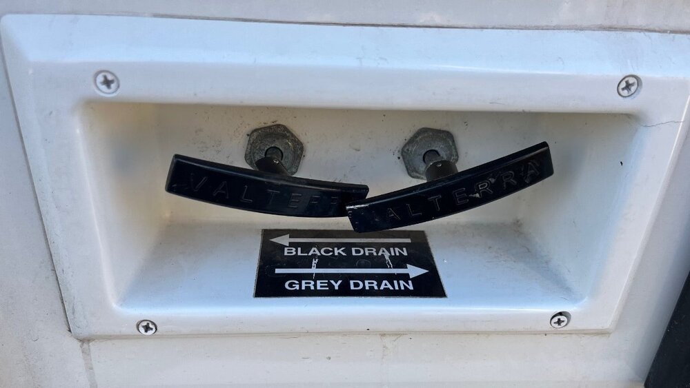

@rich.dev has the best idea, I think. Put the switches where the current handles are located. I would scrap the supplied wire harness (likely not long enough) and the supplied (awkward) switch and plate and buy 3 marine grade (waterproof) simple toggle switches, up for open and down means closed! They will fit in the holes left by the pull handles once removed.

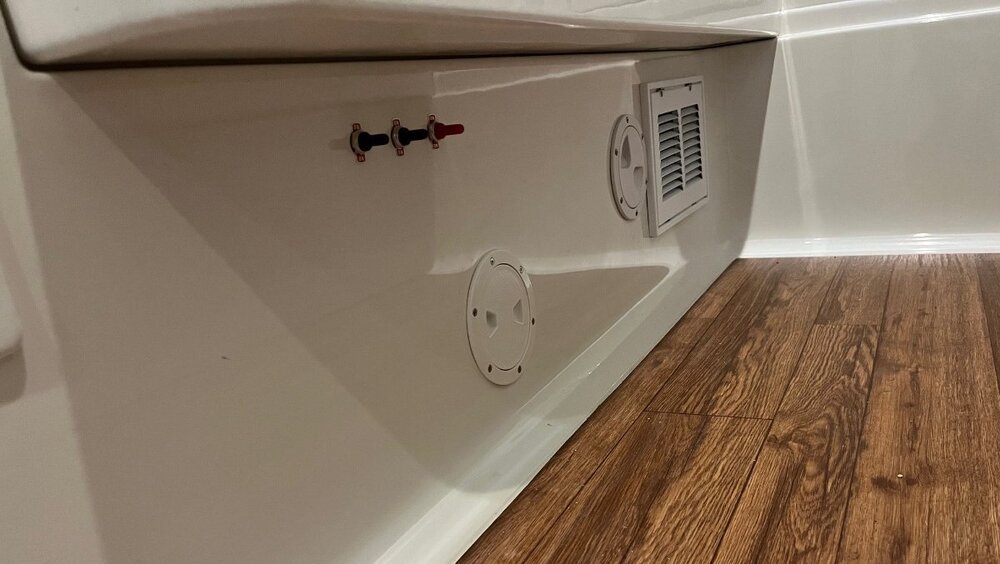

I would replace all three (3) valves, sooner or later. Really dislike the one by the toilet that keeps the gray from backing up. How many times have we forgot that and have to climb back up in the trailer. All switches together, in the same outside location makes sense to me. We always have that rear hatch open when leaving a campsite anyway. Added a couple pics, food for thought, and thanks again for this idea! 😂

@rich.dev “has the best idea, I think. Put the switches where the current handles are located. I would scrap the supplied wire harness (likely not long enough) and the supplied (awkward) switch and plate and buy 3 marine grade (waterproof) simple toggle switches, up for open and down means closed! They will fit in the holes left by the pull handles once removed.”

I would really want the switches where the pull handles are. Or you could mount those switch plates just inside the rear storage on the wall to the streetside basement, easy to runs wires to get there.
Waterproof DPDT switches are common in toggle switches. I purchased these to run my motorized ball valves to replace the manual fresh water valves:

It certainly should be! The rear side of the waste valve pull handles is the basement under the streetside bed. The better quality switch was already mentioned and you could cut a simple cover plate to fit the recessed area with a rubber seal to cover the switches.

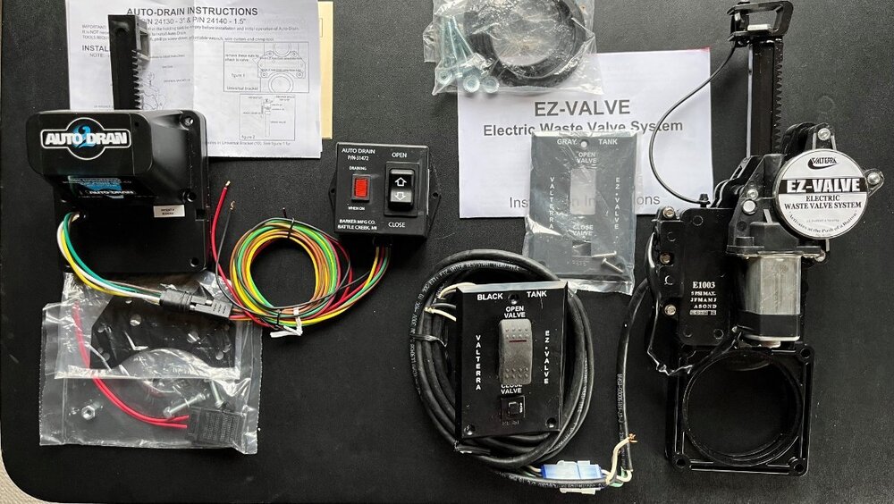

I did buy the Barker product and then there was an Amazon "like new" Valterra valve so I thought I would get both to compare and later return one of them.
I believe you did good on the Valterra. Made in Mexico vs. USA but I like how it's an integrated unit. The motor is heavier and feels stronger running. Included is the valve and seals, the Barker kit contains motor, bracket and switch only and you may need a new valve to mount the Barker easily (handle vs. cable pull). The Valterra has the better wire harness and switch with both black/gray faceplates. At least you can recess the switch (cut large holes), both switches are too big! Not fond of the fuse in the faceplate, prefer the separate fuse wired at the bus. I powered both up and they are in the raised position as pictured.

Turns out the Barker can be set at any height. You can ease it open which can be helpful when letting gray go in the BLM or NF lands (yes, it is legal when at a distance from others and water sources). Of course, when dropping the black tank into a sewer/septic system you would rather release all waste quickly, valve full open.
Not the Valterra valve which is either all the way up or down. It must be due to the switch which could be replaced with another DPDT switch (pictured). The odd little breaker or reset button is odd. I would delete it adding a simple butt connector on the white wires in and out and wire a 5A fuse at the + bus. Without the faceplate this switch could be mounted where the pull handles are located, but I cannot determine if this switch is waterproof (unlikely).
Barker has a 1 1/2" valve model and I have not been able to find one in the Valterra brand. I want to motorize all 3 valves, especially the 1 1/2" valve which gates the gray water from the bathroom. It will be great to merely push a button and remove the pull handle from the bathroom! I will do this work Feb-Mar, weather and time depending.

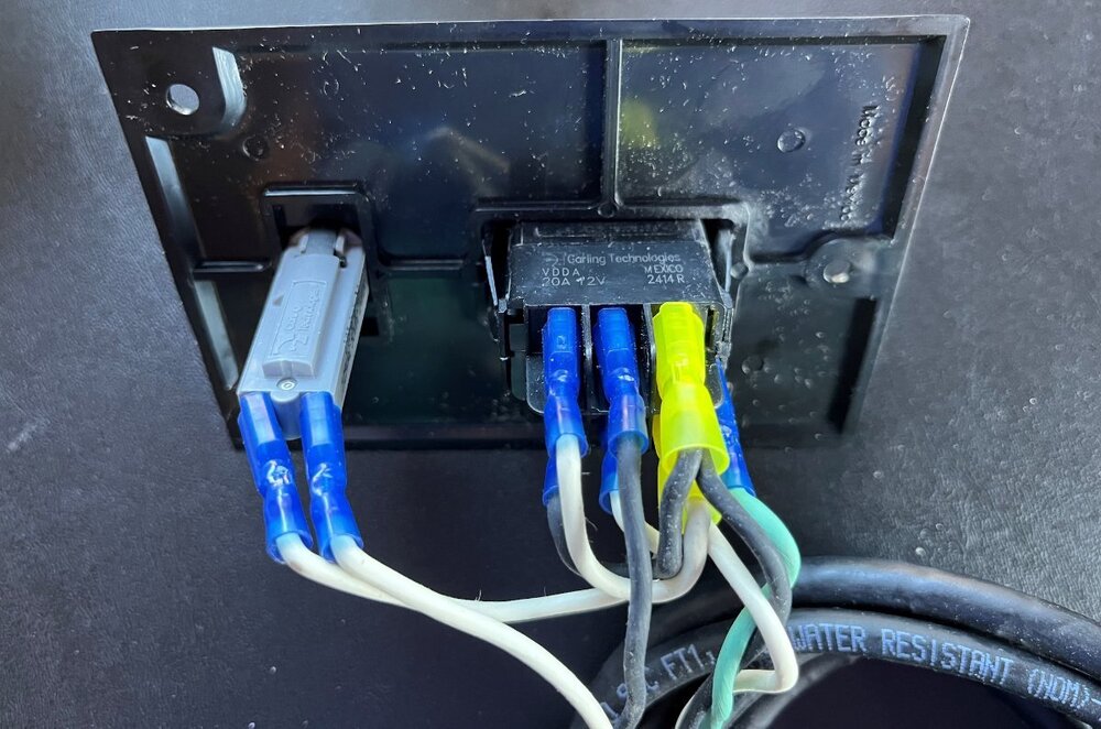

I concur with JD on the Valterra being all or nothing. The description of the product mentions limit switches so you don’t have to worry about holding a momentary switch until it’s fully open or closed (like the Autovent in the closet).
There’s no “center off” position on the included DPDT rocker switch, so if you’re not opening, you’re closing or vice-versa.
Turns out the included wiring harness is only about 7 feet long, so too short to install the switch in the position of the original handle. I don’t see another good place to mount it that makes any sense. That means I get to make up a new harness as I don’t like to put splices in the middle of a cable run - especially where that might end up someplace inaccessible. I’m also going to upgrade from 18-3 cable to 16-3. Mainly because that’s all I could find at Home Depot - and because heavier wire on longer runs is just good practice.
Anyway, until I do the rest of the surgery, I’m have to duck under the forward dinette seat to actuate the valve. Already had one mishap and one near miss where I either forgot to close the valve. (Yeah, messy) or, opened the valve before I had connected the stinky slinky. The saving grace with that is IF you realize it before you take the cap off inside the rear bumper, you can lower the nose of the trailer and take the cap off without getting a shower….

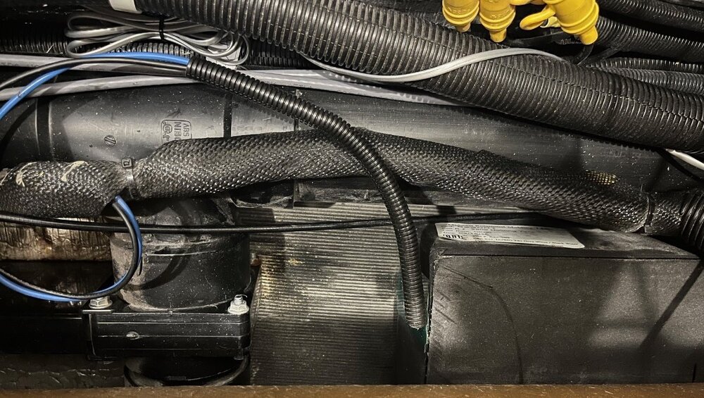

I installed our Victron MP2 Inverter/Charger directly over the gray valve! So for ANY gray tank valve repair, I would have a whole lot of extra work to do! But I would rather do preventive maintenance at home than have a stuck gray valve on the road. Both of my valve handles are difficult to pull and return. Why didn't I think of at least greasing the cable and piston earlier? Not good for me and some others.
Wondering why OTT Service does not replace these valves with the exact same part vs. going electric? I either want either two motorized valves or two new pull cables, not one of each.

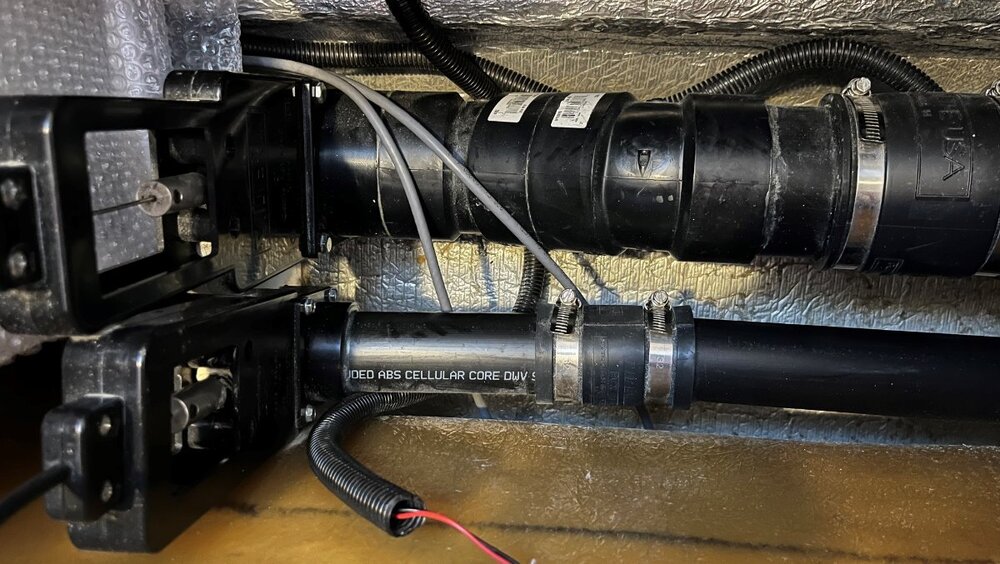

The gray tank valve was installed horizontally by Oliver (see pic, valve is bottom left and corner of gray tank is bottom right). There is ample room around it but the drain pipe is laying on the floor of the outer hull with some insulation and/or a rubber mat below it.
The motorized valve protrudes in both directions parallel to the valve. So as-is, it will not fit. There may be a way I could rig this. I will have a new seals and new manual valve on hand when I work this.
I don't like to pamper old parts, just to get a little more out of them. The original valves lasted 10 years and want something that will last another 10 years. The electric valve is the best solution since there is no cable, no maintenance. I can't pull the inverter every time the cable or valve piston needs to be greased!
