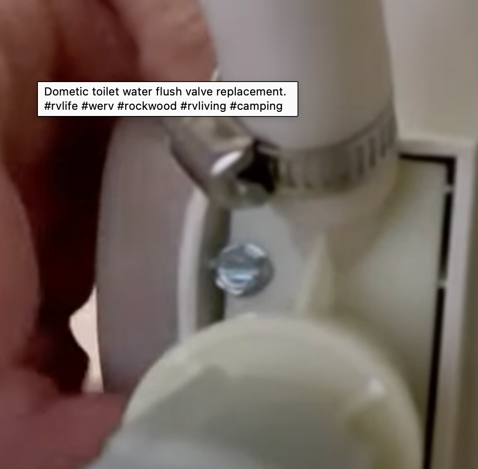

Currently on a trip.last night I discovered that the water valve is leaking . Understand I will have to replace the valve and found one in Amazon. My question is how hard is to remove the old one and replace with a new one .seems the kit includes everything I need.
thank you for any guidance or suggestions
This you tube shows the trick is getting one screw (that's very hard to see on the back) removed before trying to pop out the valve.  See the 2:12 Mark on video...easiest to use a 1/4" socket to remove screw.image.thumb.png.6f04faca70f68f59c775680184bfce3d.png]\

That said we are chasing leaks, currently, this one out of the back of a Dometic (310/311, does the model number make a difference) for the "Water Valve Kit".
The leak is coming out of the back of the "Water Valve Kit", just a slight dribble, but enough to be worrisome whilst spilling onto the shower floor.
I watched the video provided by Craig and "I can do that!!!"
I would like to remove the valve and examine it, to see if something on it is cracked or worse yet further up in the toilet.
I am going to see if it can be found locally, if not the AMZN...

I was able to remove the valve assembly and examined it.  This is before i found the following in a Dometic Manual i had

a 1/4" Nut-driver works just as good as a 1/4" socket on removing the screw from the back (refer to video).
this looks like it may be the issue, just not as bad, before i reinserted the flush valve.  so i believe we have freeze damage to our flush valve.

The Dometic "Flush Valve Kit" arrived by pony express (3 days) and I installed it late last night.
It is the proper part for our model of toilet.
However, during re-assembly when I inserted it into the back of the toilet, it did not “Click” as mentioned in the Video or Forum comments.  I pressed it in the best I could, but no “CLICK”, removed it and re-inserted the old one and “Click”…  re-inserted new one, no "CLICK".  I did however add the “second screw as was suppled”, so now I have (2) screws holding the “Flush Valve” in place.
And what is with the worm gear clamps (existing & supplied), the heads are not 1/4 or 5/16's, sheeez but I did snug them up tight.
This morning I will look for any subtle differences between the old and new Flush Valve.
And I still have a very slight drip coming out of the back of the toilet where the “Flush Valve” inserts…

By Pony Express do you mean Amazon? Are you sure it is a Dometic brand part. I'm with you in wanting to hear the 'click' like the original part. If not Dometic brand, time for another Amazon return and get the part from eTrailer, Camping World or some legit RV store.
https://www.etrailer.com/Accessories-and-Parts/Dometic/DOM93FR.html
A lot of hose clamps these days have 7mm screw heads.
issue resolved.
We bought a Genuine Dometic Water Valve, it is now installed and working as designed.
My Visited North America Map
Do not buy a "Lippert" replacement part.  Sales ppl will say it is a match, but it is not.  Tech will say put in the 2nd screw and it will stop that leak.  maybe-maybe not.
